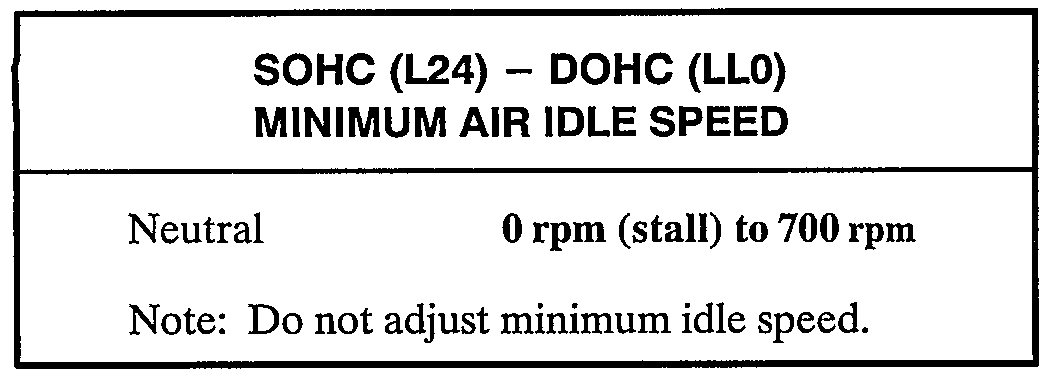

Minimum Air Idle Speed Specifications

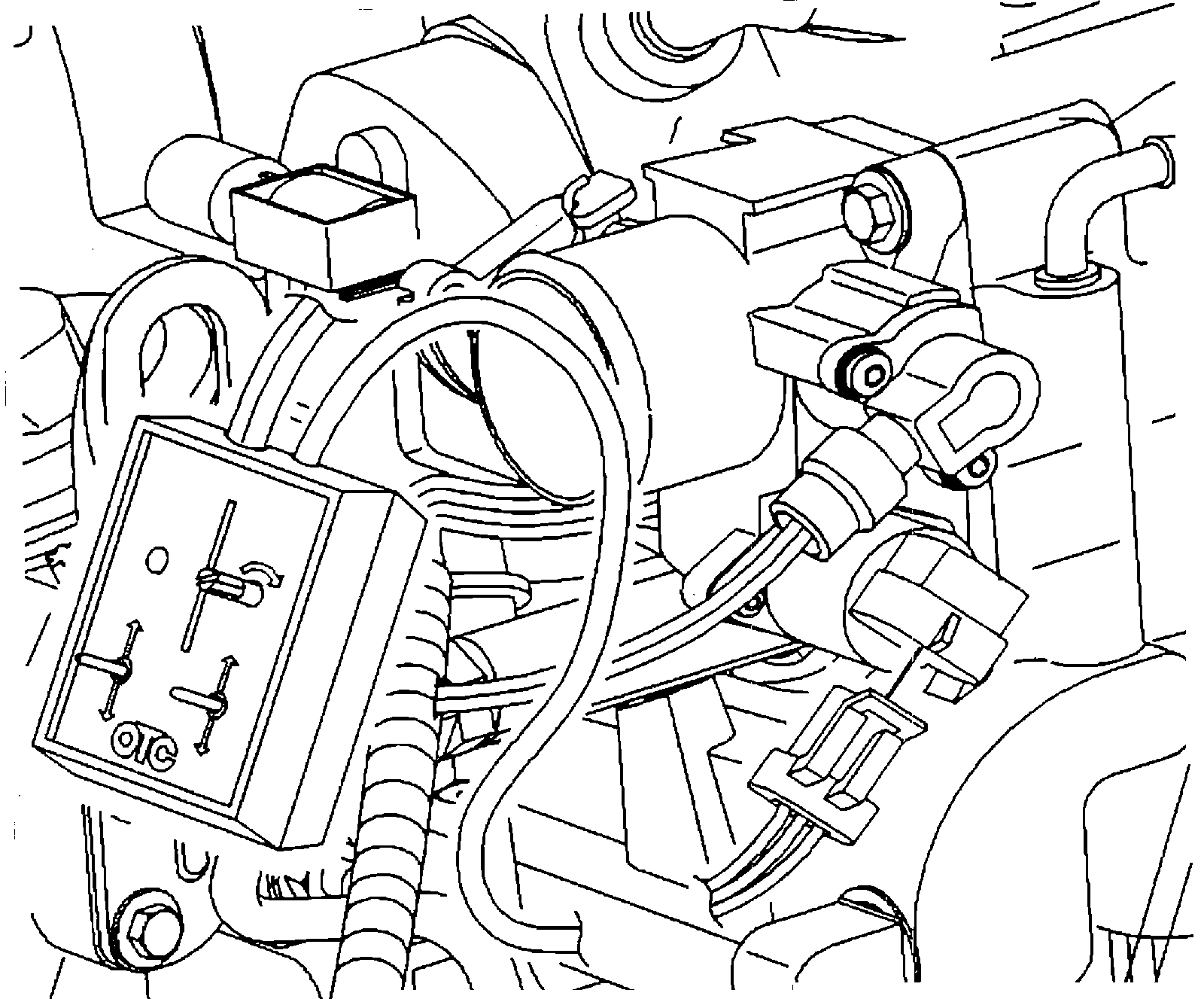

1. Block wheels and apply parking brake.
Figure 1 - Hookup Of IAC Tester. (Typical)

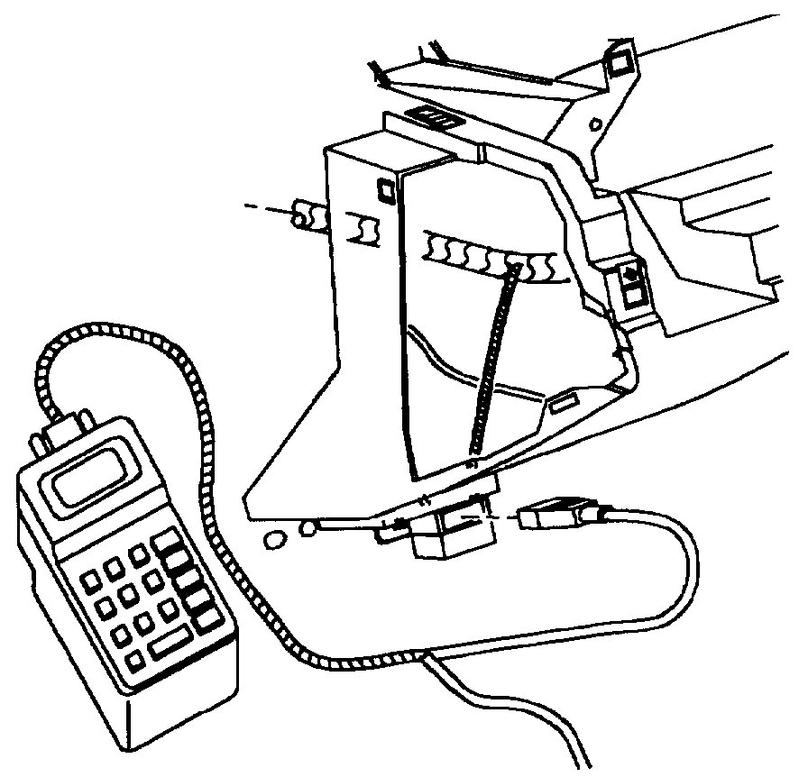

Pic 2
2. Connect the IAC tester (Saturn Tool) SA9195E, or the Scan tool unit. The IAC pintle must be seated in the throttle body.
NOTE: A/C, cooling fans and electrical loads must be off when checking idle speed.

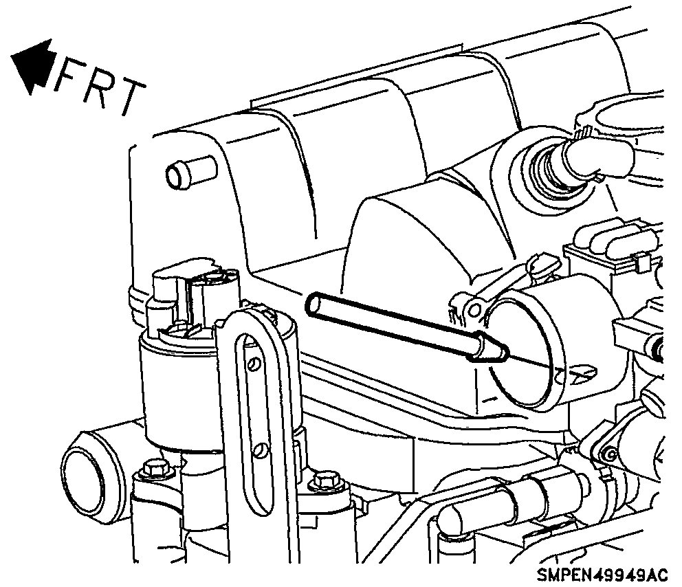

IAC air plug installed for Minimum air adjustment
Pic 3
3. Insert the IAC air plug in the throttle body.
^ (Saturn Tool) SA9106E used for SOHC (L24)/DOHC (LLO)
4. Using Scan tool unit, check idle speed. If not within specifications (0 rpm [stall] to 700 rpm):
^ Inspect throttle blade for binding. Clean bore if necessary. Replace throttle body if throttle blade continues to bind after cleaning.
^ Inspect for vacuum leaks at vacuum hoses and gasket surfaces. Correct any vacuum leaks.
NOTE: Engine must be at normal operating temperature (upper radiator hose warm). Spark adaptive cells must be at "0."
5. If the minimum idle speed is above 700 rpm after performing the required repairs, replace the throttle body. Do not adjust minimum idle.
pic 4
6. Using Scan tool unit, check voltage on TP sensor. Do not replace the sensor unless setting is outside of 0.35-0.70 volt limit.
