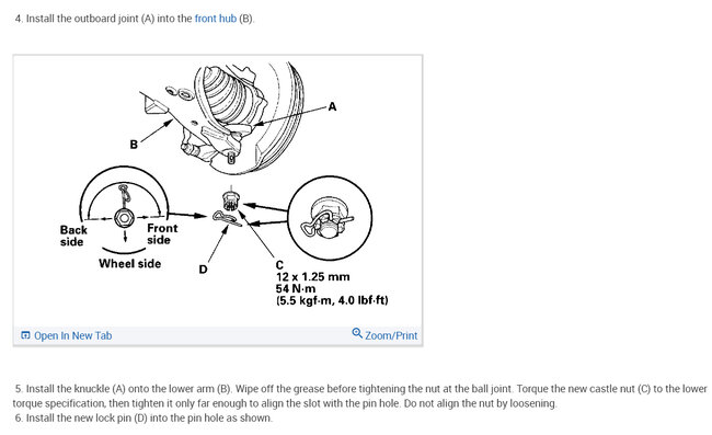

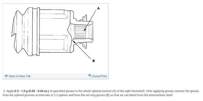

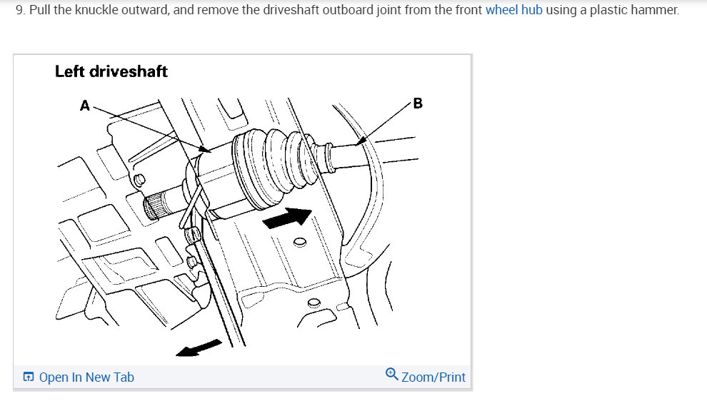

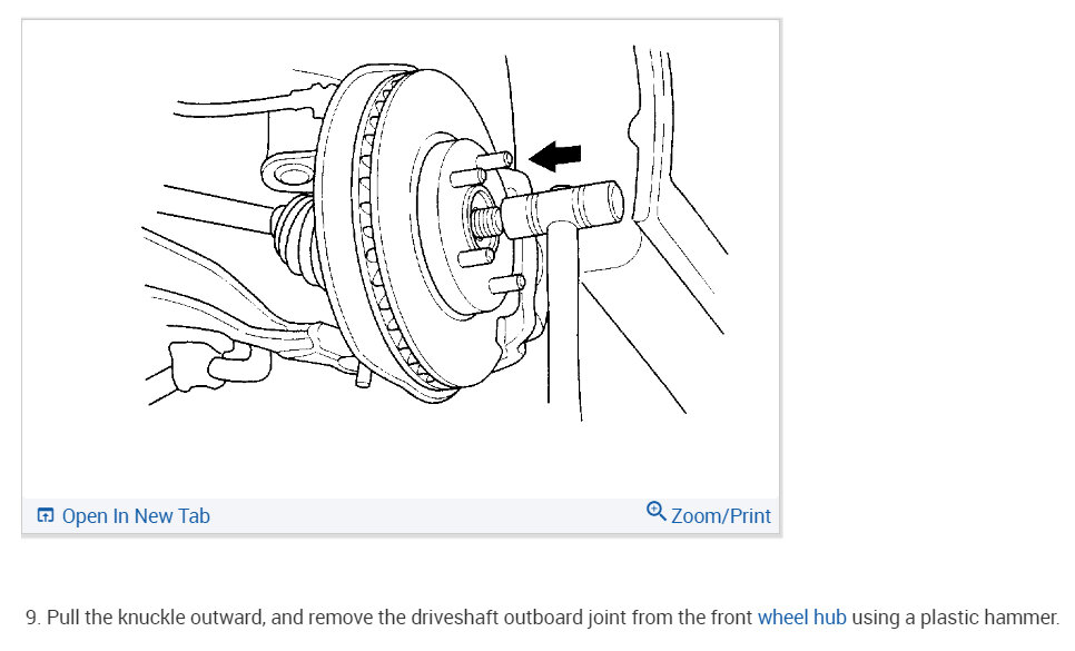

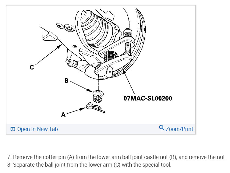

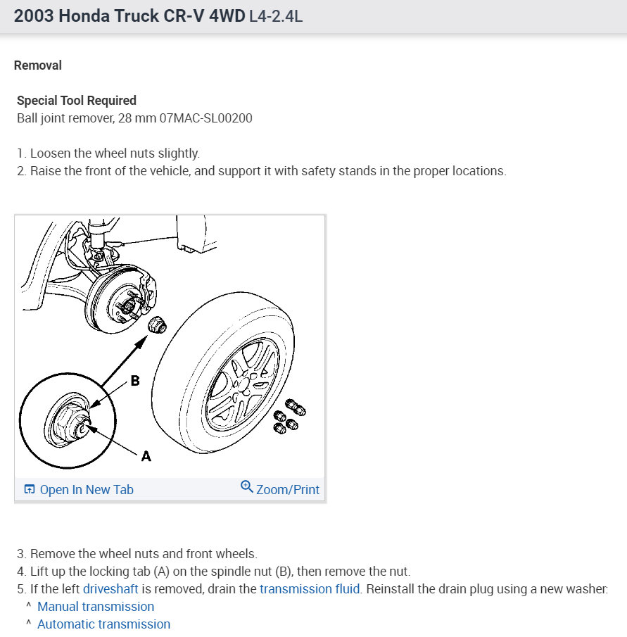

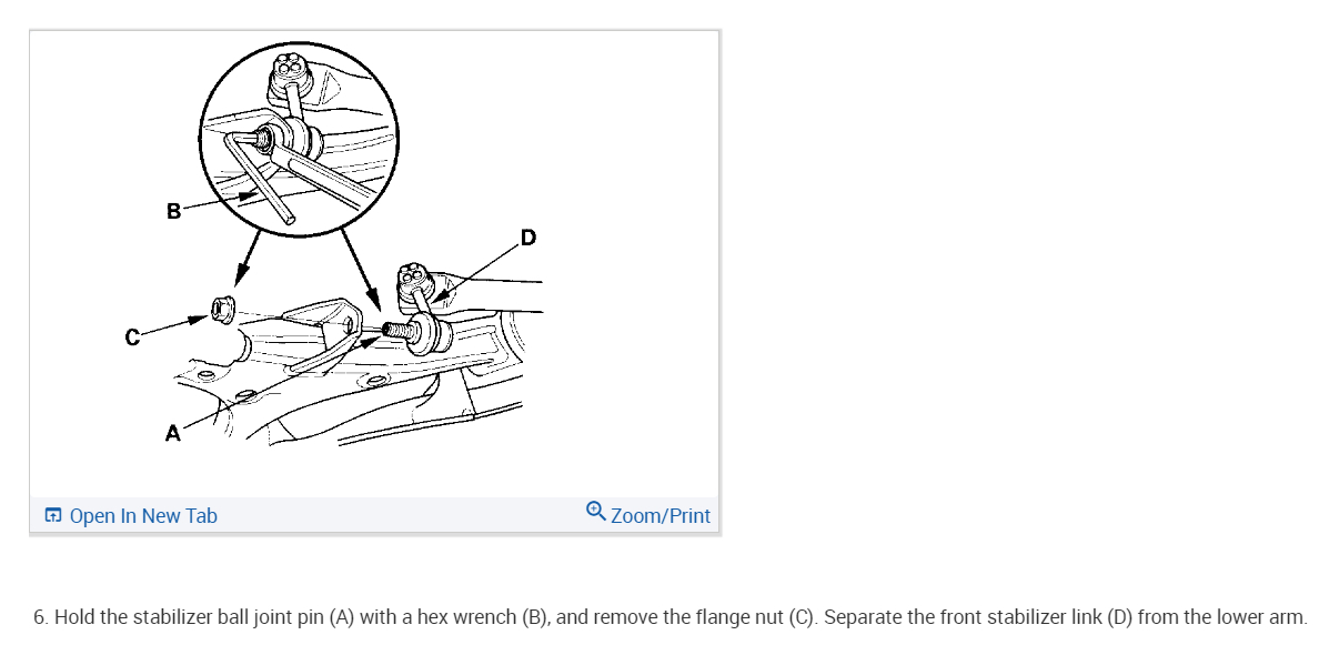

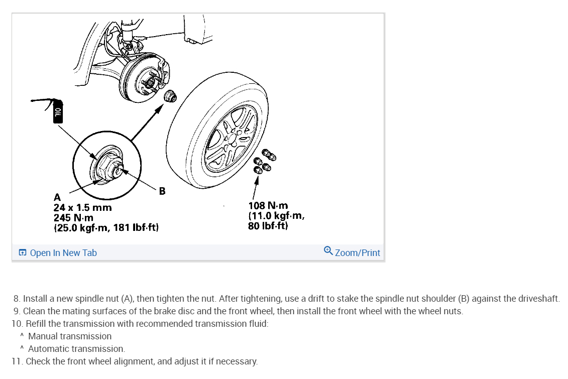

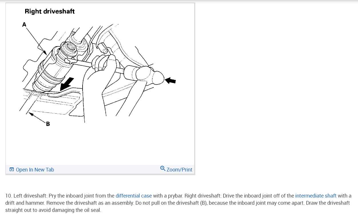

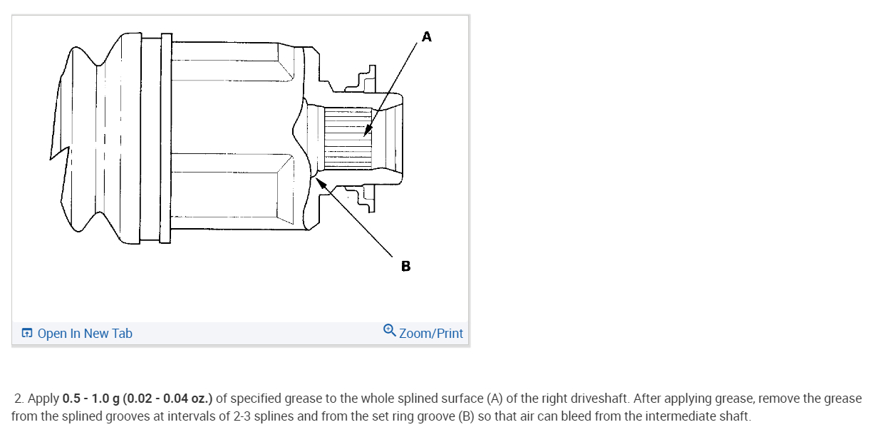

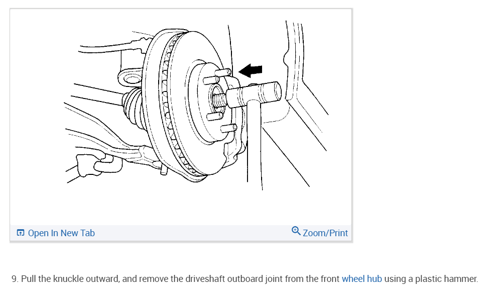

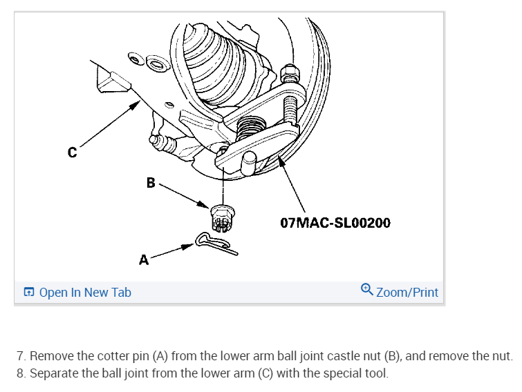

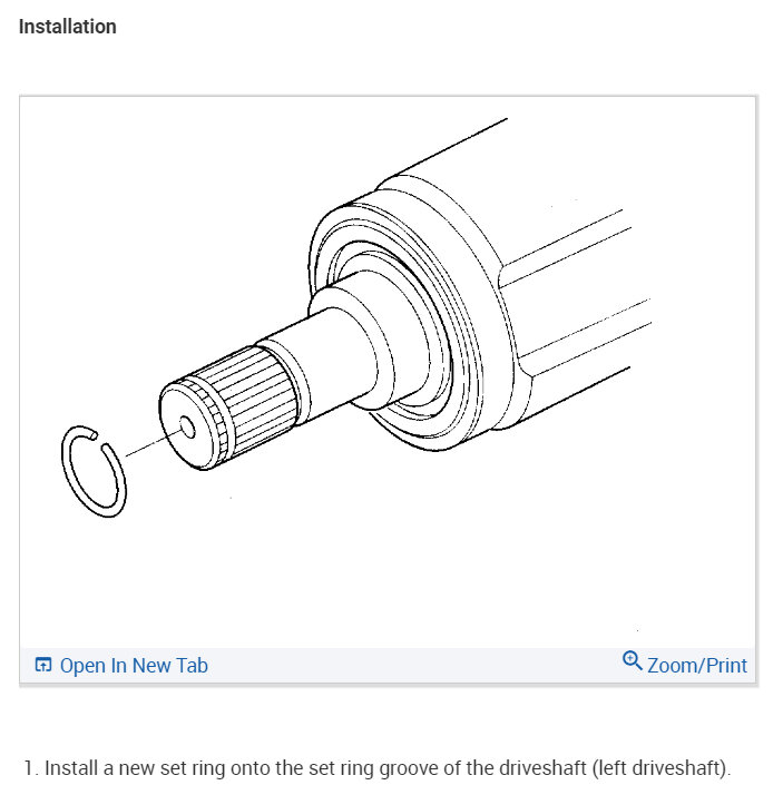

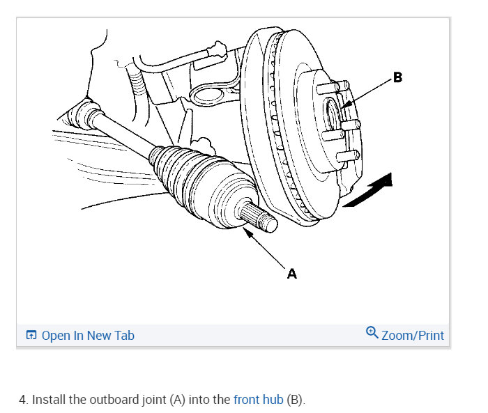

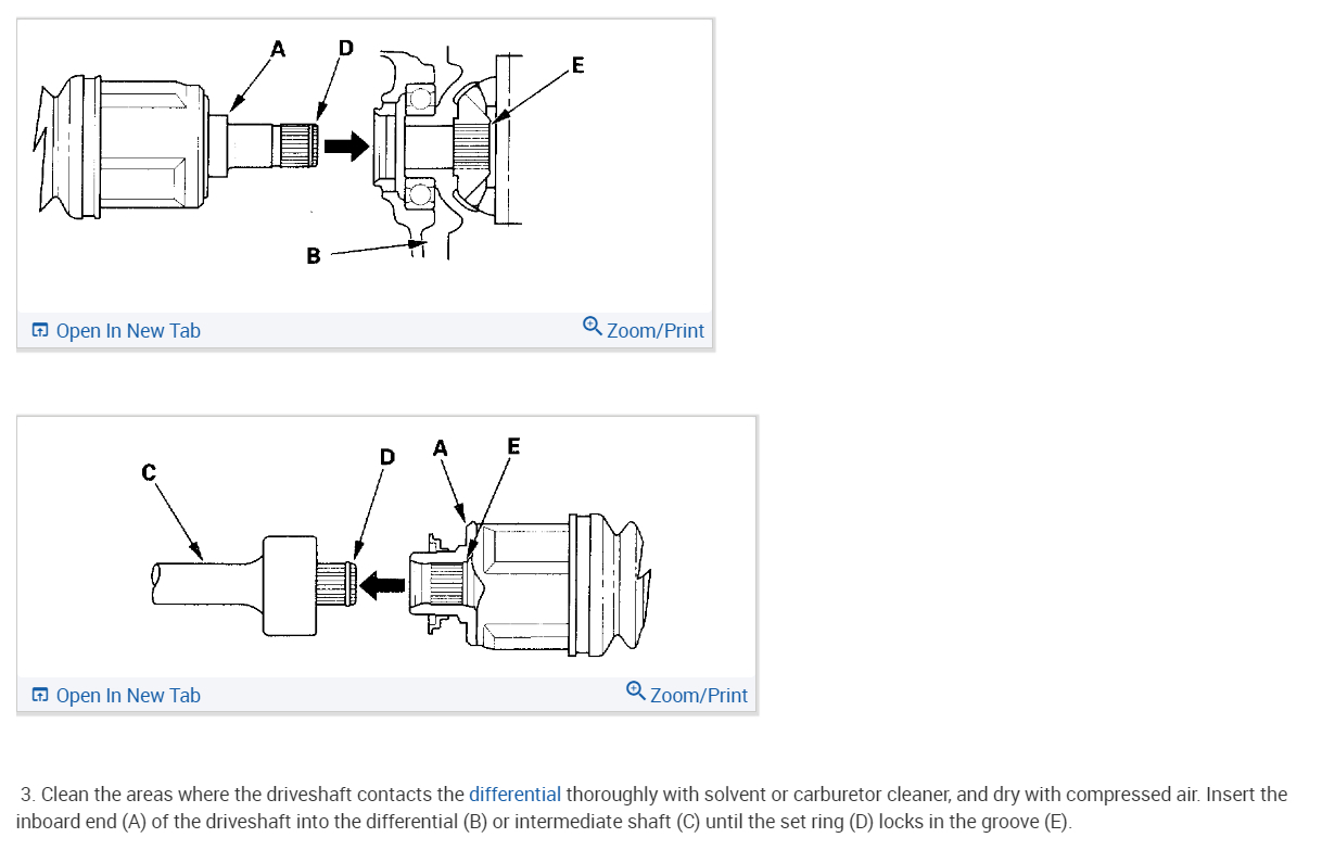

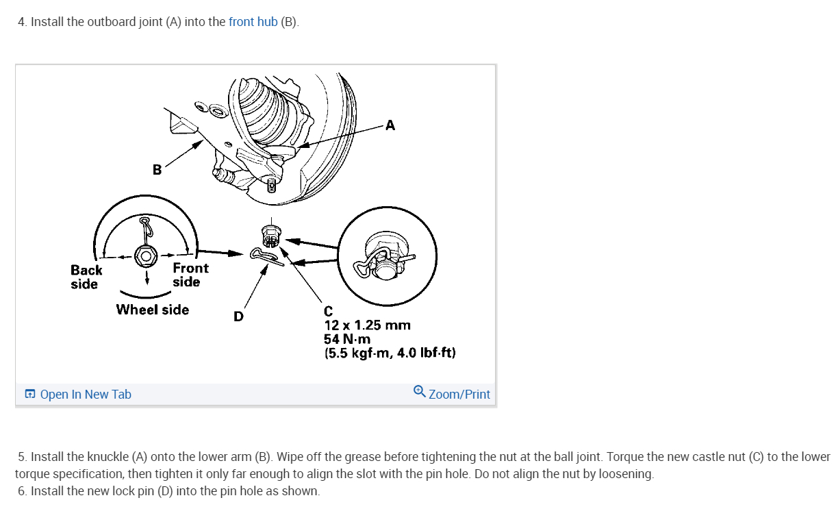

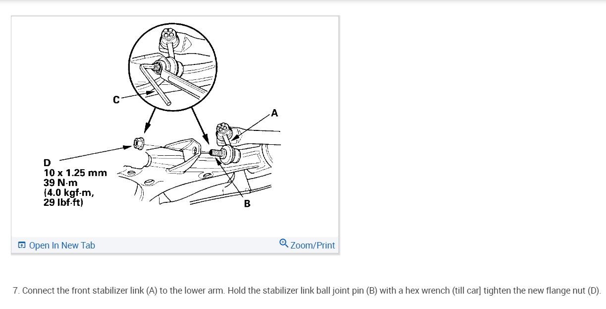

Yes, worn CV axles will cause this problem and with the boot torn the grease has run out which makes the situation worse. Also, cheap CV axles can cause this problem as well, I would go with new units when doing a replacement. Here is a generic guide to help you step by step with instructions in the diagrams below to show you how on your car.
https://www.2carpros.com/articles/replace-cv-axle
You can check the movement of the CV joint once it has been removed to confirm the failure. Check out the images (below). Let us know what happens and please upload pictures or videos of the problem so we can see what's going on.

What if I raise the left side high? Can I avoid losing the transmission fluid?

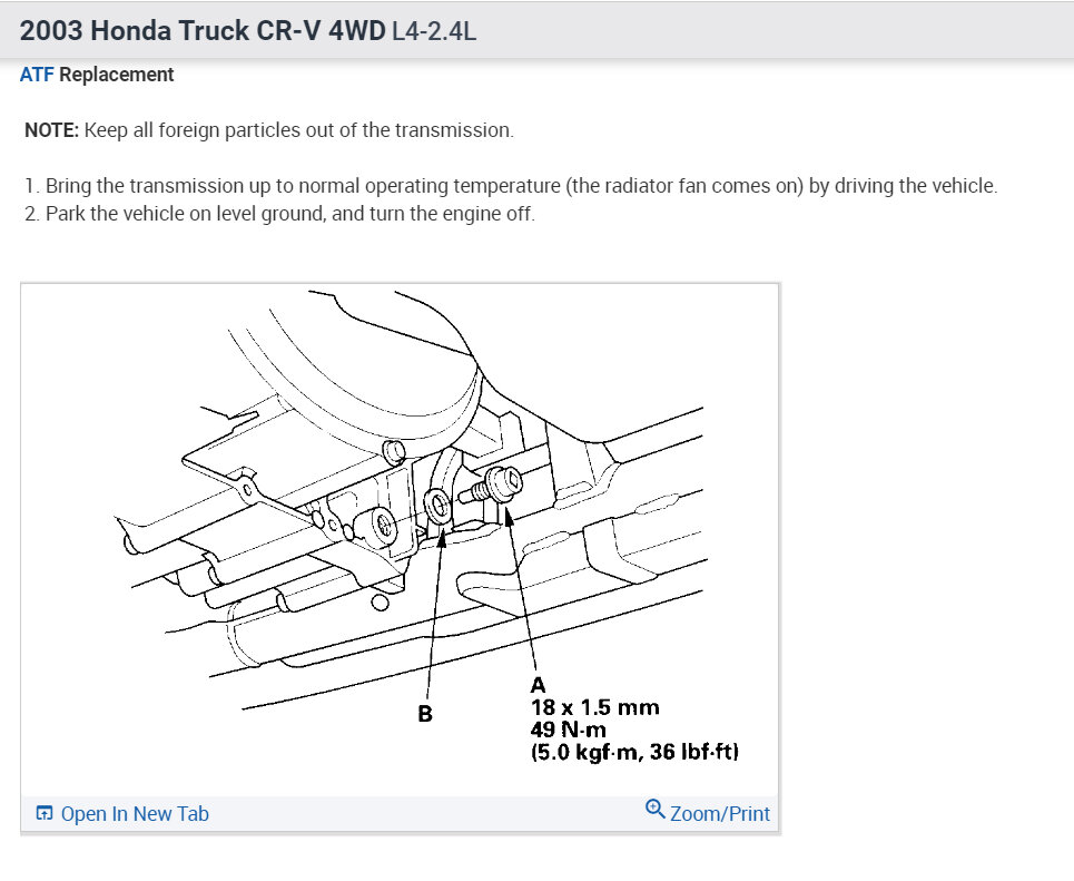

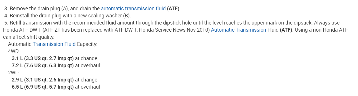

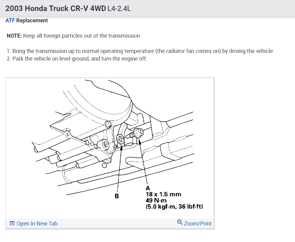

Yep, it sounds like you need a transmission service.
Fluid Types
ATF (Automatic Transmission Fluid) .................... Use Honda ATF DW-1
(ATF-Z1 has been replaced with ATF DW-1, Honda Service News Nov 2010)
Capacities
A/T Fluid
Change .................... 3.1L (3.3 Qt)
Total .................... 7.2L (7.6 Qt)
Let us know what you find with the CV axles. Check out the images (below). Please let us know what happens.
