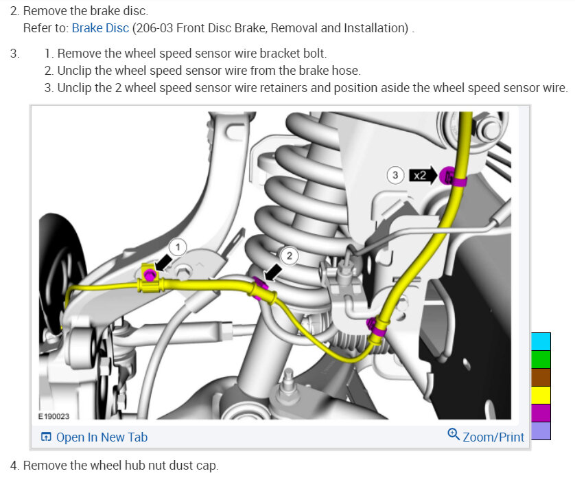

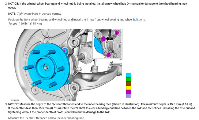

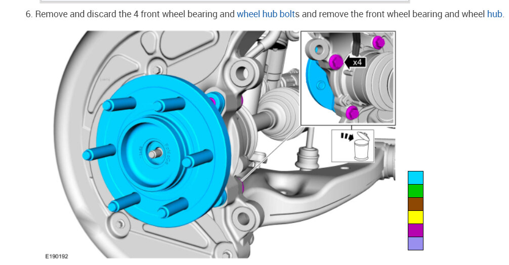

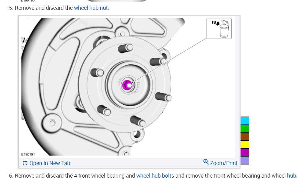

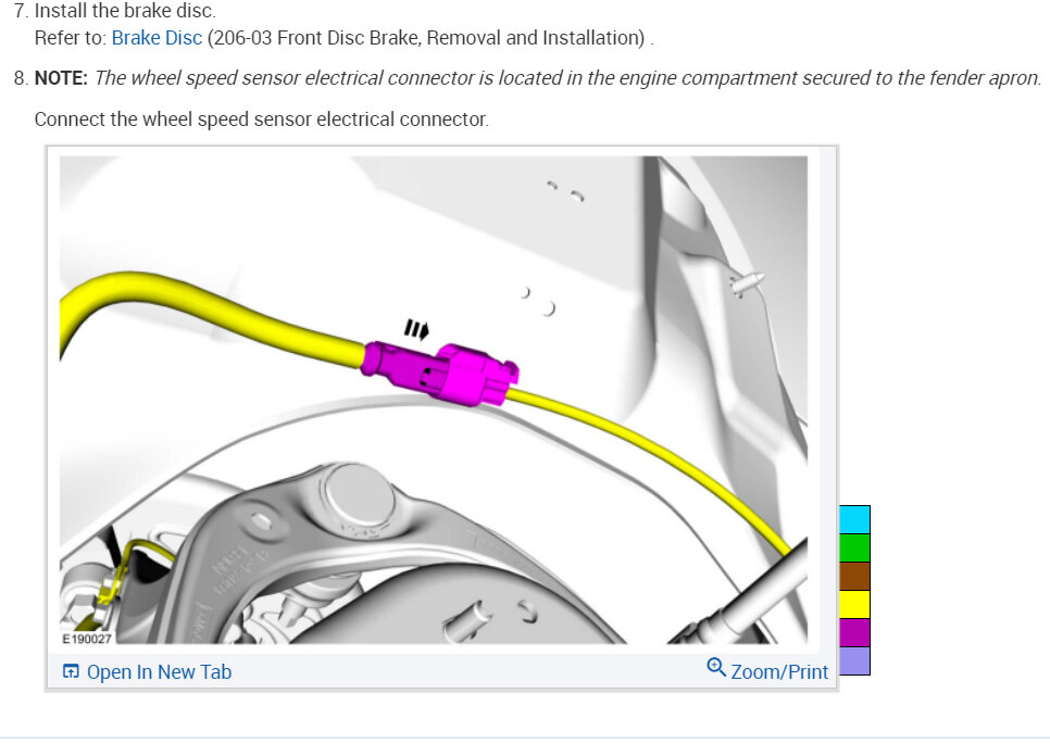

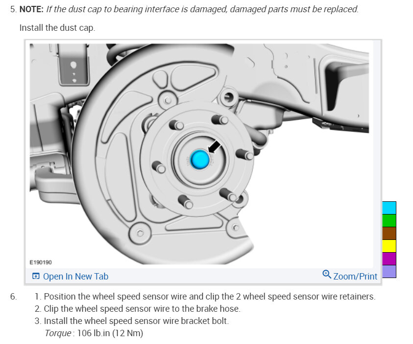

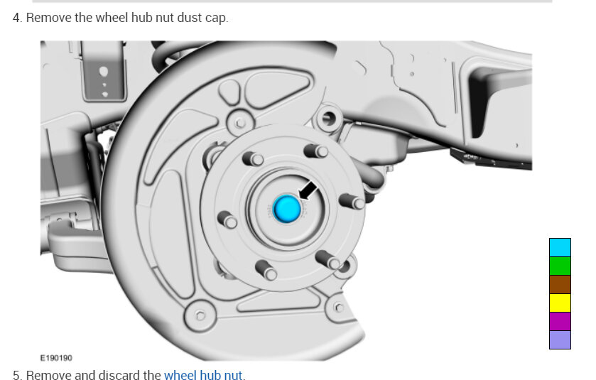

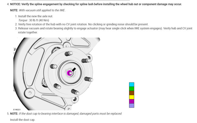

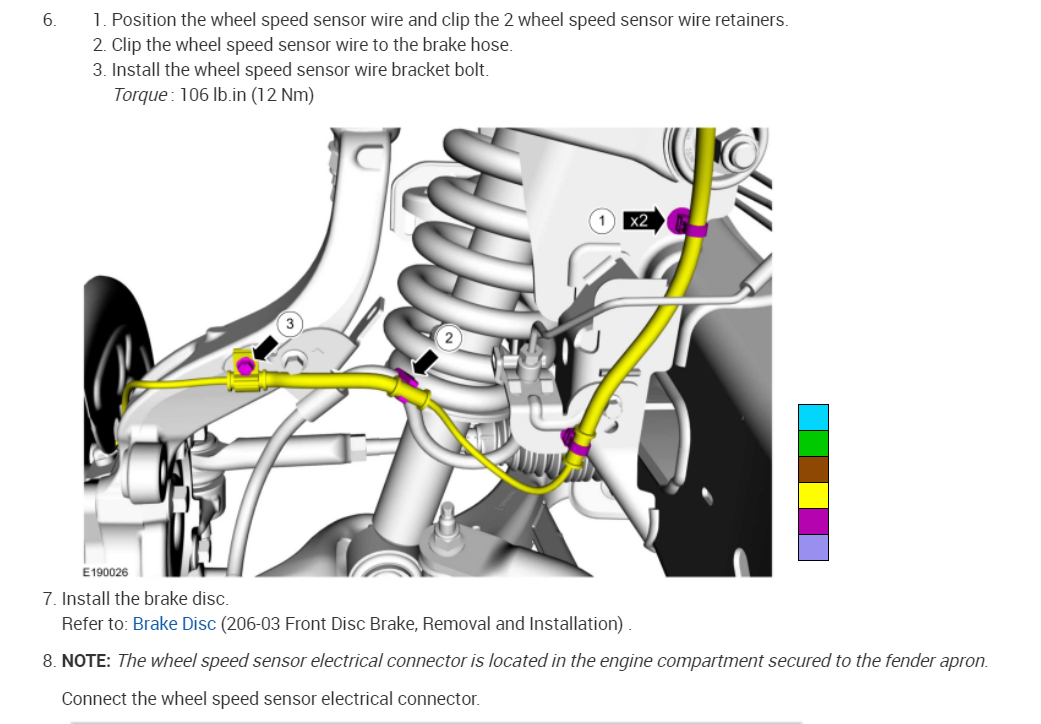

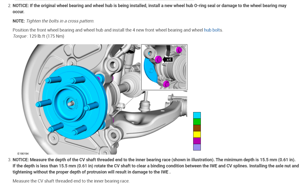

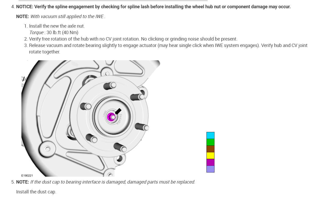

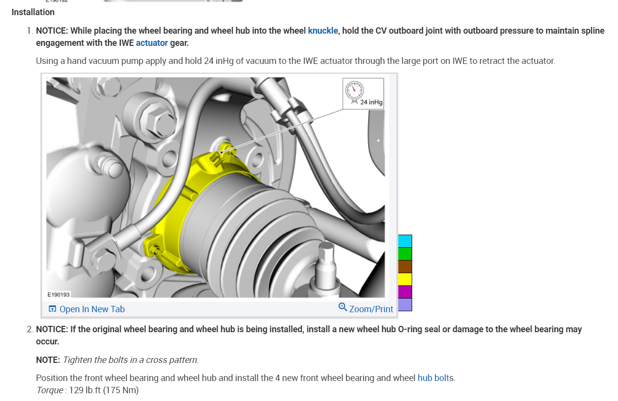

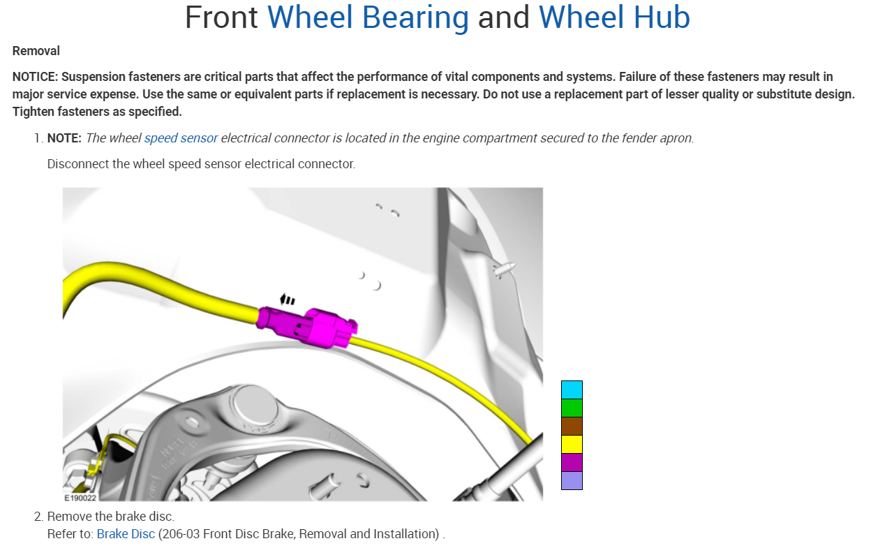

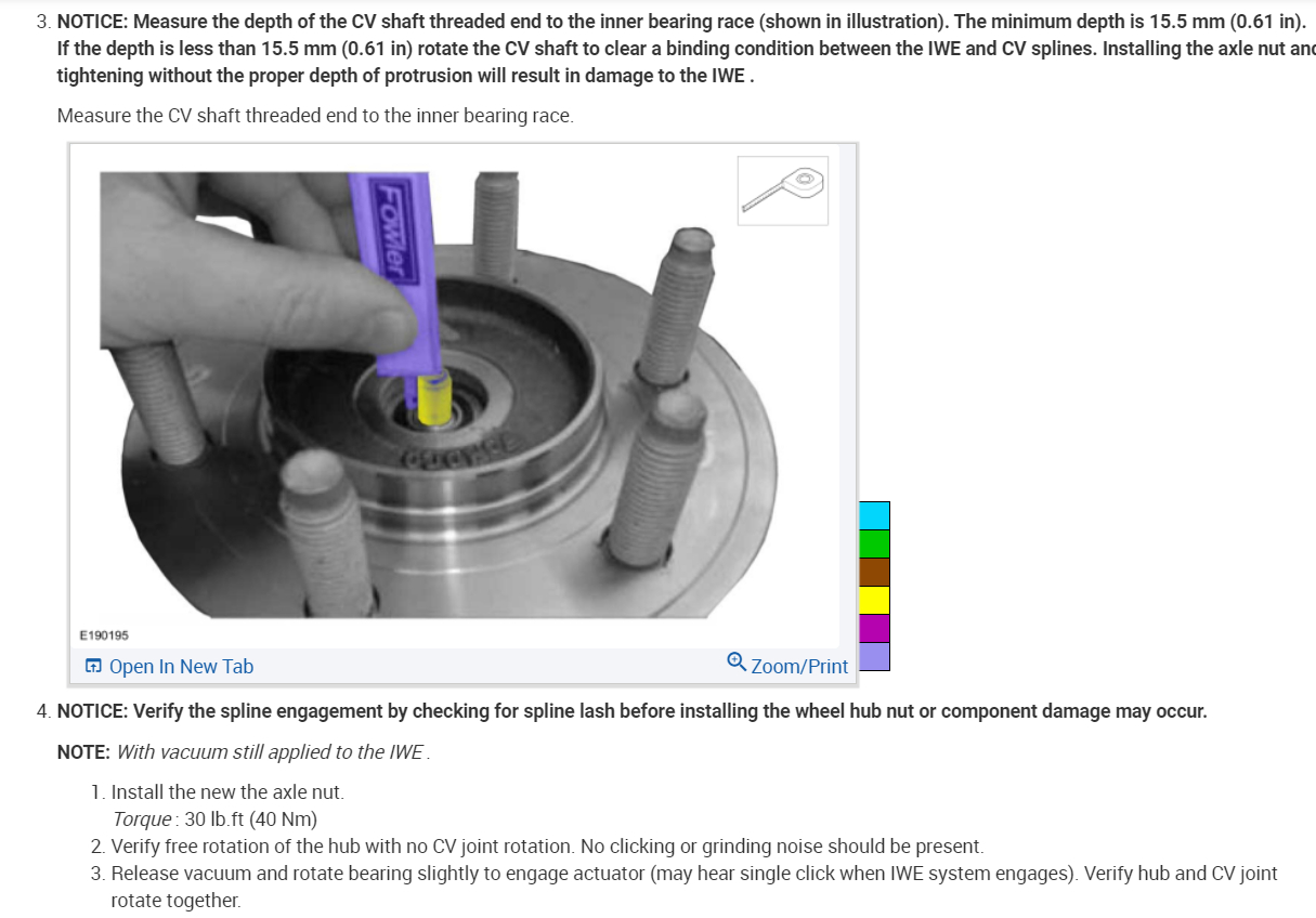

It does sound like the bearing hub is going out which doesn't make noise anytime. I would raise the front of the truck and then spin the tire to see how it does, here is how to replace the bearing hub. This video shows the job being done:
https://youtu.be/qOAyXfPo7Z0?si=laP7YFnXFXurkJMd
Check out the images (below). Please let us know how it goes.

I replaced the driver's front wheel hub. The diagrams and video were helpful. Thanks for including all of that. However, despite being the most likely cause, changing the wheel hub did not solve the problem. I figured the next most likely cause might have been the driver's front brake caliper sticking, so I bought a new one and went to replace it, but it turned out the caliper wasn't the problem either.
