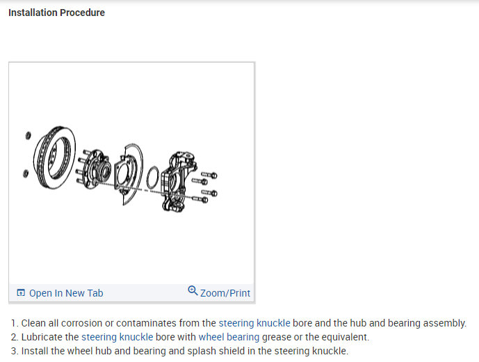

While driving a have a slight vibration or humming that goes on and off in the front drivers side , and when it does it it slows me down . I let off the gas and it stops but when I accelerate it does it again but not all the time .
May 6, 2021 at 9:13 PM
DANNY L
  • 5,648 POSTS

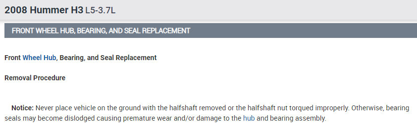

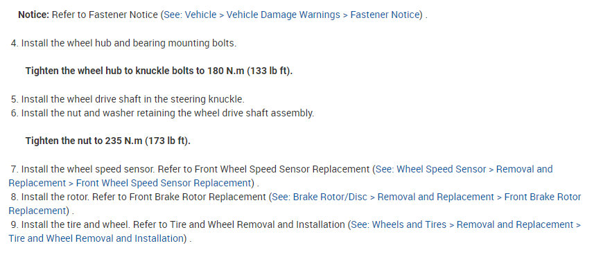

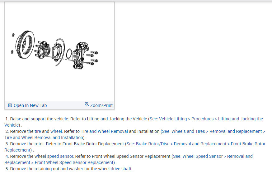

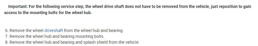

In a situation like this what we ask you to do is make a video with your cell phone of the noise-sound-vibration and upload it here. This will help us better diagnose the problem. The noise you may be hearing could be coming from the front hub assembly. Here is a tutorial showing how to replace the front hub assembly:
https://www.2carpros.com/articles/bearing-hub-replacement
I've attached picture steps below on how to replace the hub assembly on your vehicle. Hope this helps and thanks again for using 2CarPros.
