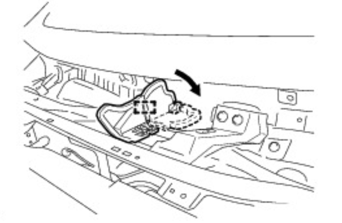

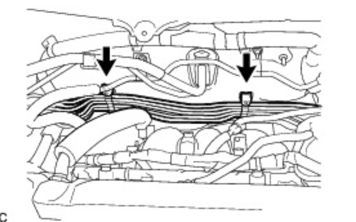

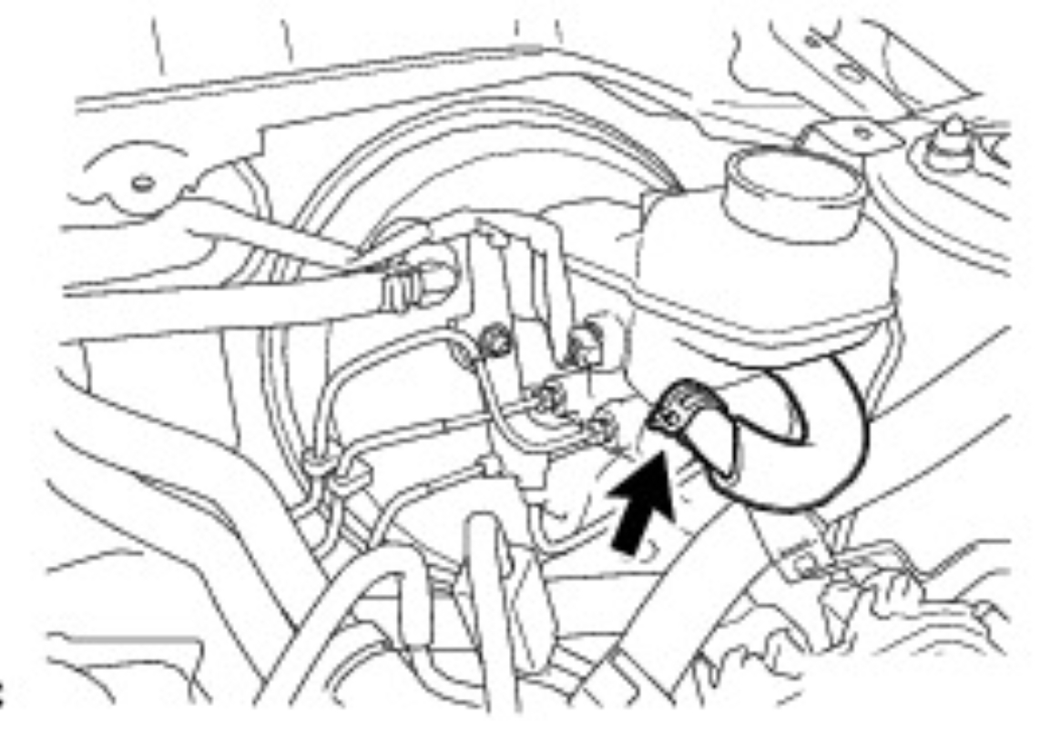

the brake pedal sinks when braking, slow speed or on reverse gear they say I need a booster can you help me please?
Jul 23, 2019 at 1:33 AM
good afternoon,
this issue is caused by a failing master cylinder, not a brake booster at all.

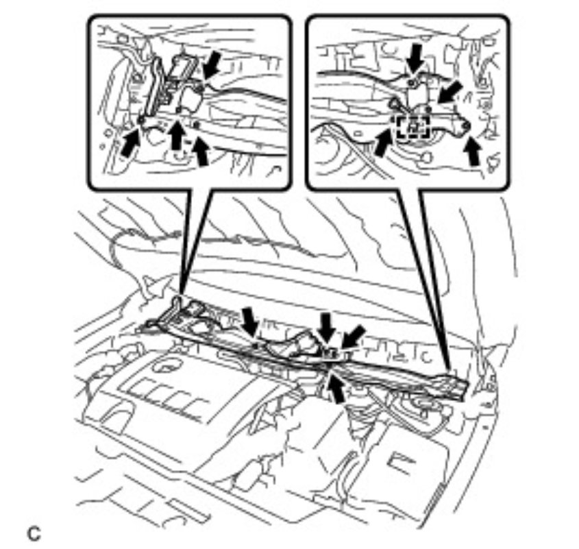

disengage the clamp.
remove the 12 bolts and outer cowl top panel.
remove outer cowl top panel (except tmc made)

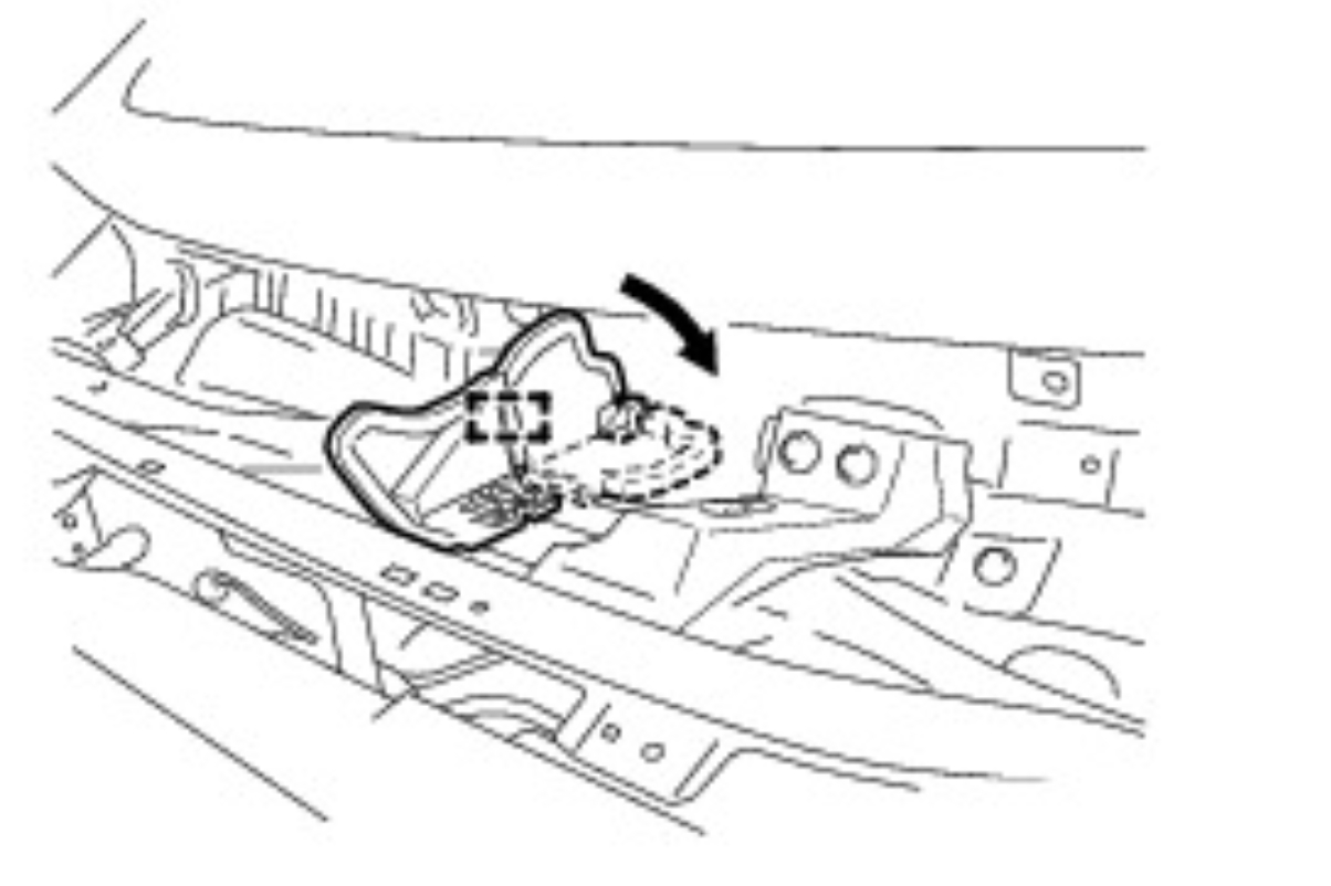

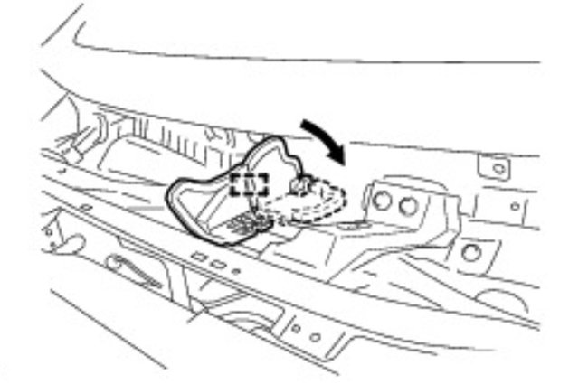

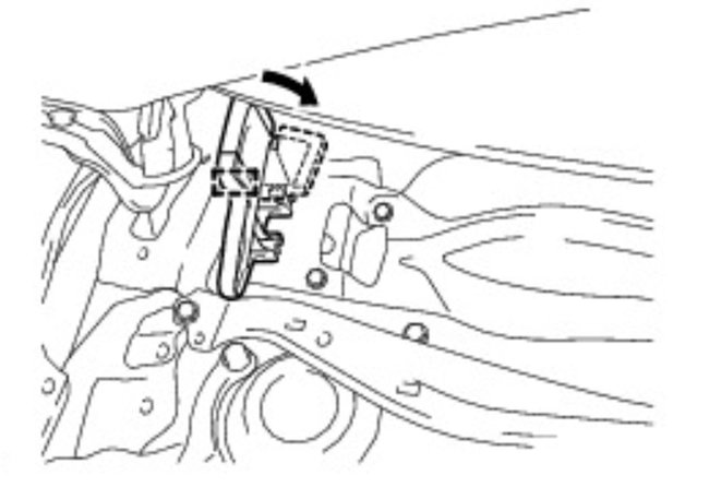

disengage the clamp and bend the water guard plate rh as shown in the illustration.
disengage the clamp and bend the no. 1 heater air duct splash shield seal.

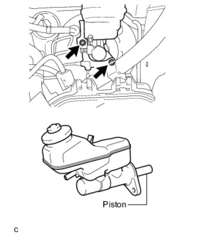

remove brake master cylinder sub-assembly

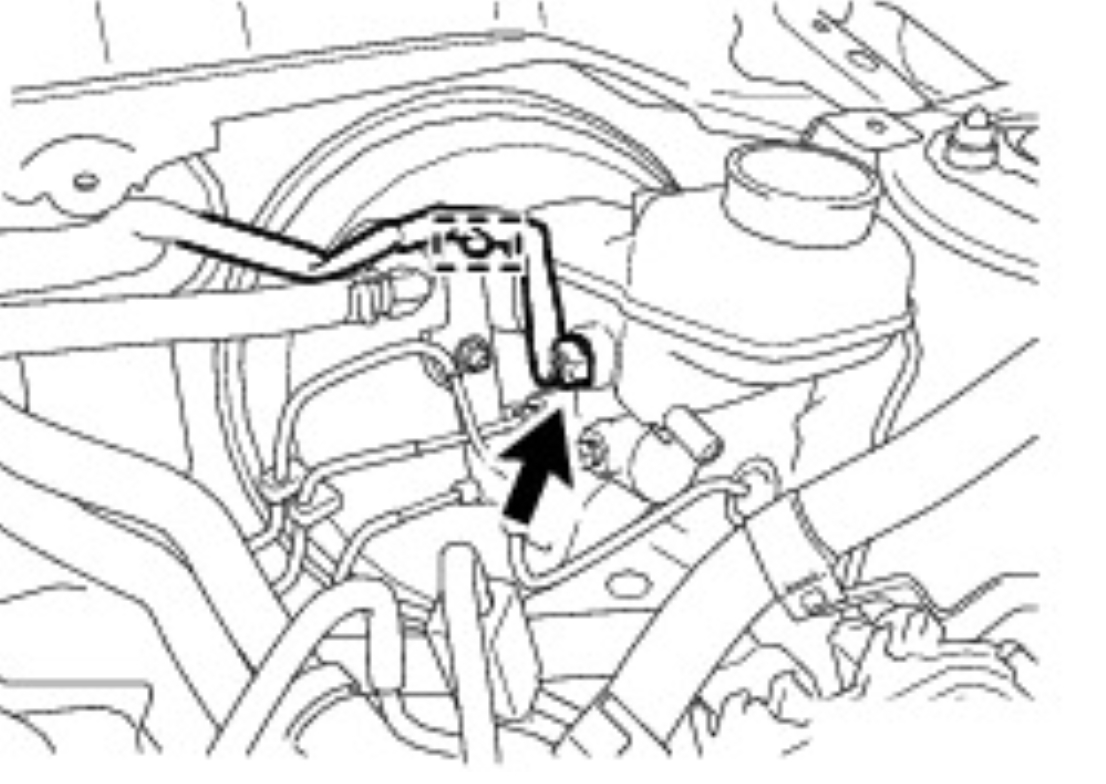

disconnect the connector and disengage the clamp.

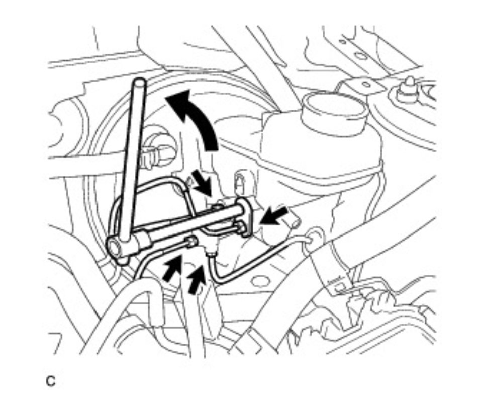

using a union nut wrench (10 mm or 12 mm), disconnect the 4 brake lines from the brake master cylinder sub-assembly.

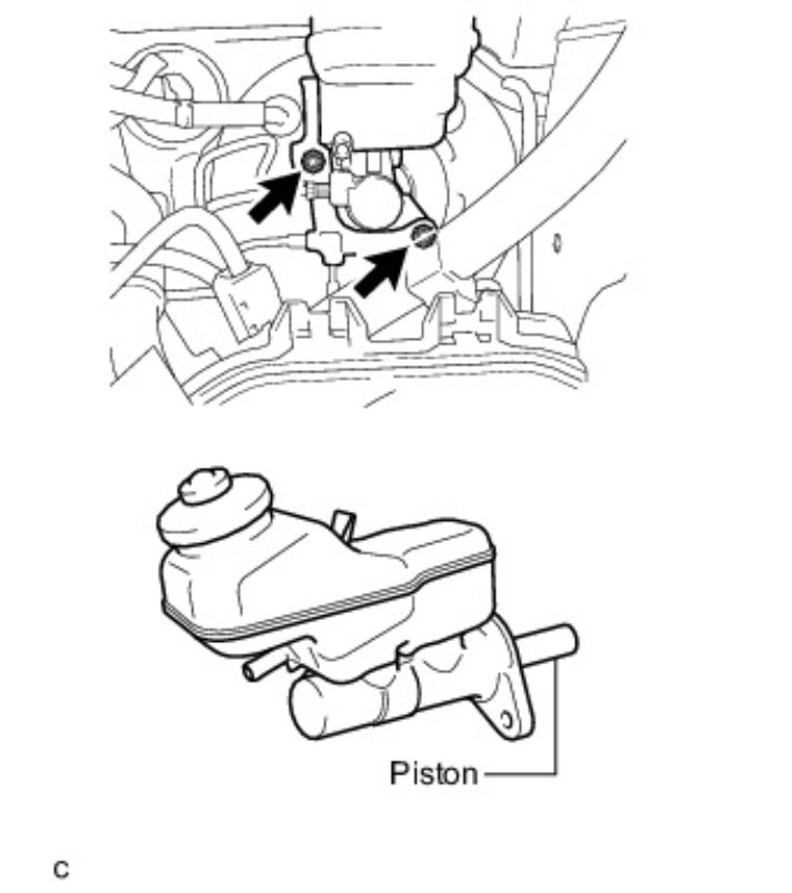

remove the 2 nuts, brake tube way and brake master cylinder sub-assembly.
notice:
the master cylinder requires careful handling. do not allow the master cylinder to receive any impact, such as from being dropped. do not reuse a master cylinder that has been dropped.
do not strike or pinch the master cylinder piston, and do not cause any damage to the master cylinder piston by any other means.
make sure to release the vacuum from the brake booster before removing the master cylinder from the brake booster.
when installing the master cylinder to the brake booster, or when removing the master cylinder from the brake booster, make sure that the master cylinder is kept horizontal or its tip faces downward (the piston faces upward) to prevent the master cylinder piston from falling off.
do not allow any foreign objects to contaminate the master cylinder piston. if a foreign object gets on the piston, remove it by using a piece of cloth and then apply an even layer of lithium soap base glycol grease around the circumference (sliding part) of the piston.
do not use any other type of grease or fluid.

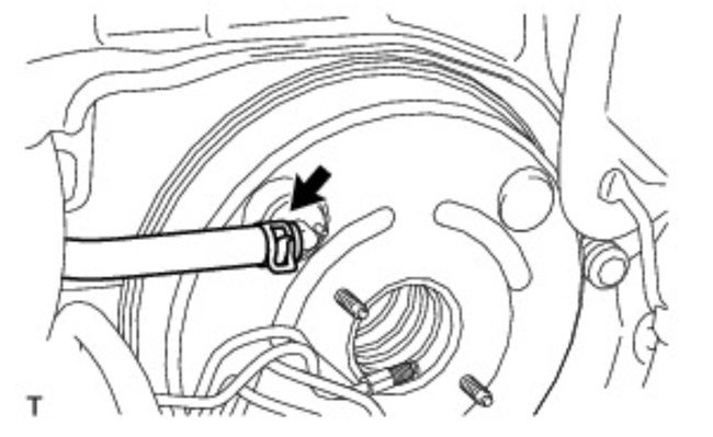

disconnect vacuum hose
slide the clip and disconnect the vacuum hose.

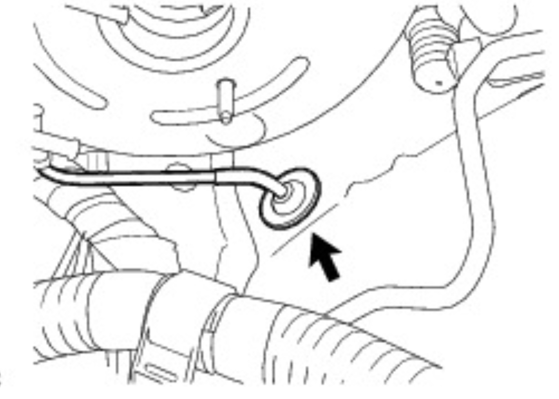

remove no. 5 front brake tube

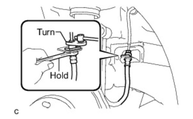

using a union nut wrench (10 mm), disconnect the no. 5 front brake tube from the front brake flexible hose lh.
remove the grommet and no. 5 front brake tube from the body.

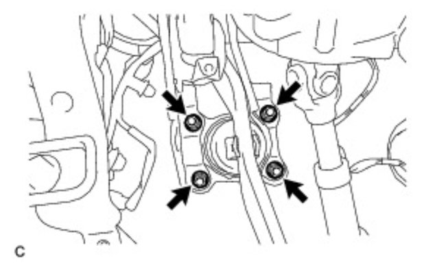

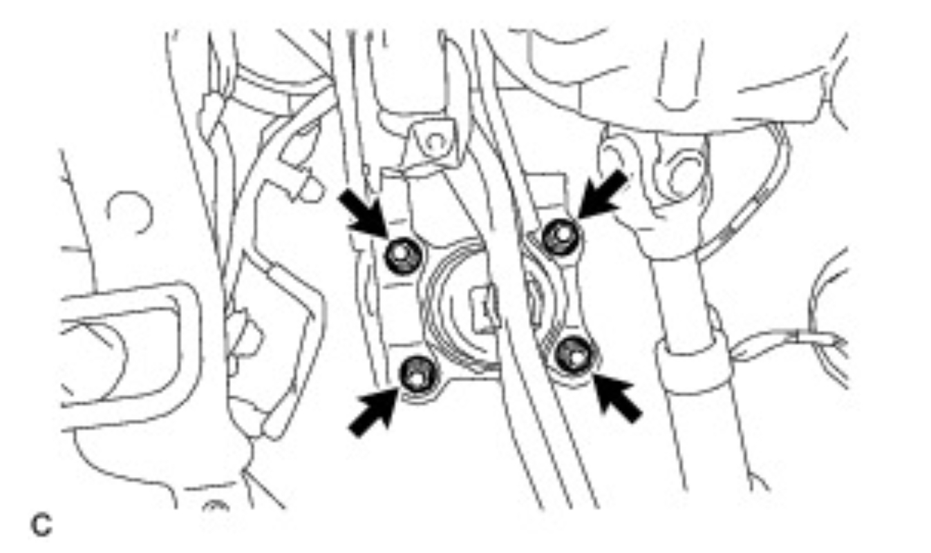

remove brake booster assembly
disengage the 2 clamps and separate the brake lines from the body.
remove the 4 nuts and brake booster assembly from the body.
do not damage the brake lines or fuel lines.
