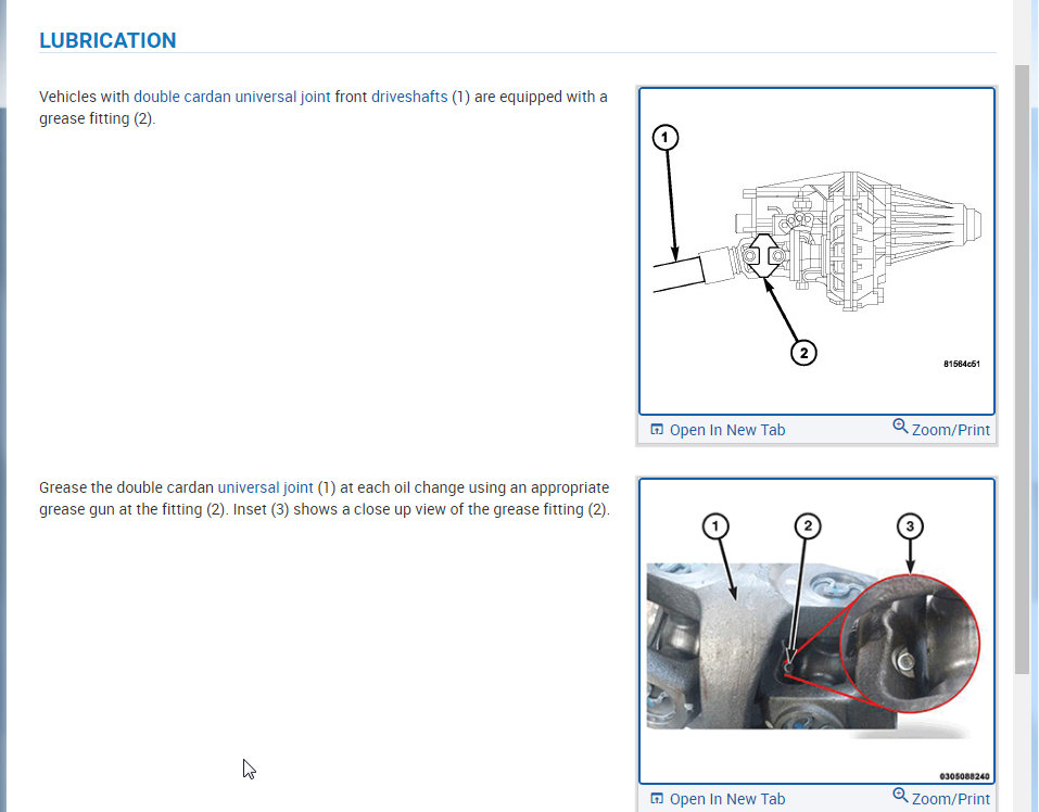

Just to understand the issue. You are above 70 MPH and you go in or out of a turn and you feel the vibration? So it does not do this when going straight?
If this is the case, do you have an extended cab and long bed? If you do then you have a two piece drive shaft. If you have a two piece drive shaft then you have a double cardan joint that requires lubrication and most people don't know about it and never do it. Then it starts causing a vibration. Take a look at the attachment. Keep in mind this needs a special grease gun to get in there. They sell them at most parts stores but don't let them sell you just a common grease gun because it won't work.
Let's try this and go from there. Thanks

I do have that joint on the front driveshaft. It gets greased as it states every oil change. I bought a grease gun with a needle point just for it. I also removed the front driveshaft and drove it for a week without it and had no changes. Rear driveshaft is solid one piece shaft has one u-joint off the t-case and one u-joint into the rear differential.
Nov 24, 2020 at 8:53 PM

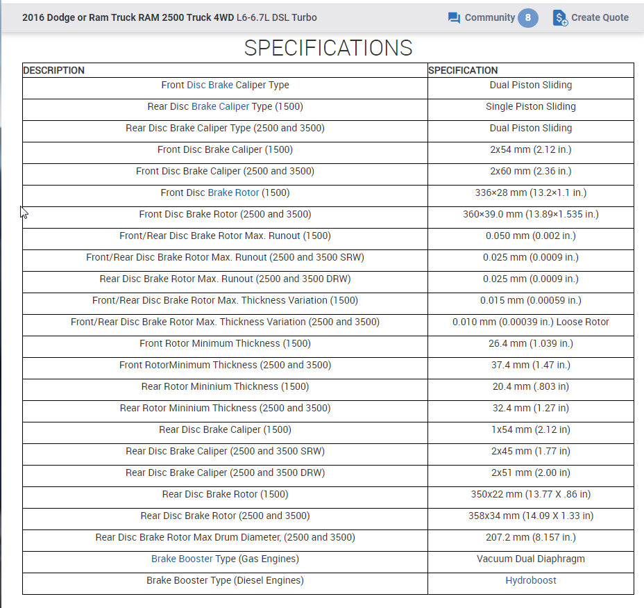

What can I do at home to diagnose? I feel like it is something that rotates constant. I may go buy a dial indicator and check run outs.
Nov 27, 2020 at 10:13 AM

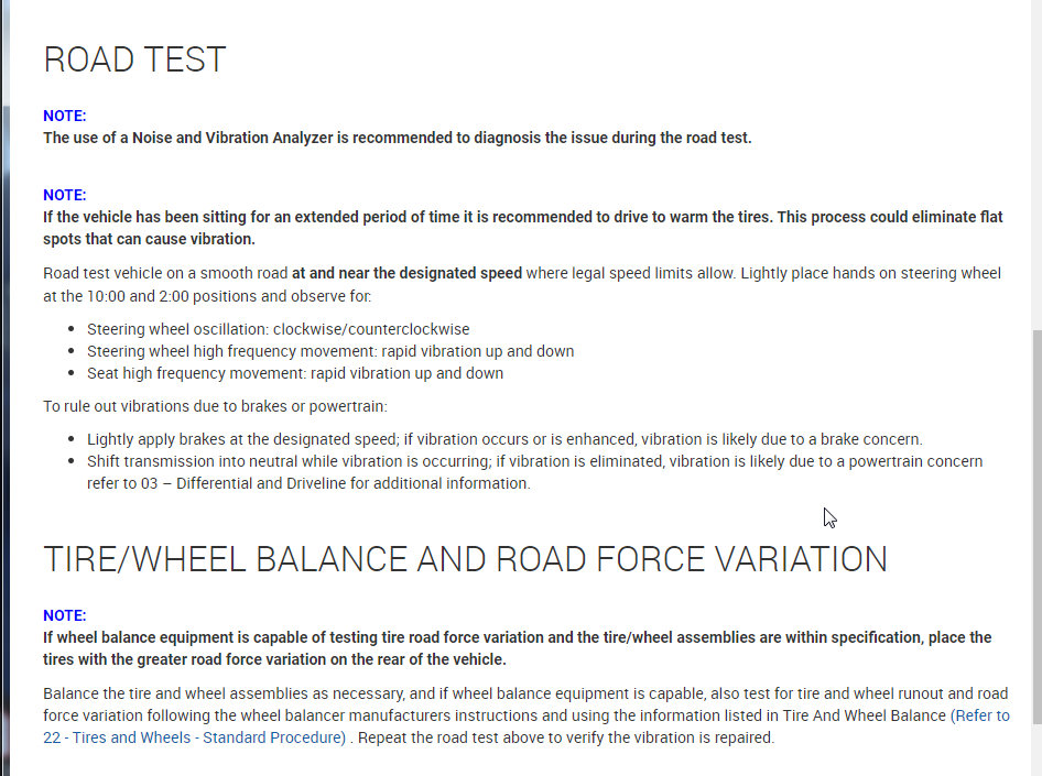

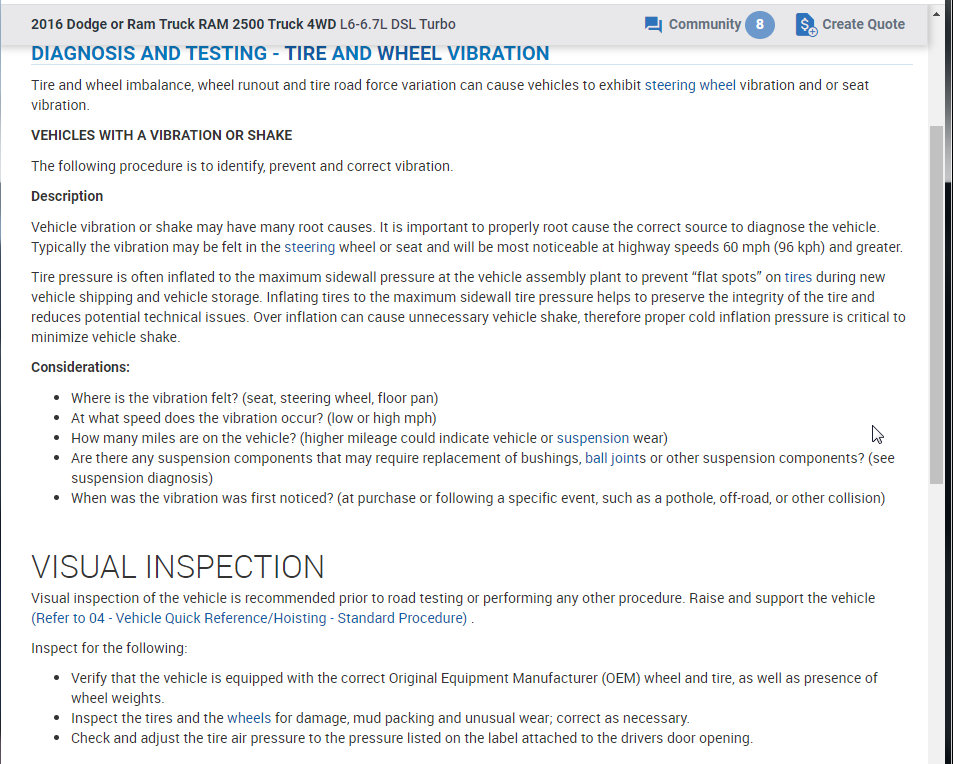

That is a great option. Do you have experience doing this? We need to check the hubs and rotors for runout. You can just start with the rotors because if they are out you can do the hubs but if not then the hubs are fine.
To eliminate a drive shaft for sure is to remove the rear drive shaft and drive it in 4WD and see if it still does it. Clearly this is a little harder with your issue as it is higher speeds but if you do it someplace safe, you can get up that fast. Clearly acceleration needs to be done slower.
I attached the runout specs. Let me know and I can get you more detailed info. Plus I attached some testing from the manual on tire/wheel vibrations. Clearly we have an issue with this if it is a constant vibration or possibly an axle shaft.
