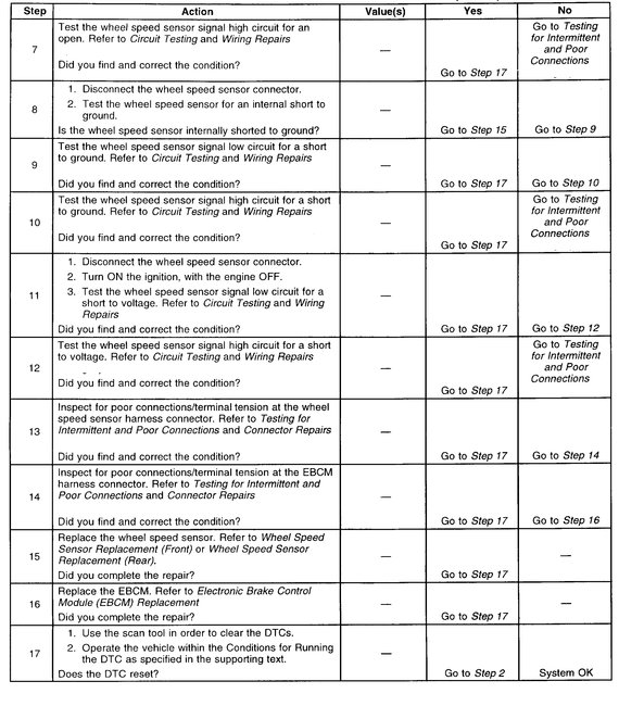

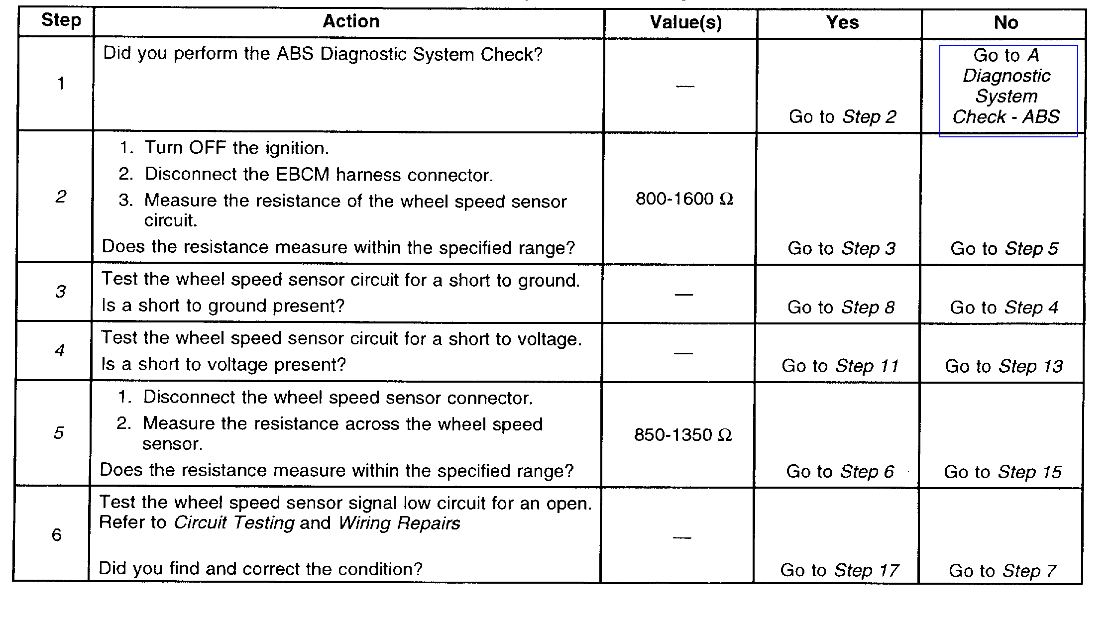

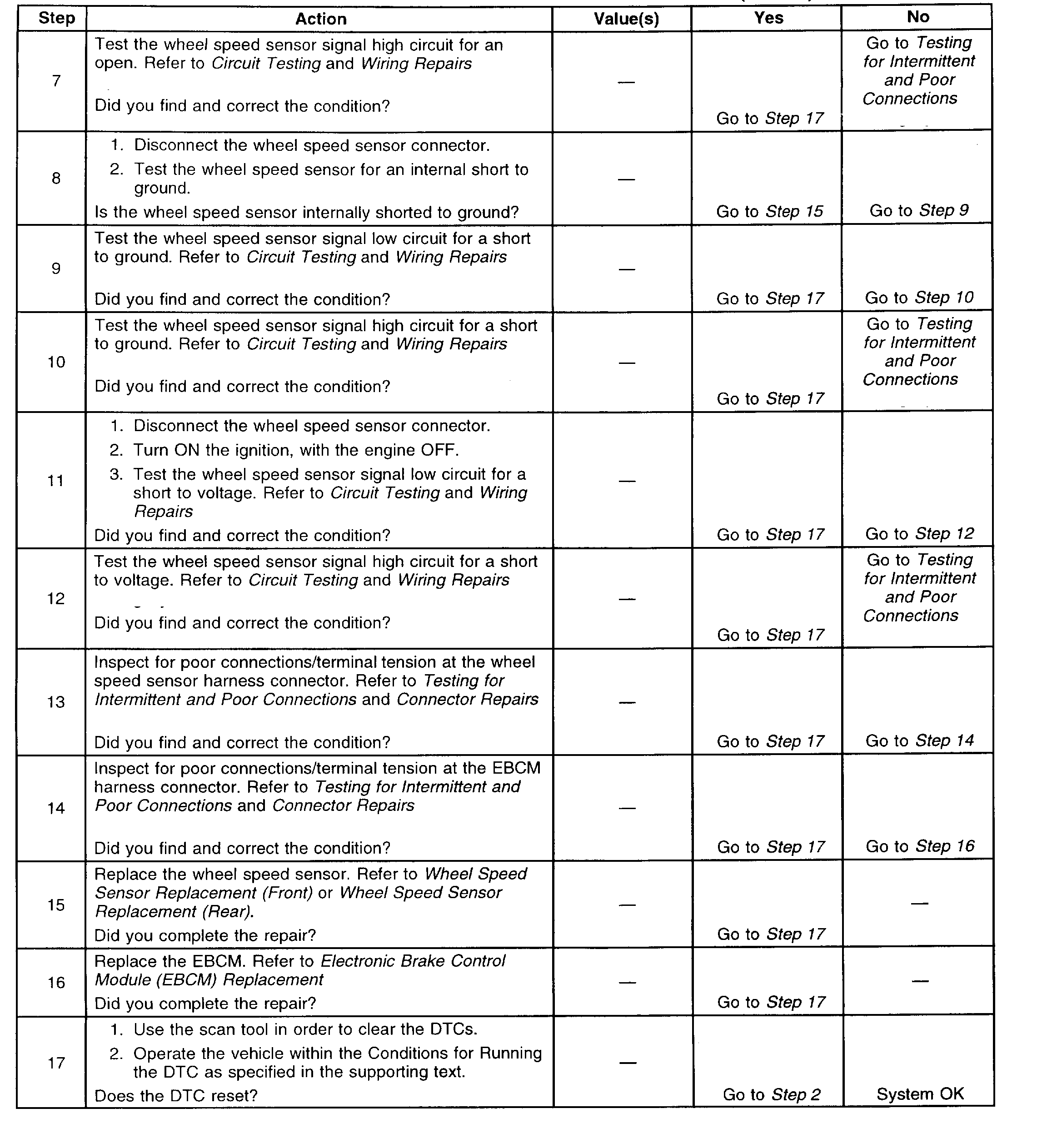

I have attached diagnostic flow charts in picture form for you to follow. You can do this or simply replace the sensor to see if the problem is eliminated.

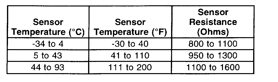

Rear Wheel Speed Sensor Resistance
The following table contains resistance values for the front wheel speed sensors at varying sensor temperatures for use in diagnosis. The values are approximate and can be used as a guideline for diagnosis.
Test Description
The number below refers to the step number on the diagnostic table.
2. This step tests the wheel speed sensor and the wheel speed sensor signal circuits for an open.
3. This step tests the wheel speed sensor and the wheel speed sensor signal circuits for a short to ground.
4. This step tests the wheel speed sensor and the wheel speed sensor signal circuits for a short to voltage.
5. This step tests the wheel speed sensor for the proper resistance value.
_________________________
Picture 3 shows the resistance values for the sensor.

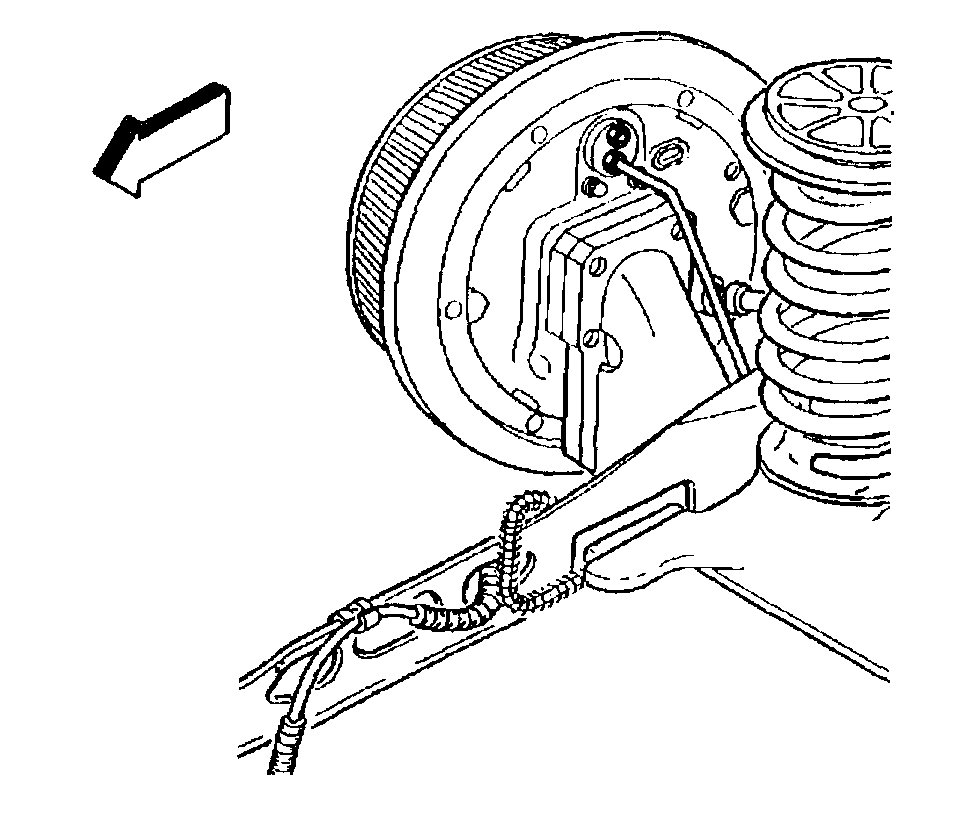

IF you find the sensor is bad, here are directions specific to your vehicle for replacement. I will start with the rear brakes because that is where I feel the problem is.
REAR
Removal Procedure

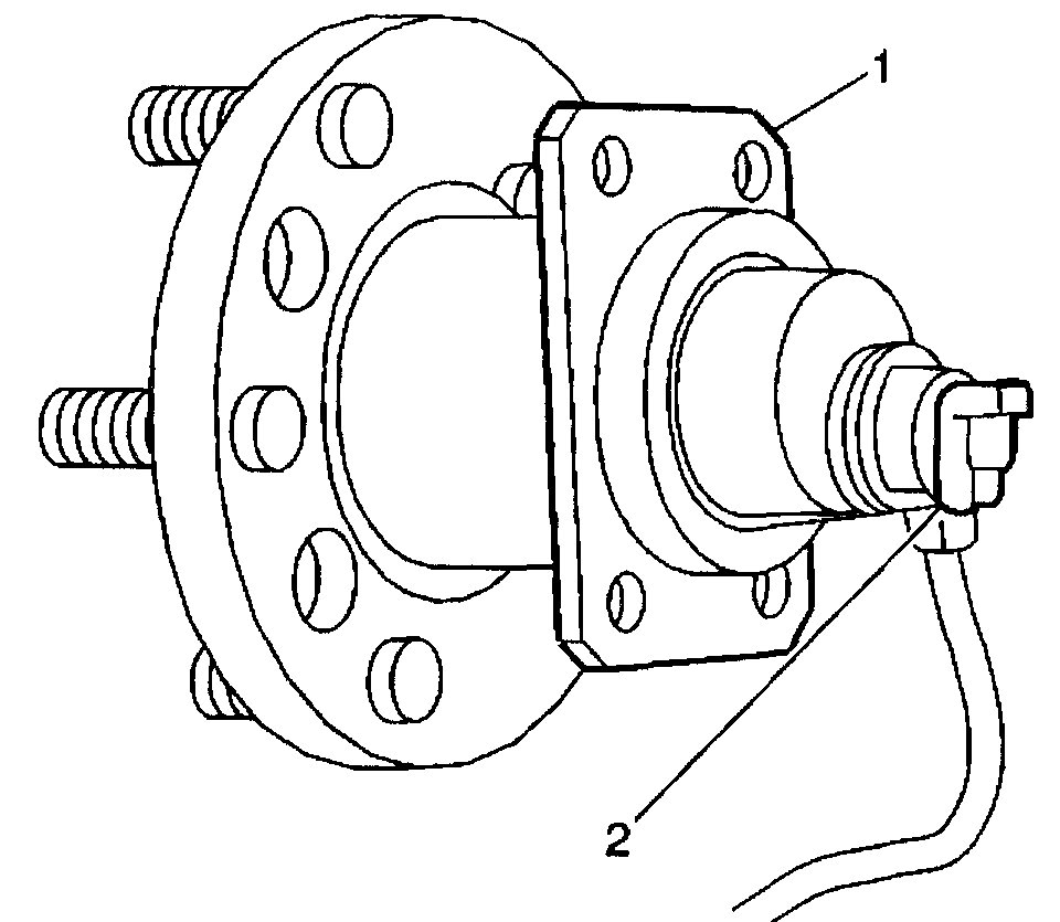

See Pic 4
Important: The rear wheel speed sensors and rings are integral with the hub and bearing assemblies.
If a speed sensor or a ring needs replacement, replace the entire hub and bearing assembly. Refer to Wheel Bearing/Hub Replacement - Rear (Domestic) or Wheel Bearing/Hub Replacement - Rear (Export).
1. Raise and support the vehicle on a suitable hoist. Refer to Vehicle Lifting.
2. Remove the rear tire and wheel assembly. Refer to Tire and Wheel Removal and Installation.

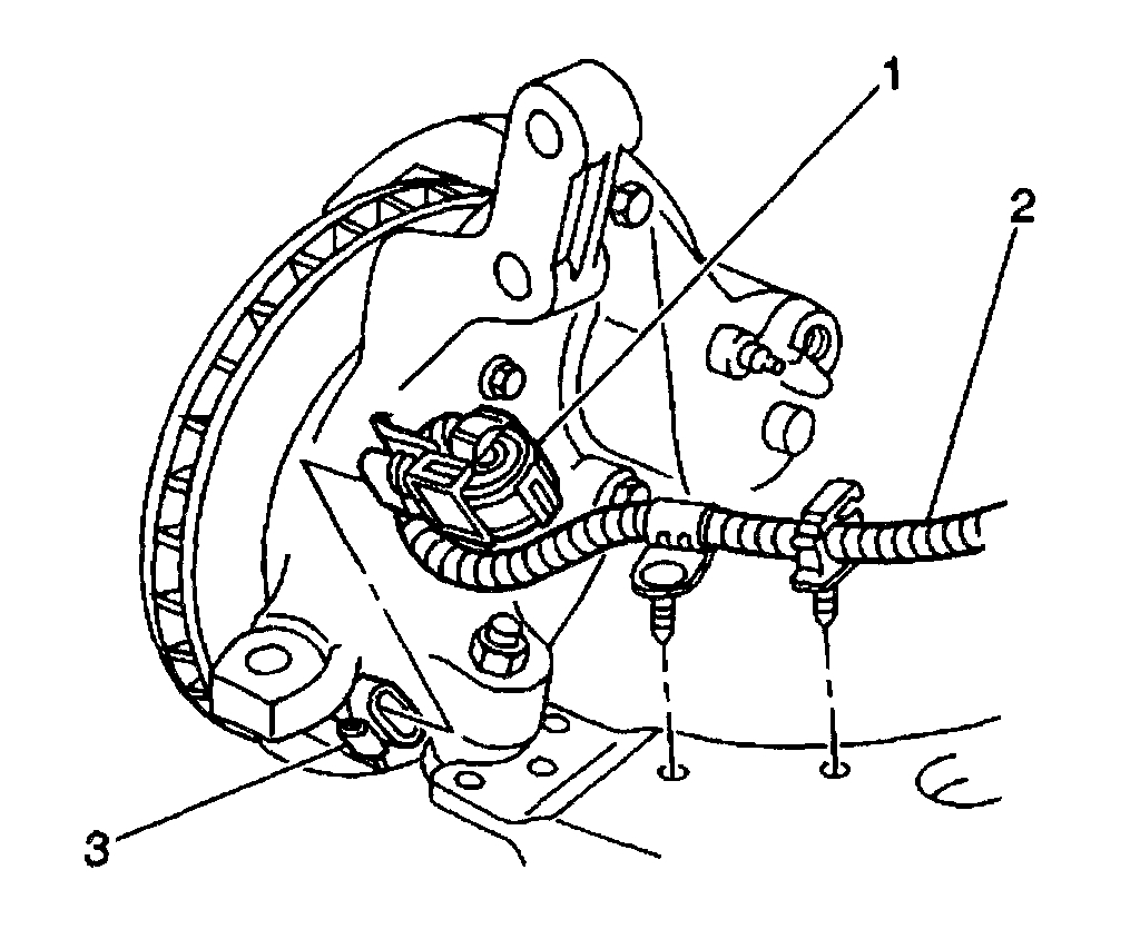

3. Remove the rear wheel speed sensor electrical connector located next to the rear strut.
See pic 5
4. Remove the hub and bearing assembly (1). Refer to Wheel Bearing/Hub Replacement - Rear (Domestic) or Wheel Bearing/Hub Replacement - Rear (Export).

See pic 4
1. Install the hub and bearing assembly (1) to the vehicle. Refer to Wheel Bearing/Hub Replacement - Rear (Domestic) or Wheel Bearing/Hub Replacement - Rear (Export).
See Pic 5
2. Install the rear wheel speed sensor electrical connector.

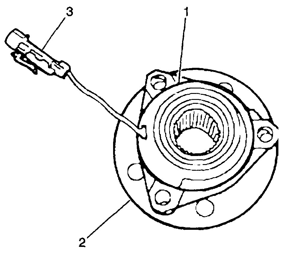

Front sensor:
FRONT
Removal Procedure
Important: The front wheel speed sensors and rings are integral with the hub and bearing assemblies. If a speed sensor or a ring needs replacement, replace the entire hub and bearing assembly. Do not service the harness pigtail individually because the harness pigtail is part of the sensor, Refer to Wheel Bearing/Hub Replacement - Front.
See Pic 6
2. Remove the front tire and wheel assembly. Refer to Tire and Wheel Removal and Installation.
3. Remove the front wheel speed sensor jumper harness electrical connector (1) from the front wheel speed sensor connector (3).
See Pic 7
4. Remove the hub and bearing assembly (2). Refer to Wheel Bearing/Hub Replacement - Front.
