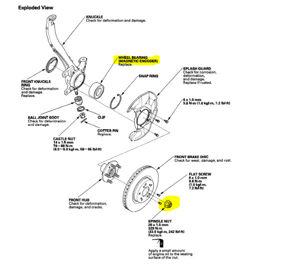

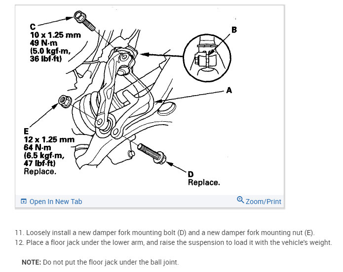

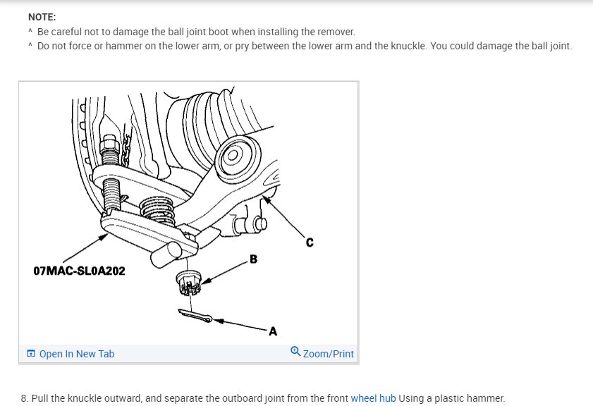

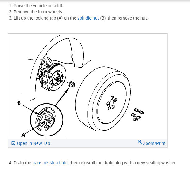

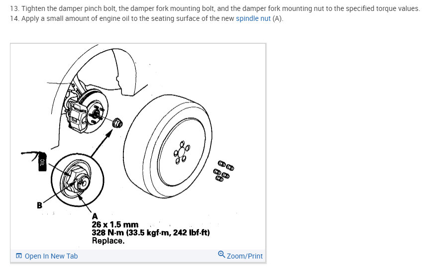

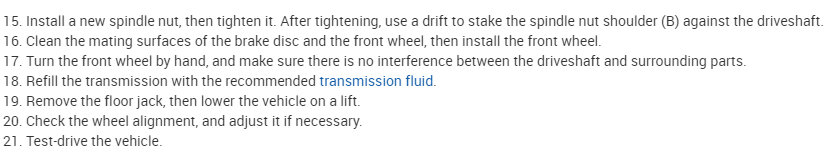

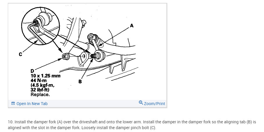

Next, the idea that it is more noticeable after turning has me a little concerned. When the repairs were done, did they replace both the bearing and steering knuckle? This vehicle has a press-in bearing. I'm concerned something wasn't fully seated or tightened. The spindle nut is my first thought. See pic below
If you lift one wheel at a time off the ground, check to see if there is any in and out play at the wheel. Also, check for any looseness.
See pic below.

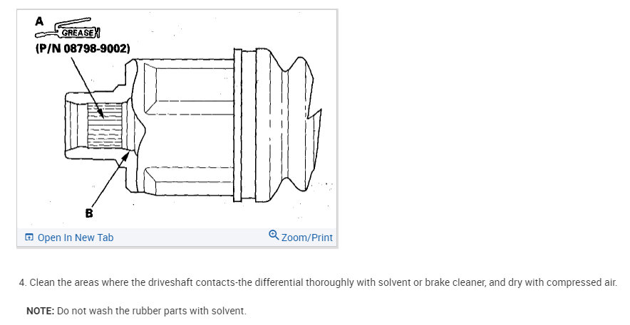

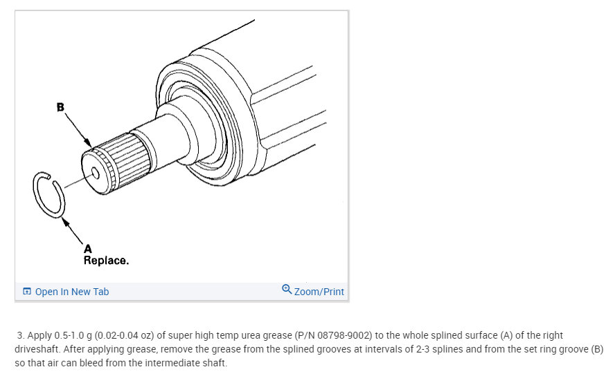

Hey Jacob. I took it by an actual auto shop and was inspected by the technician. He came back saying that the right front CV Axle needed replacement which is causing the vibration.
Feb 20, 2023 at 6:20 AM
  • 110,244 POSTS
I'm surprised they didn't notice that when replacing the wheel bearing, but anything is possible.

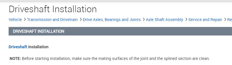

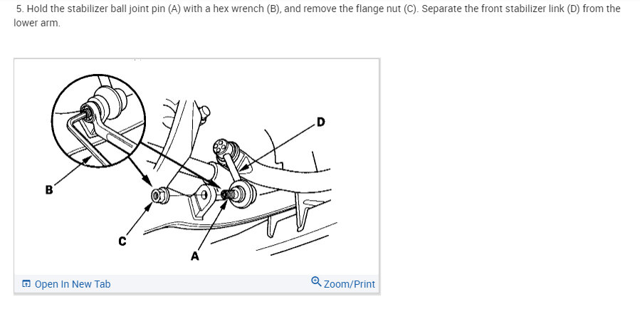

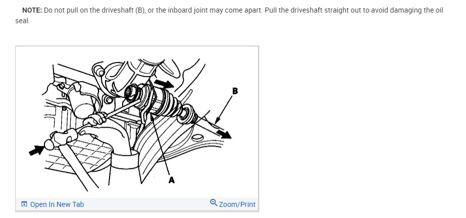

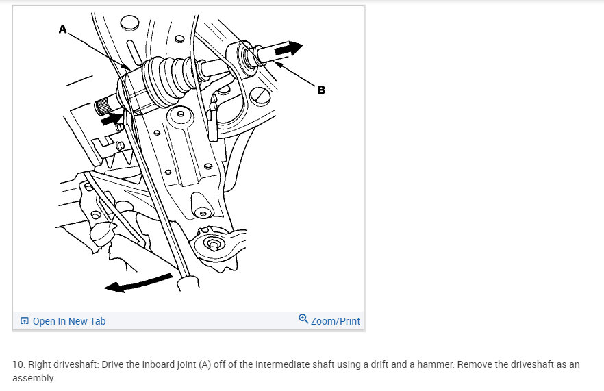

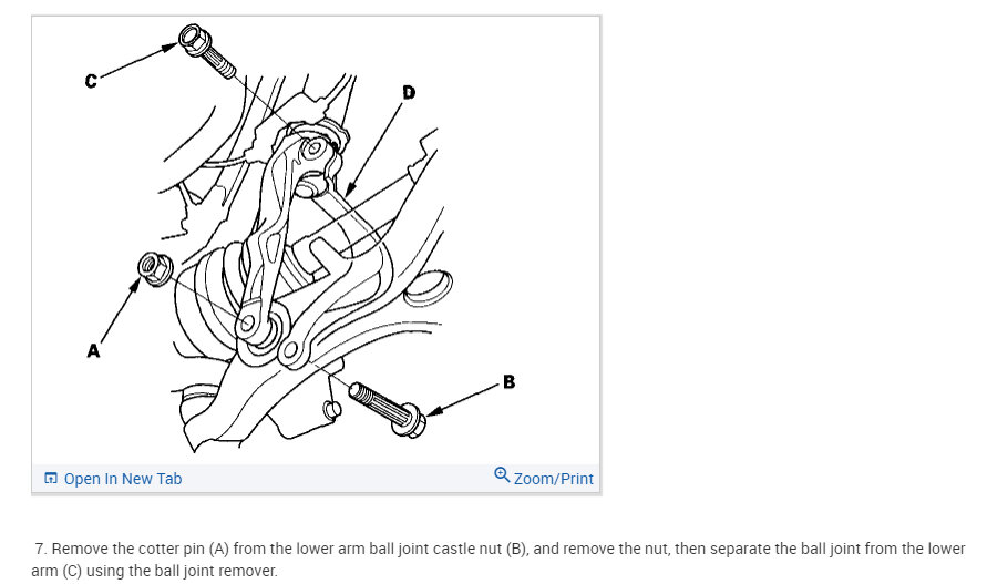

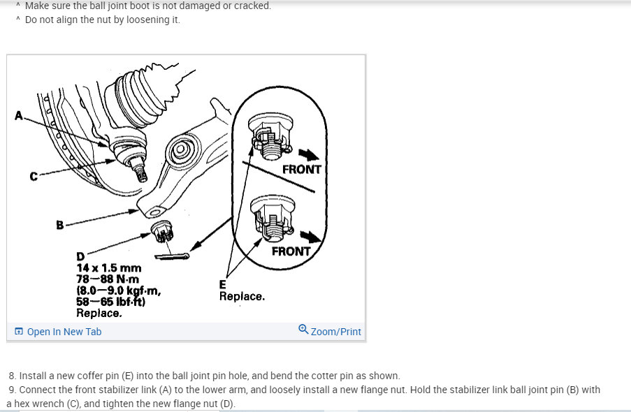

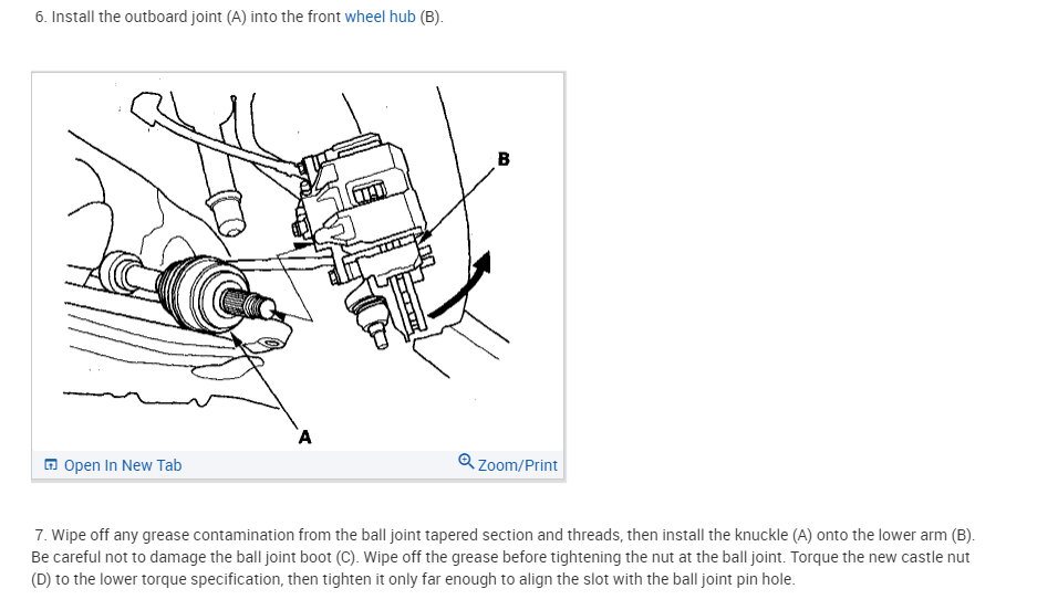

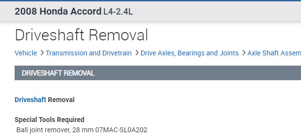

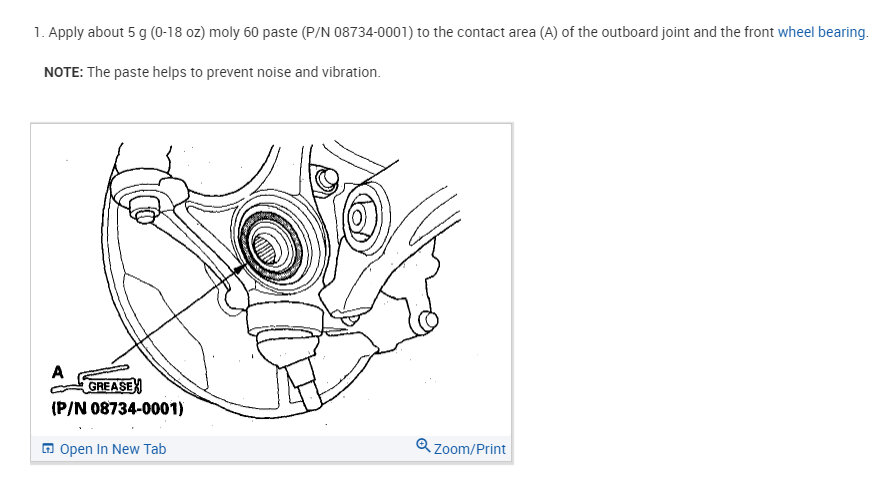

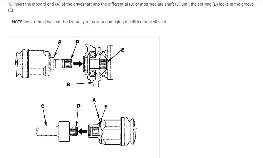

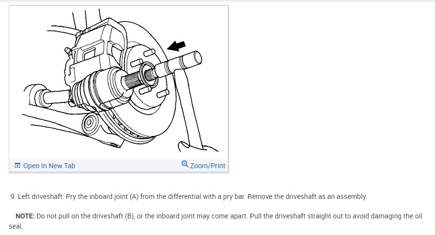

As far as replacing the drive axle, I don't know if you plan to have them do it or if you plan to do it yourself. So, I attached the directions below for you.
If you have questions, let me know. Also, let me know if this takes care of the issue.
