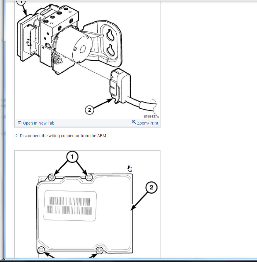

I do not know how to fully explain this problem but I will try. So there has been vibration. So I changed both front wheel hubs.This did not fix the problem but when I unplug ABS sensor vibration is gone. Any help would be helpful as I do not understand why vibration with ABS sensor plugged in vibration gone when I unplug ABS sensor.
Jun 4, 2018 at 7:33 PM

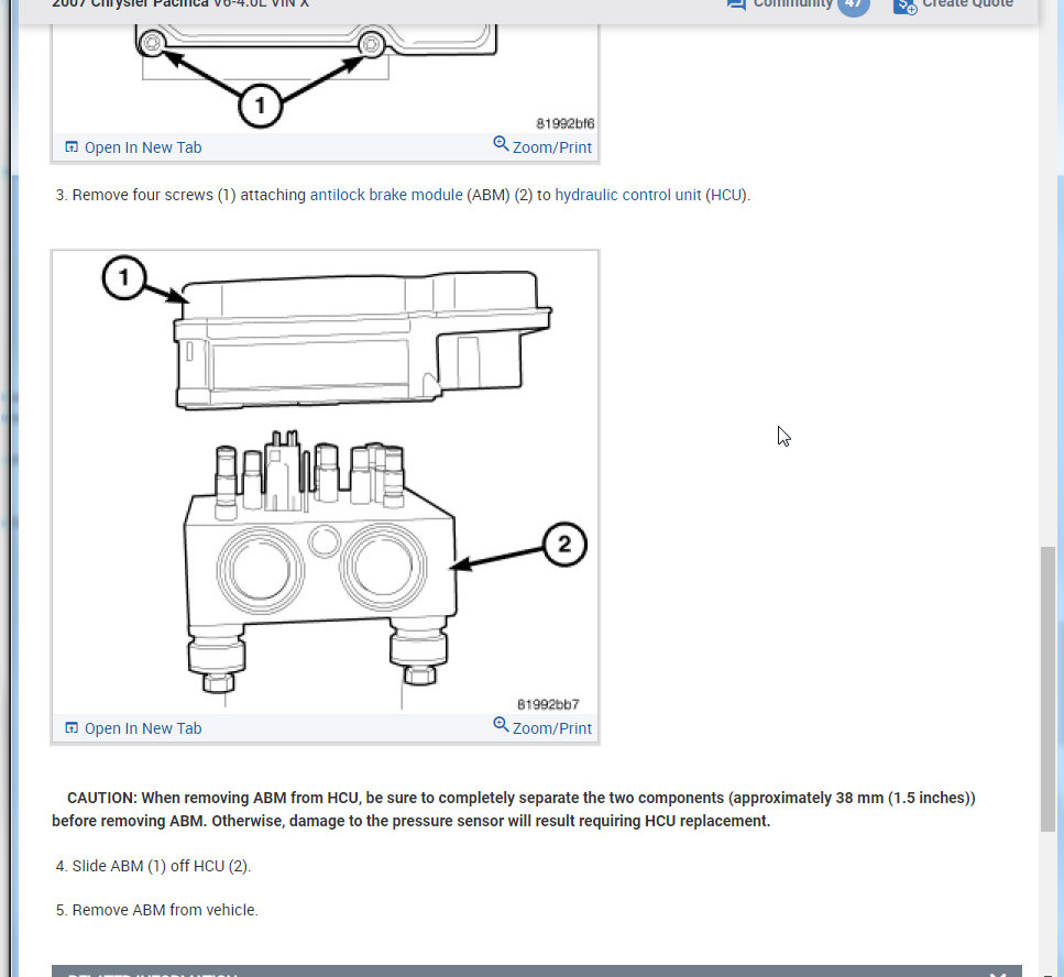

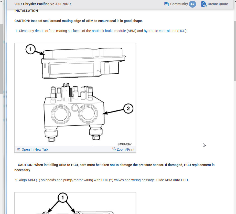

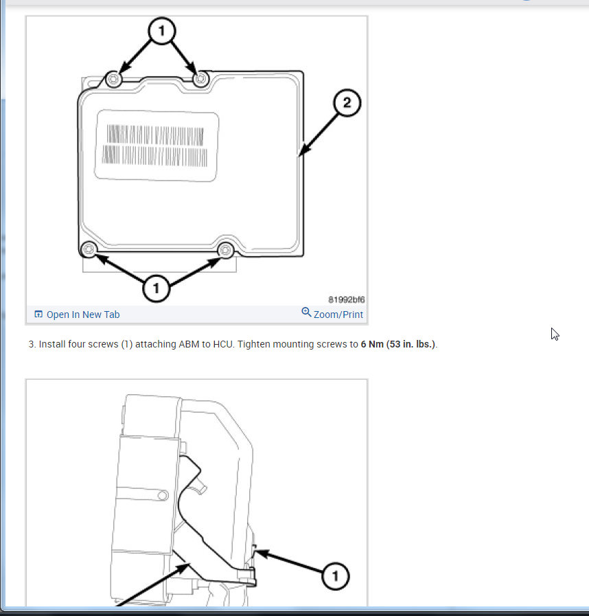

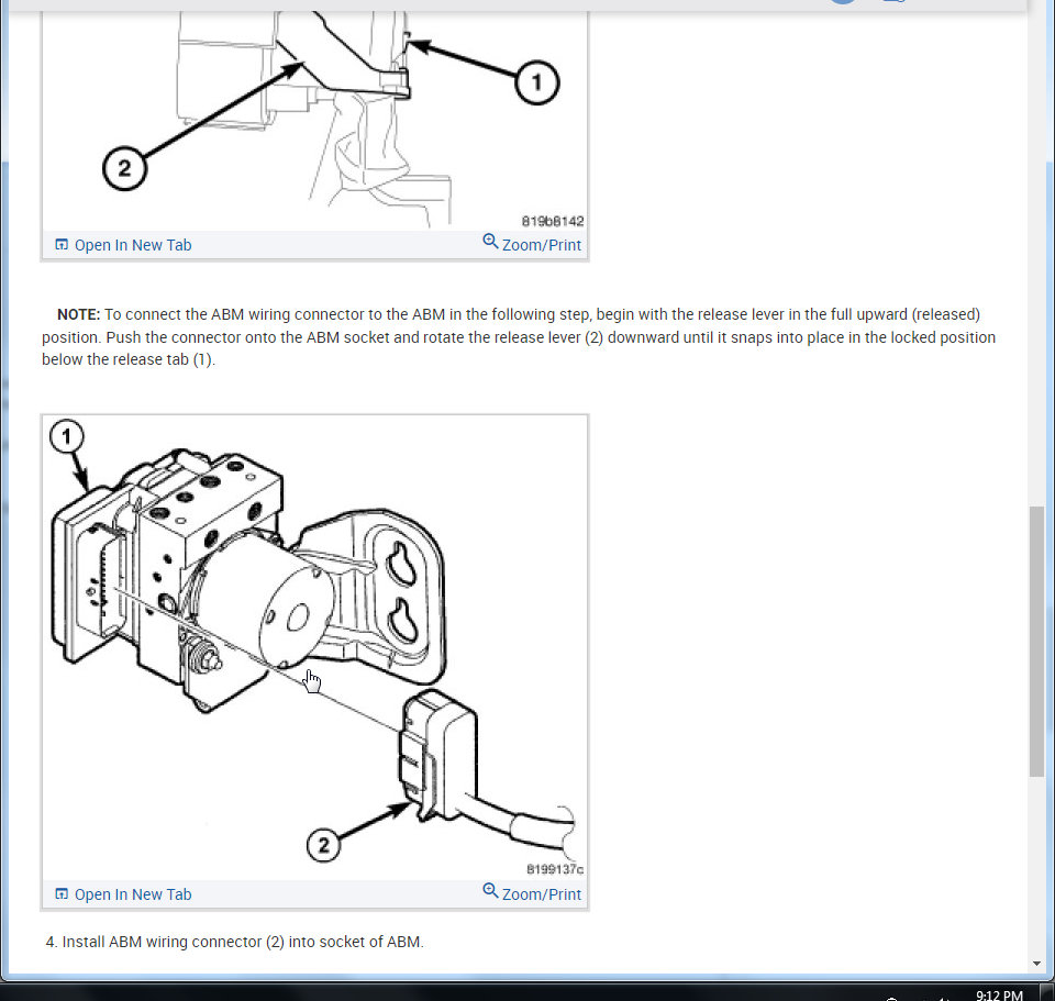

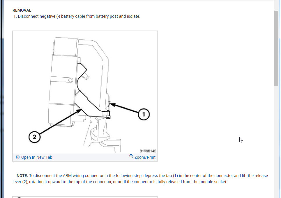

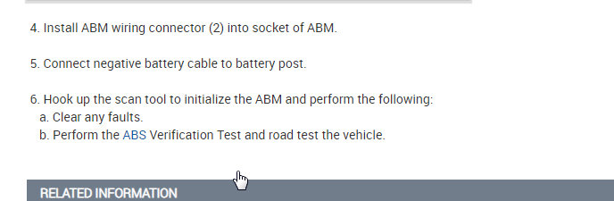

Here is a guide that will help with getting this replaced:
https://www.2carpros.com/articles/how-to-replace-a-abs-controller
Below you will find the specific instructions on how to replace this from the manual.
Please let us know if you have questions. Thanks
