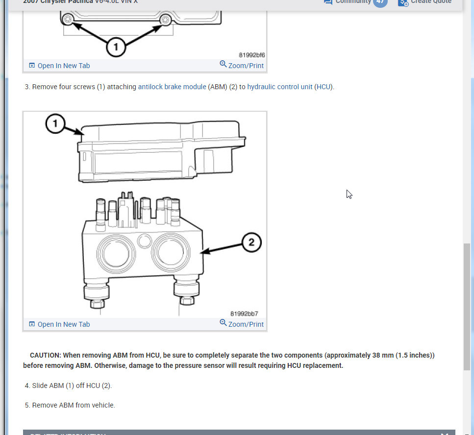

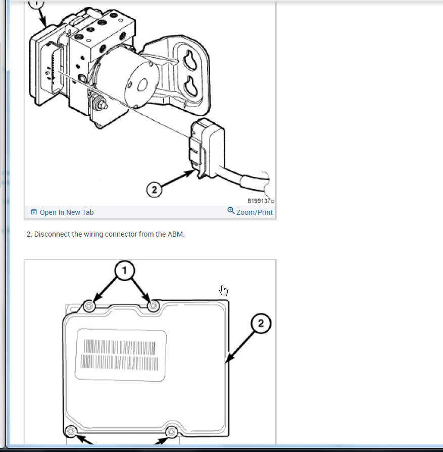

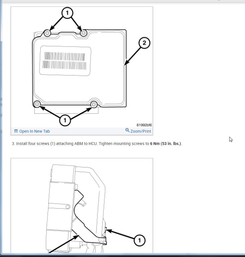

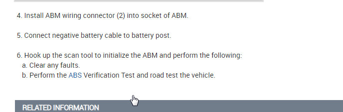

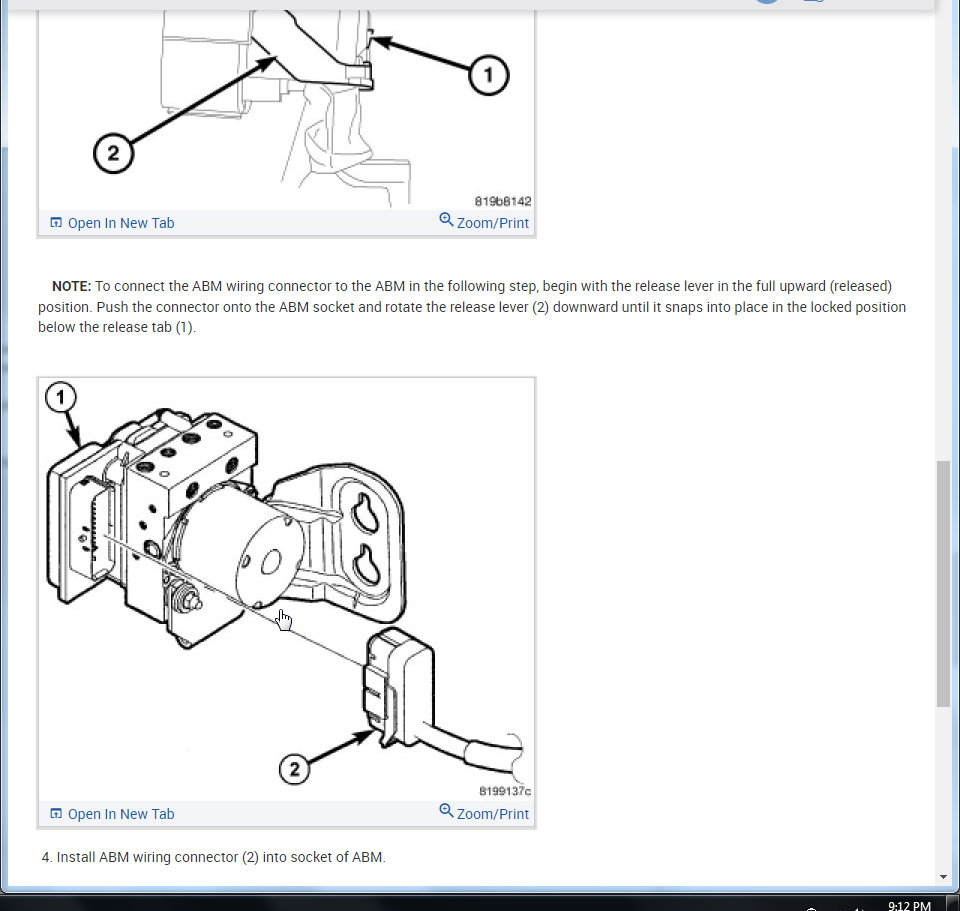

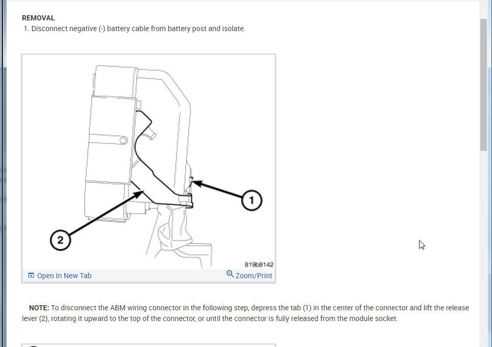

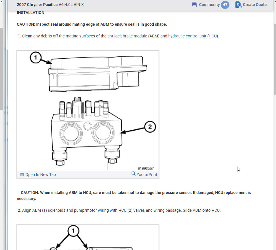

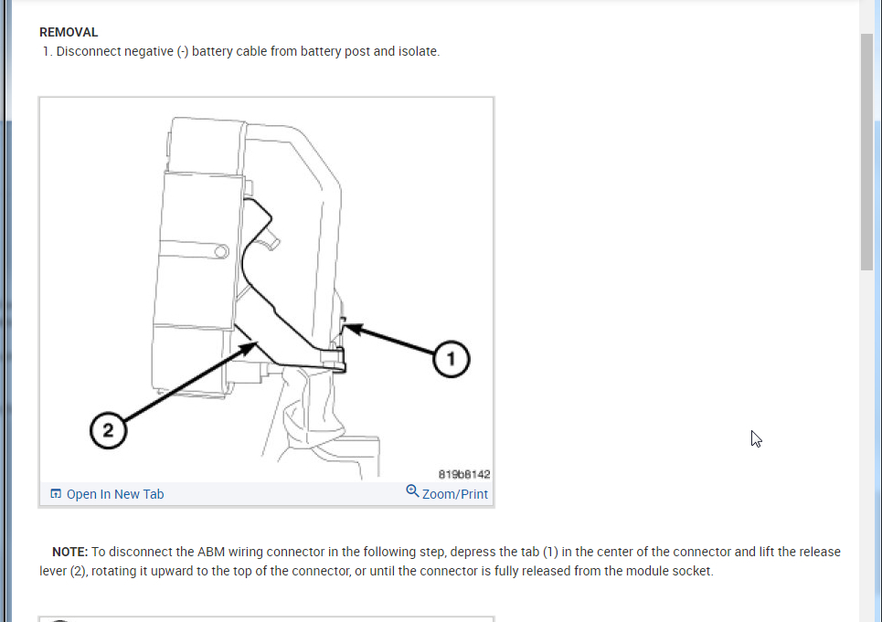

Here is a guide that will help with getting this replaced:
https://www.2carpros.com/articles/how-to-replace-a-abs-controller
Below you will find the specific instructions on how to replace this from the manual.
Please let us know if you have questions. Thanks
