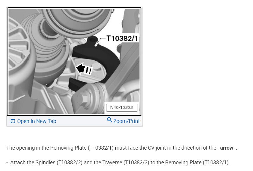

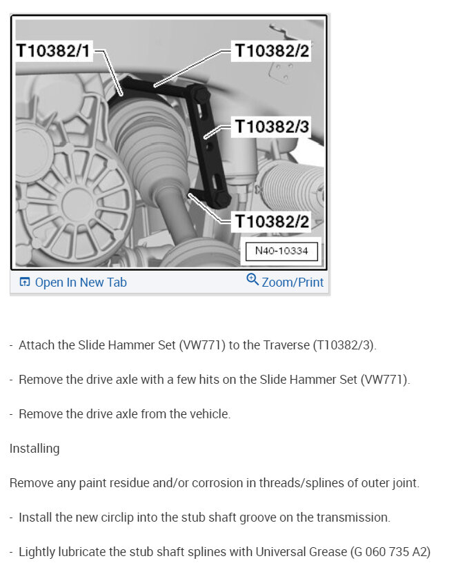

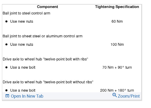

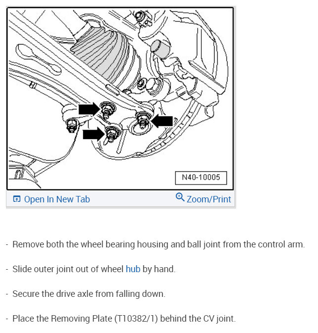

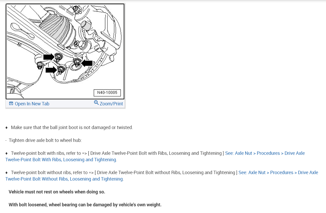

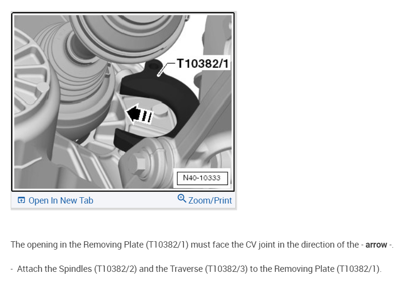

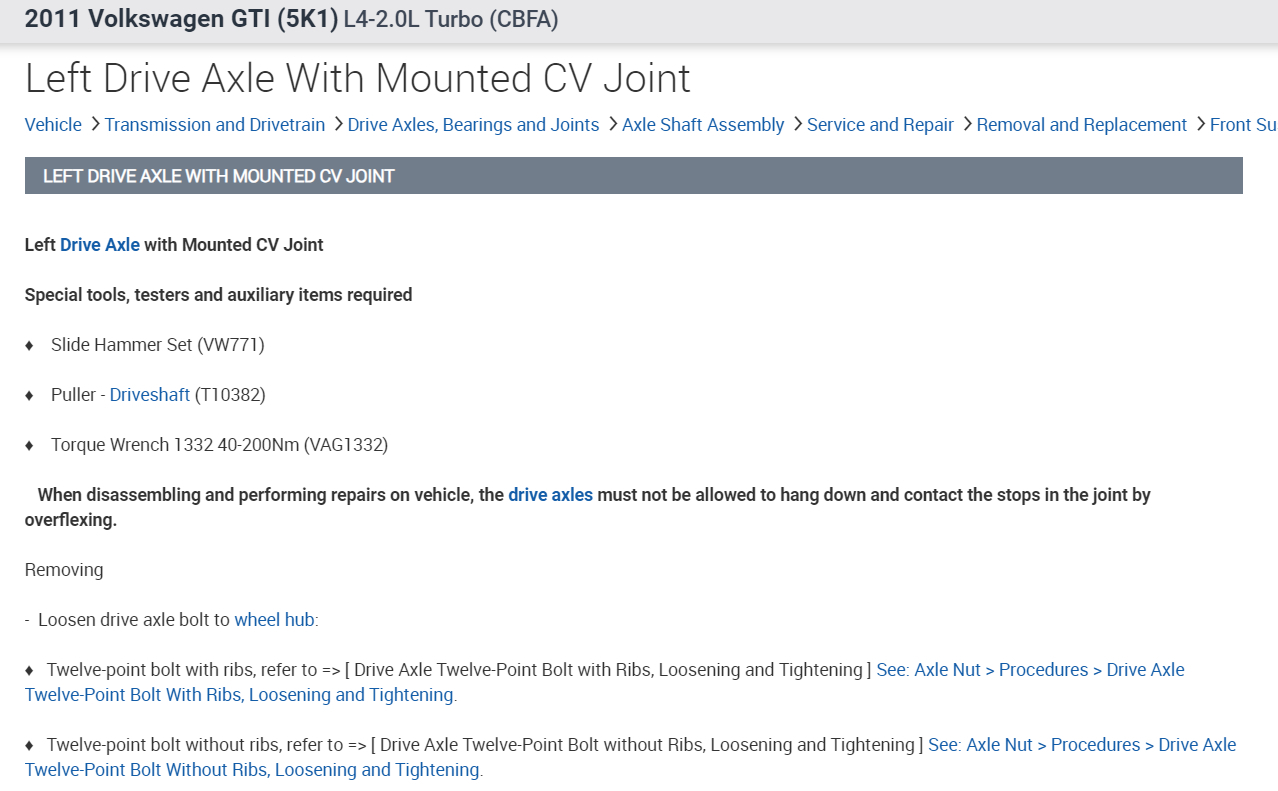

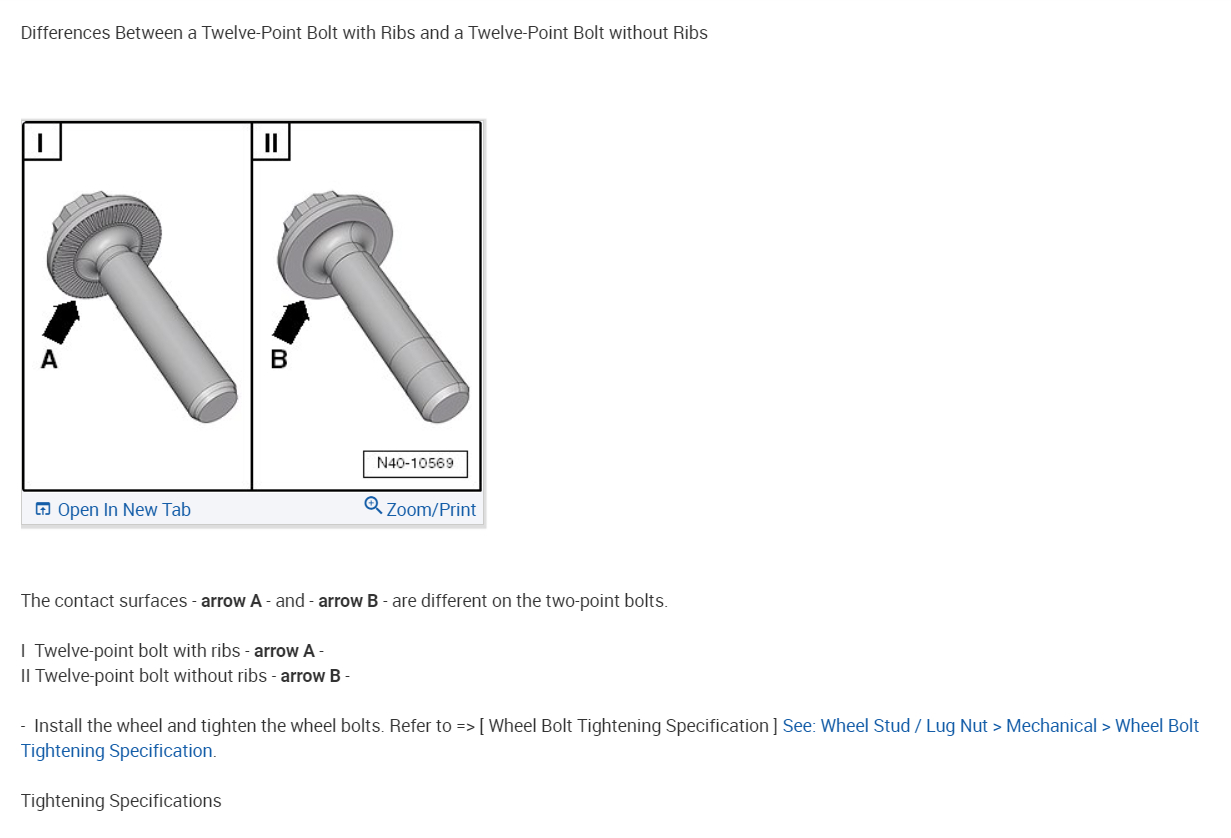

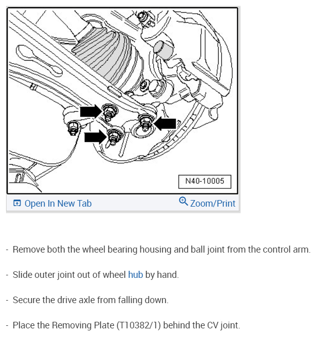

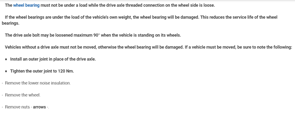

If you have not changed out the CV axles this could be the problem due to worn out CV joints. Please check out this guide and see why this could be the cause:
https://www.2carpros.com/articles/how-a-cv-joint-works
Here is a generic guide to help you step by step with instructions in the diagrams below to show you how on your car:
https://www.2carpros.com/articles/replace-cv-axle
