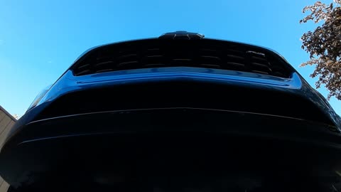

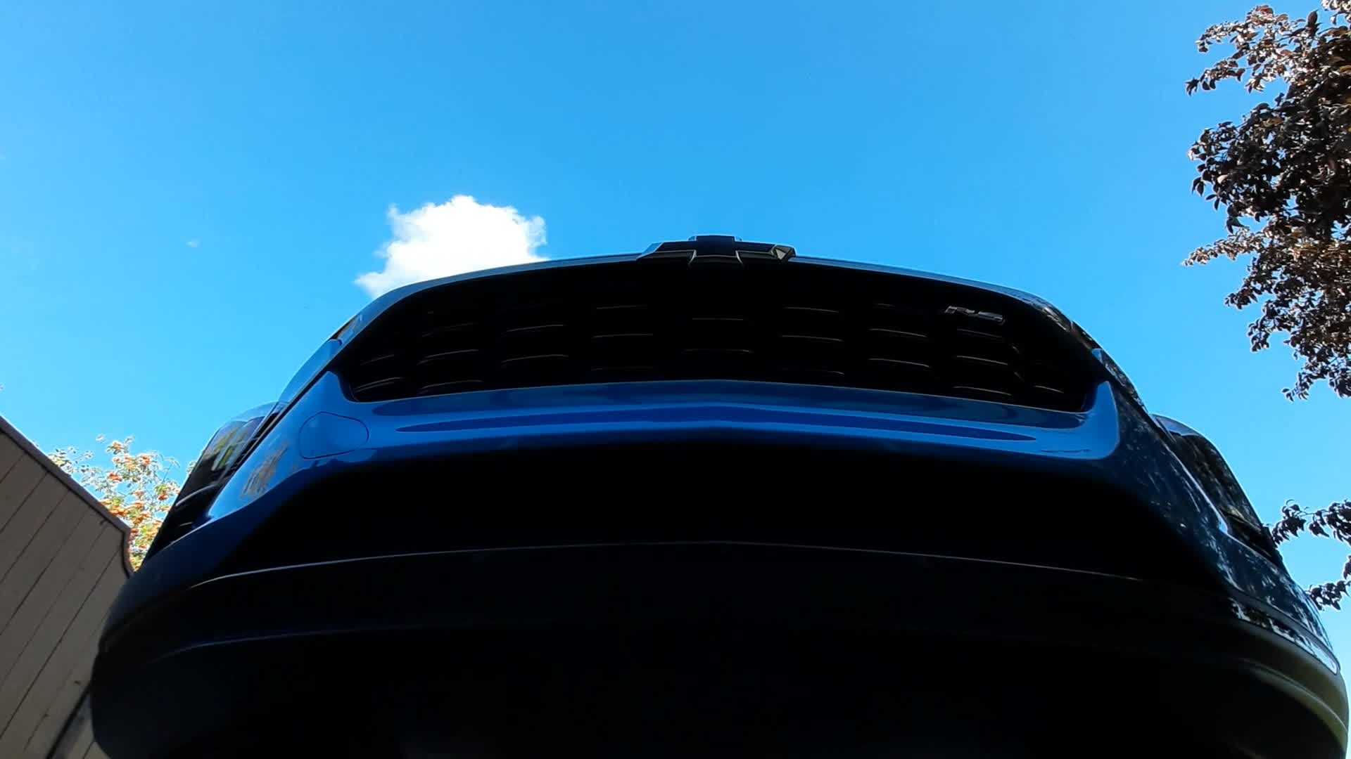

Not sure if this video is of any help.
Sep 18, 2024 at 4:49 PM
  • 54,832 POSTS
Wow, great camera work, do you work for the movie industry? It can be the transmission torque converter if the problem is when the car is sitting still. Do you have any warning lights on? Also, what does the dealer say? Can you get a video of the steering wheel vibration, I can say engine/transmission mounts can cause this issue if you have a defective mount. When the engine is running, put your hand on the top cover to see if it is the same vibration, you feel while driving. (Do not put your hand near moving parts.)
Sep 19, 2024 at 10:07 AM
JASONROGERS1
Thanks. So far, I only feel it in Drive with the car moving. No warning lights. The vibration isn't strong enough to be seen, only felt. Notice it most when there's a gear change during acceleration and the RPM drops down to 1300-1500. Only lasts for a couple of seconds until the rpm climbs back out of that range. I went for a drive with a Chevrolet service advisor, and he thinks it's pretty normal for this vehicle. Guess I won't worry about it for now.
