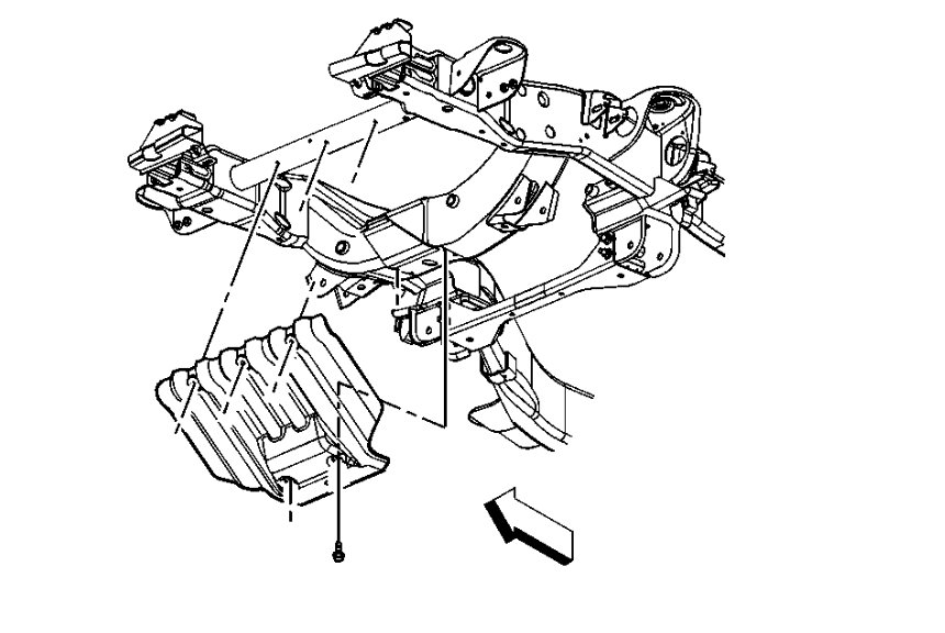

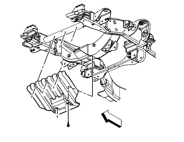

Vibration like rumble strips. Upon letting off of gas and slow down. Goes away upon acceleration.
May 2, 2019 at 5:55 AM
SCGRANTURISMO
  • 4,897 POSTS

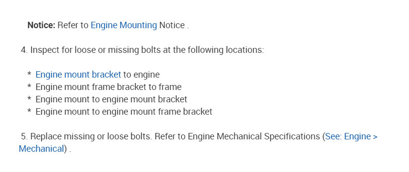

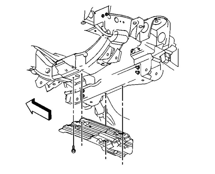

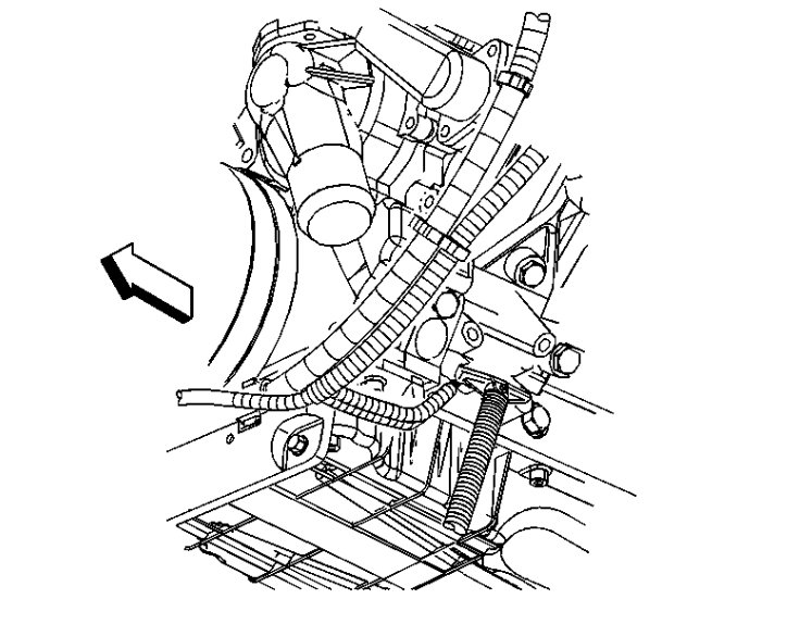

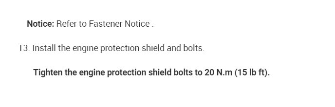

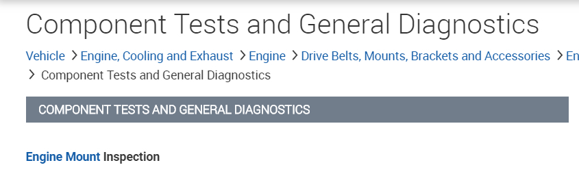

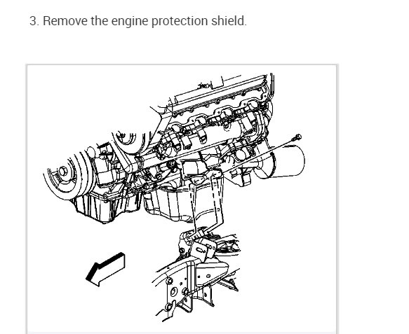

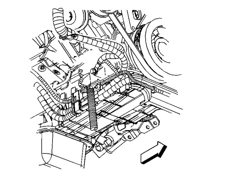

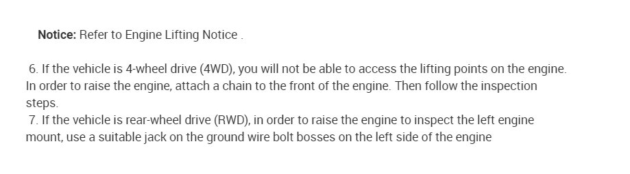

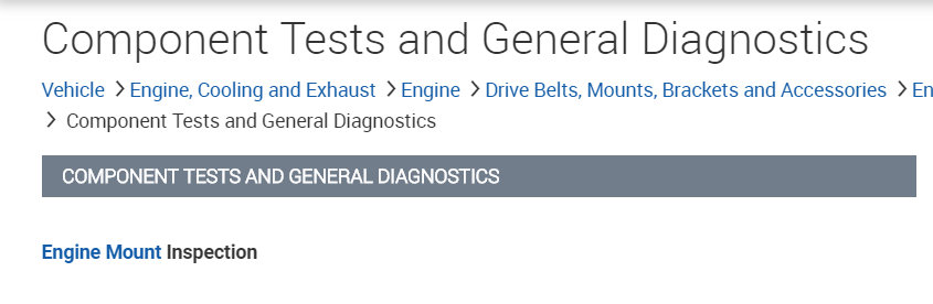

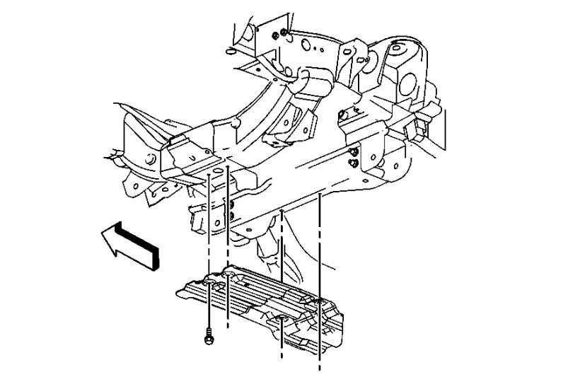

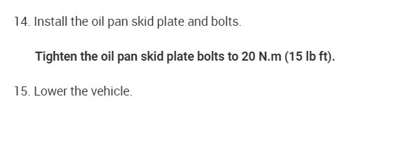

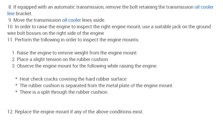

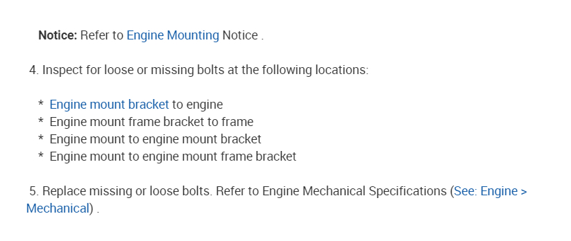

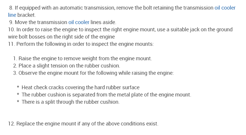

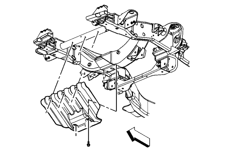

This could be a few different things. Here they are in no apparent order. 1) Wheel bearing(s) 2) U-joint(s) 3) Motor mount(s) 4) Transmission mount(s). So, you probably processed the information like me, start with the easiest first. I have included the information on the motor and transmission mounts in the diagrams down below for you. Please go through the diagnostic guide for the engine mounts and get back to us with what you are able to find out.
Thanks,
Alex
