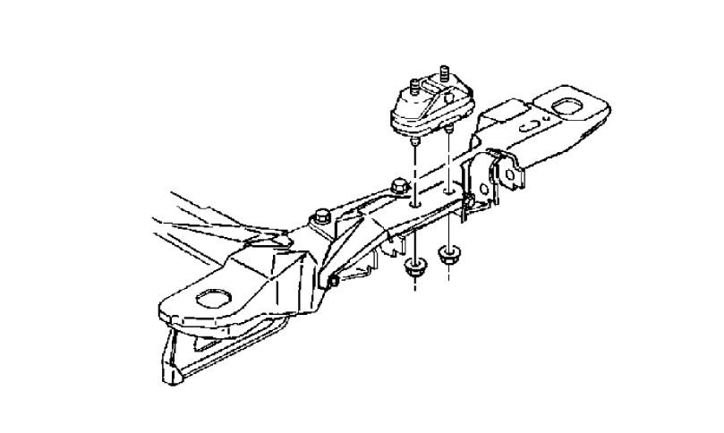

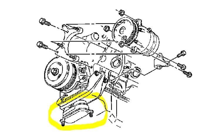

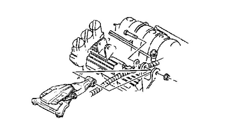

Apr 13, 2019 at 9:18 AM
Are these the mounts you changed? The upper mounts have a left and right.
