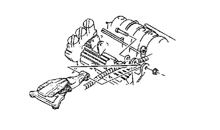

I get a major vibration when accelerating between 45-65 mph. But nothing at any other speed. I’ve had the tires balanced twice and the vibration does not come through the steering wheel but instead it’s just the entire car shaking.

The engine mounts look good and it feels like the front end is vibrating. It doesn’t feel engine related though, but when accelerating at the particular speeds the shaking can get bad enough to where the sound the engine creates fluctuate.

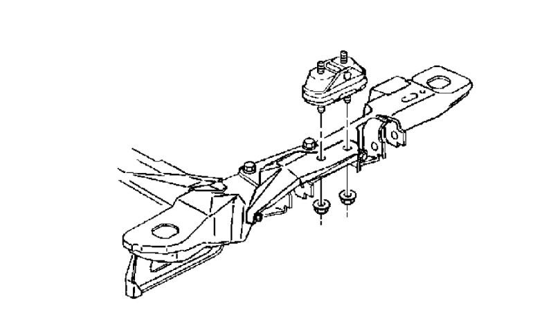

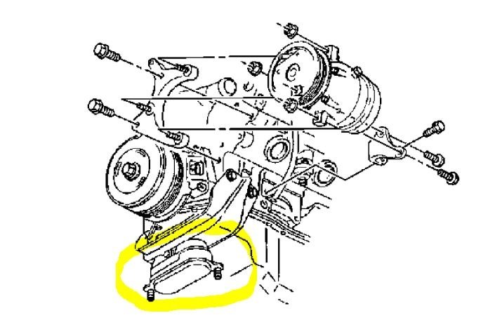

Update: i drove it around a little bit but i decided to open up the hood and give the car a push while in park and it caused the engine to move a good amount. Maybe the engine mounts might be bad?
Apr 12, 2019 at 3:20 PM
Yep, that sounds about right. I attached a guide for you for replacing the mounts.

I went ahead and replaced them. But i don’t think it helped with the vibration. But at least I won’t ever have to replace them again because it probably still needed it. I went ahead and checked transmission fluid and it was at a good level but very dirty.
Apr 13, 2019 at 4:18 PM
Are these the mounts you changed? The upper mounts have a left and right.
