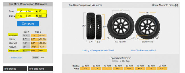

What are the tire sizes on the vehicle (other than the spare)?
Dec 5, 2021 at 7:53 AM
TURFDOG
  • 64 POSTS
195 60 15.
Dec 5, 2021 at 7:54 AM
  • 110,248 POSTS

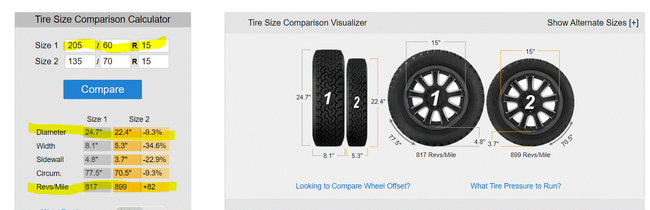

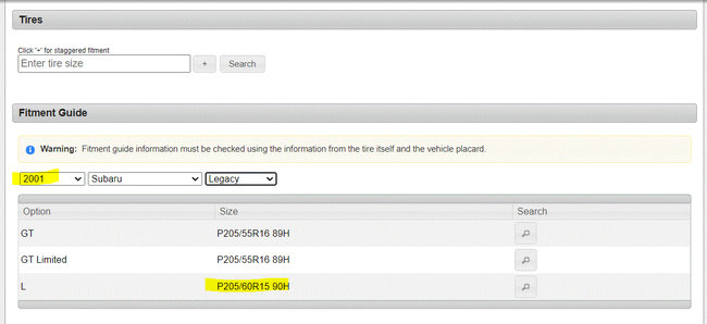

I went to a tire size calculator site and put both sizes in. According to the site, there is a big difference. See attached. I also looked up the original equipment size and it was a 205 60 15. See pic 2. As far as the spare tire, is that the correct size?
I did one final check and that was comparing the OEM size against the spare size provided, and it's totally off as well.
Let me know if that is the OEM spare tire. The company normally provided a tire equal in diameter to the spare. In this case, it doesn't seem they have.

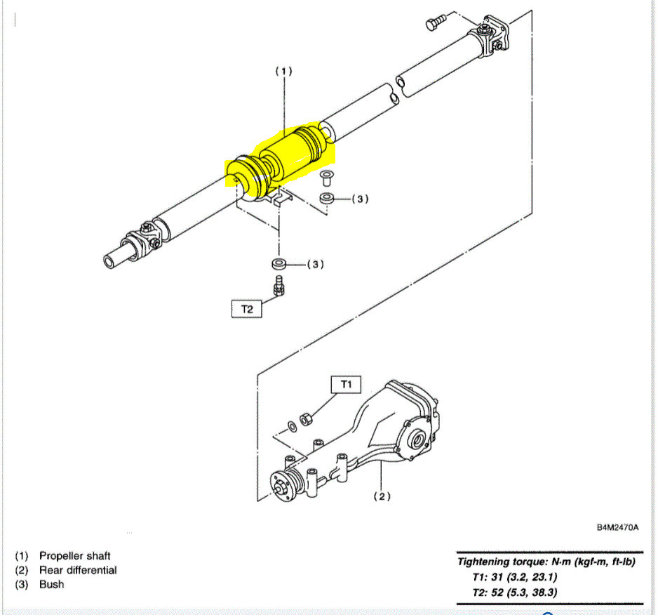

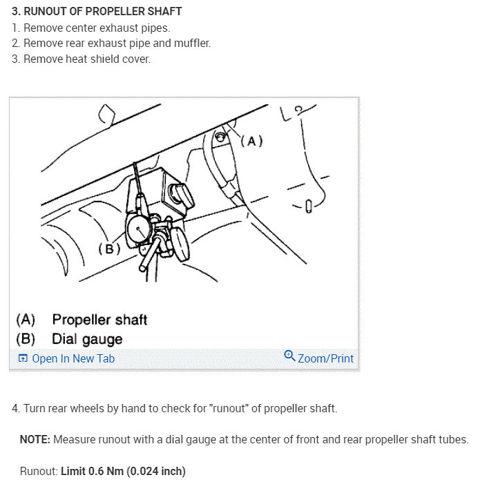

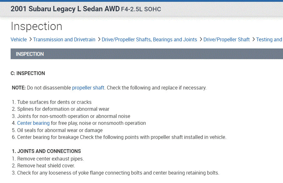

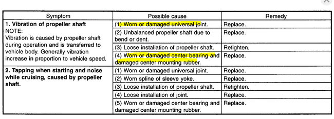

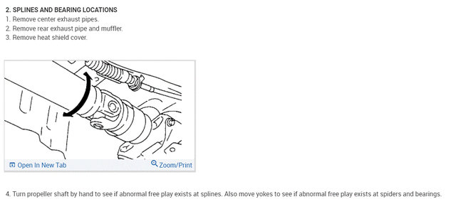

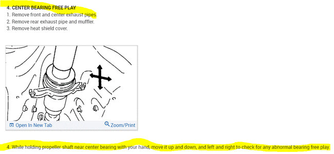

  • 110,248 POSTS
I have a feeling it is related to the driveshaft center bearing. Take a look at the pics below. Pic 1 shows the component I'm referring to. Pic 2 shows possible causes of the symptoms you experience, and the remaining pics are the directions for test/inspecting the driveshaft and components.
Take a look through the directions and let me know if you are comfortable checking it. I highlighted the last test below. I suspect this is where you may find the problem.
See pic below.
