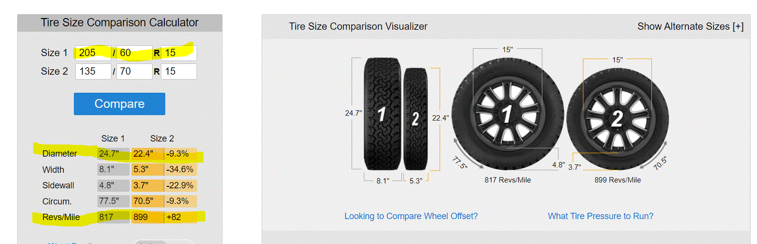

There was no problem with the car before I brought it to the service station. One tire was going completely bald back left driver side. They put on a tired that was 5 mm larger ever since then I’ve been having a vibration in the car now is pretty significant. There was no vibration before that tire was changed. Could a tire 5 mm bigger actually make that much of a problem? Or could I be looking at something else?
Nov 29, 2021 at 1:34 PM
  • 110,194 POSTS
With 4wd, you really need to keep the tires the same size. If they are different, it causes this type of issue. Also, this can damage the differential, transfer case, or transmission.

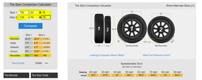

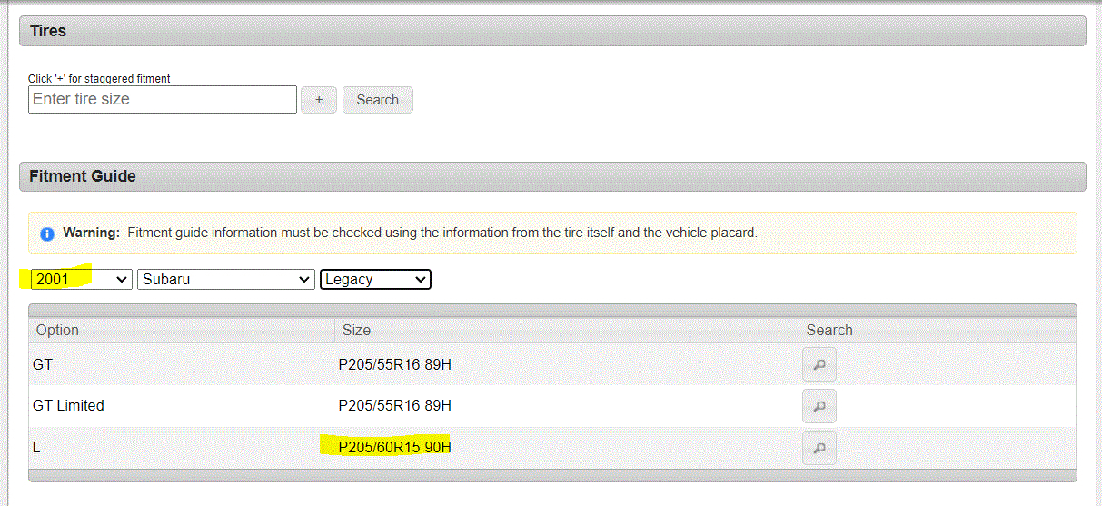

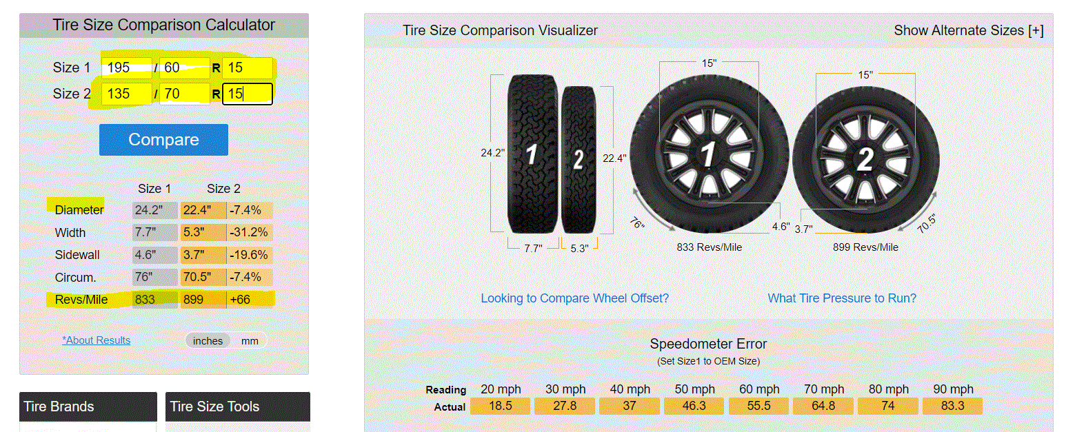

I went to a tire size calculator site and put both sizes in. According to the site, there is a big difference. See attached. I also looked up the original equipment size and it was a 205 60 15. See pic 2. As far as the spare tire, is that the correct size?
I did one final check and that was comparing the OEM size against the spare size provided, and it's totally off as well.
Let me know if that is the OEM spare tire. The company normally provided a tire equal in diameter to the spare. In this case, it doesn't seem they have.

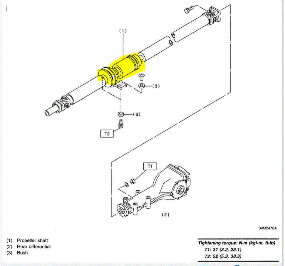

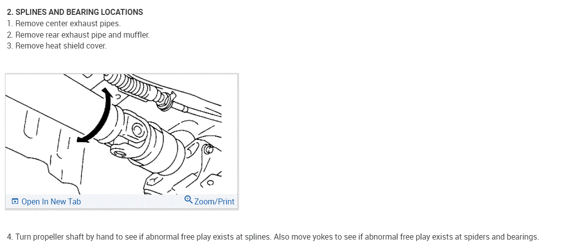

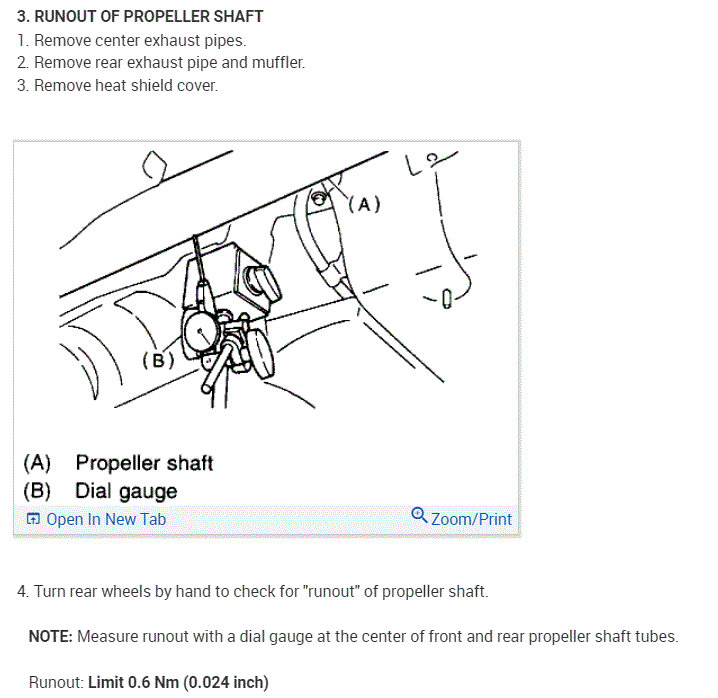

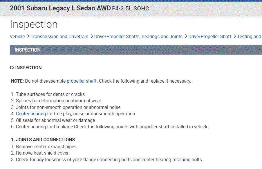

  • 110,194 POSTS

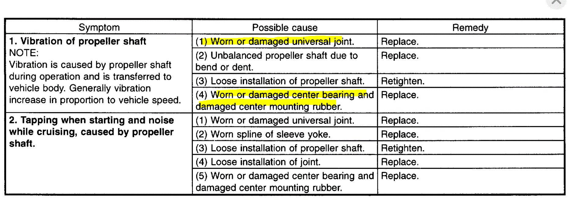

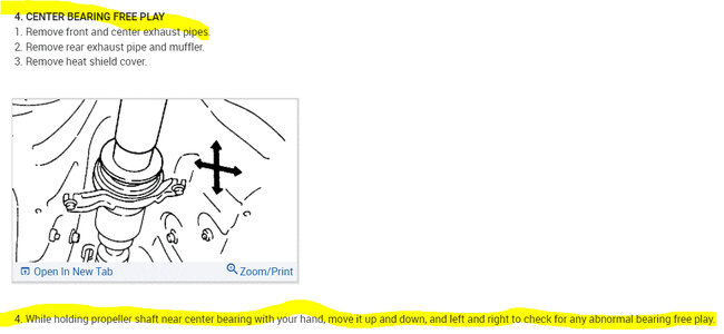

I have a feeling it is related to the driveshaft center bearing. Take a look at the pics below. Pic 1 shows the component I'm referring to. Pic 2 shows possible causes of the symptoms you experience, and the remaining pics are the directions for test/inspecting the driveshaft and components.
Take a look through the directions and let me know if you are comfortable checking it. I highlighted the last test below. I suspect this is where you may find the problem.
See pic below.
