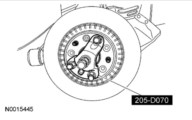

when i drive forty mph sometimes the front passenger side starts vibrating from side to side. I had new tires put on three months ago. put new tie rods on and replaced the control arm on the passenger side.
Sep 12, 2017 at 8:12 AM
  • 55,711 POSTS

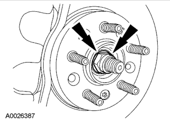

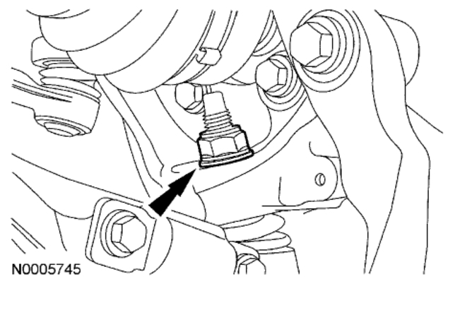

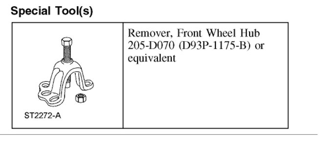

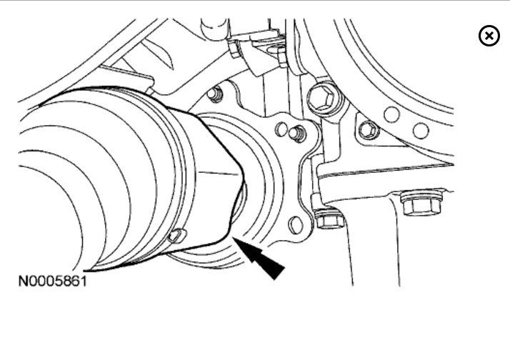

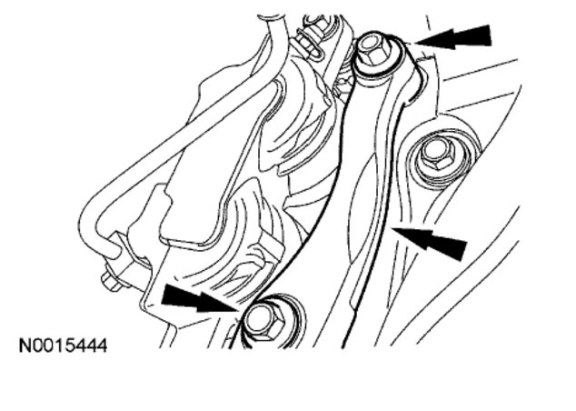

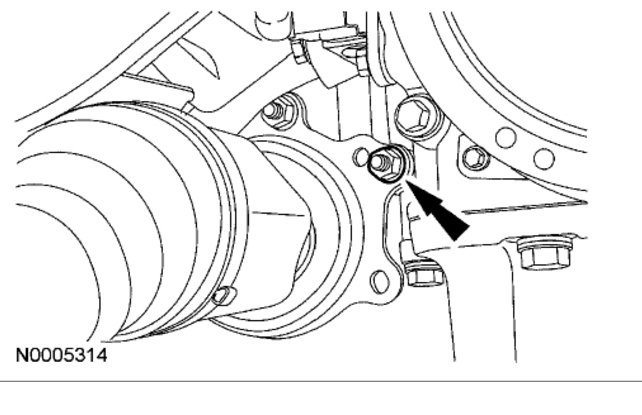

I have seen where the CV axle become worn not allowing smooth rotation which causes a vibration much like you have described. I am assuming you got the entire control arm included the lower ball joint.

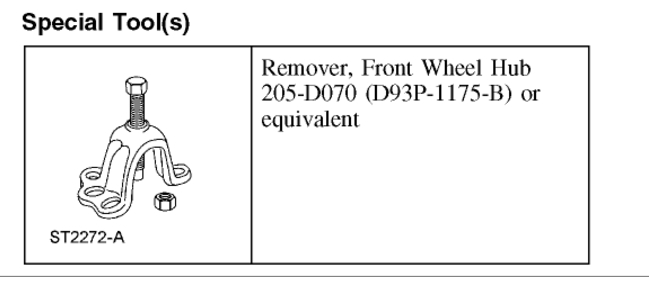

Here is a guide that will help you see what you are in for when changing the axle and some diagrams (below):
https://www.2carpros.com/articles/replace-cv-axle
