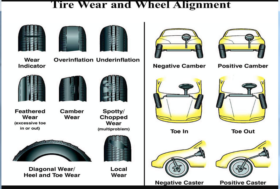

Also we need to check the tires for wear. Here is a guide that will help with that:

Let's get the tires balanced and make sure they check the wheels for out of round and the road force using a road force balance machine and go from there.
Here is an attachment that shows common tire wear issues.
