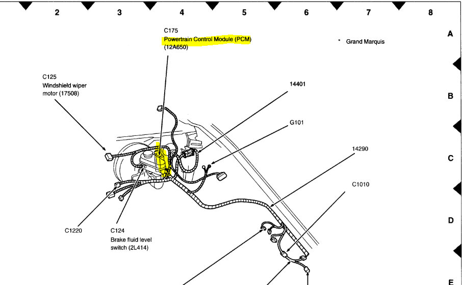

Also, confirm the PCM connectors are tight, clean, and dry. The PCM is located under the hood next to the power brake booster. See pic below
Let me know as much as you can.
See pic below.

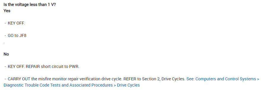

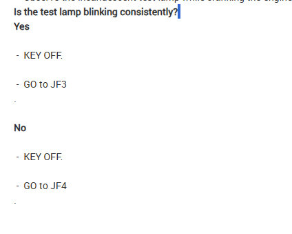

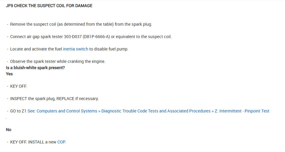

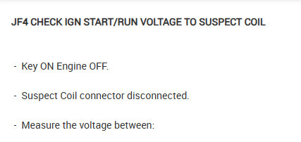

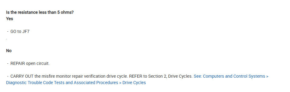

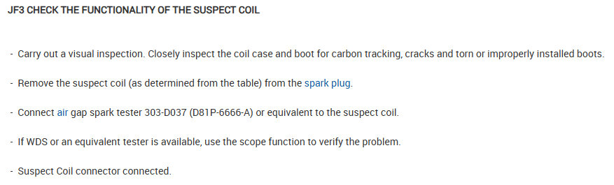

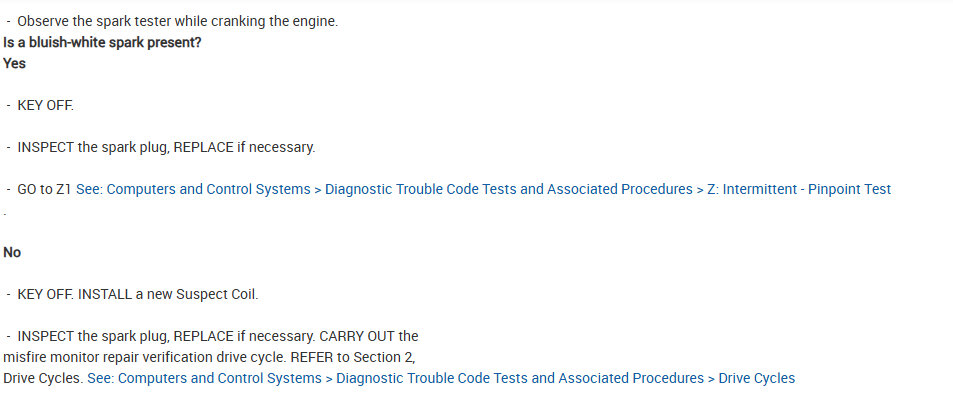

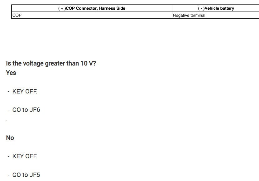

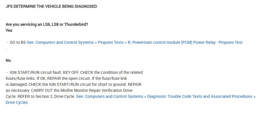

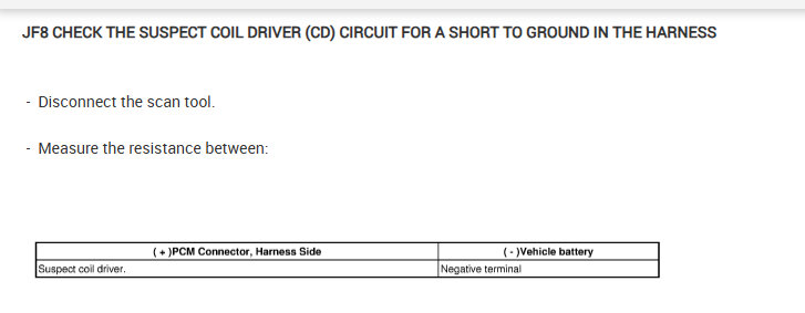

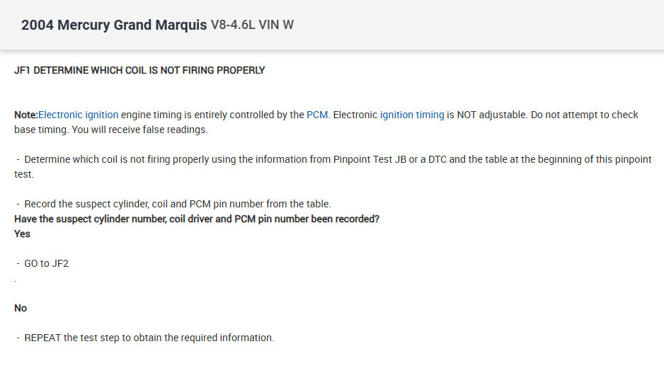

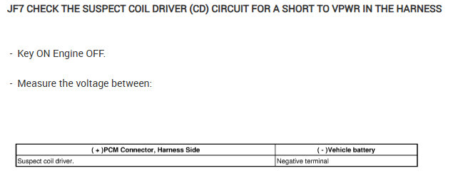

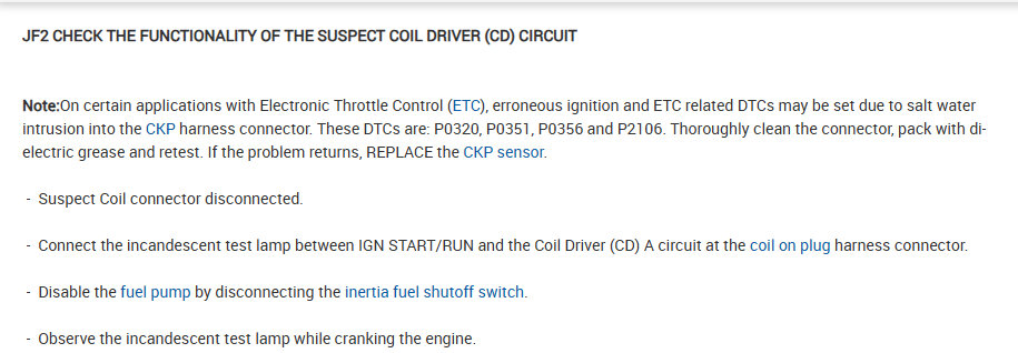

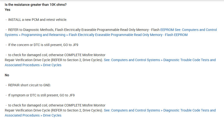

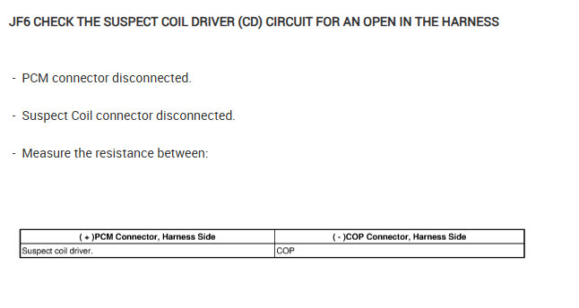

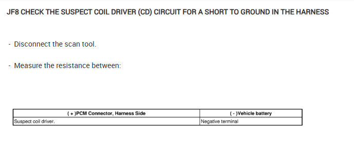

If you look below, I attached the diagnostics for P0354, 355, and 357. The codes all take me to diagnostics JF1 in the manual, which I attached below.
Take a look through them and let me know if you are comfortable performing them.

Also, I would clear the codes, then start the engine for about 5 seconds and then run the codes again, this will give us the most relevant code to fix first, also, I would check the spark plugs, I have seen a spark plug get cracked and cause these codes.
