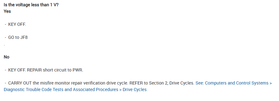

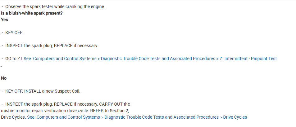

The codes you have are all related to ignition coils. Have you tried moving them around to see if the codes change? Are you experiencing misfires while the engine is running?

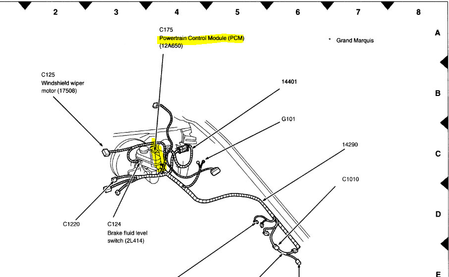

Also, confirm the PCM connectors are tight, clean, and dry. The PCM is located under the hood next to the power brake booster. See pic below
Let me know as much as you can.
See pic below.

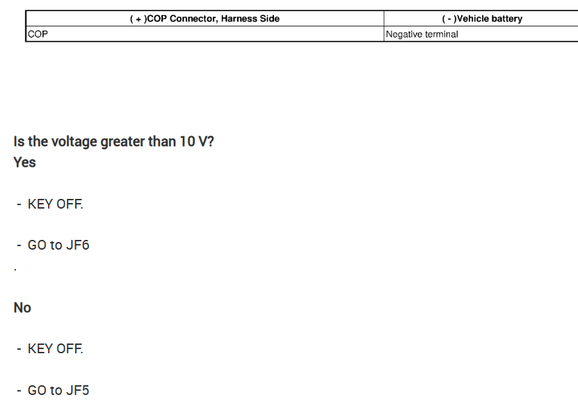

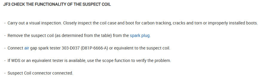

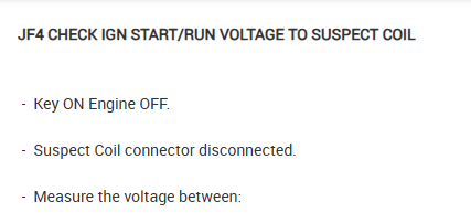

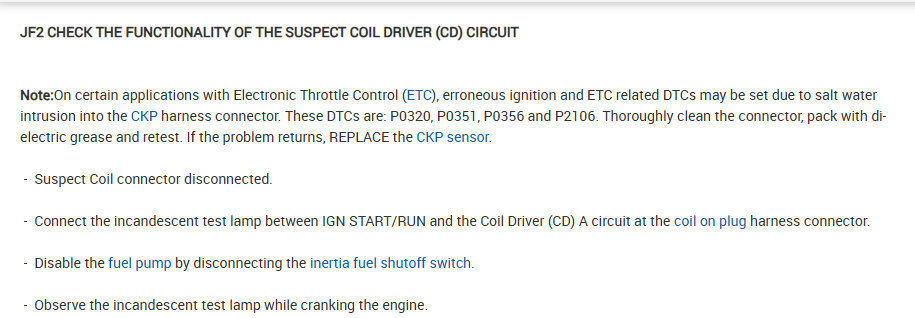

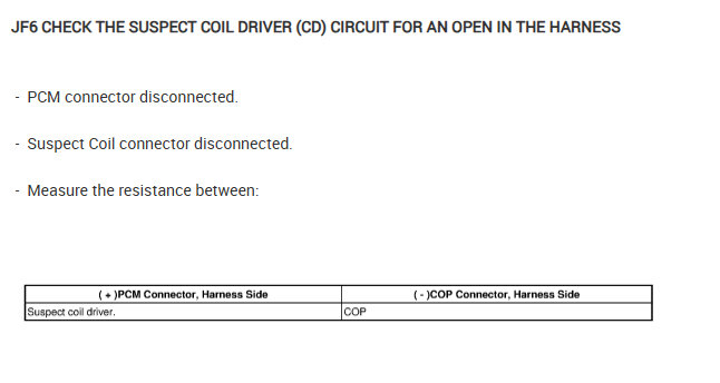

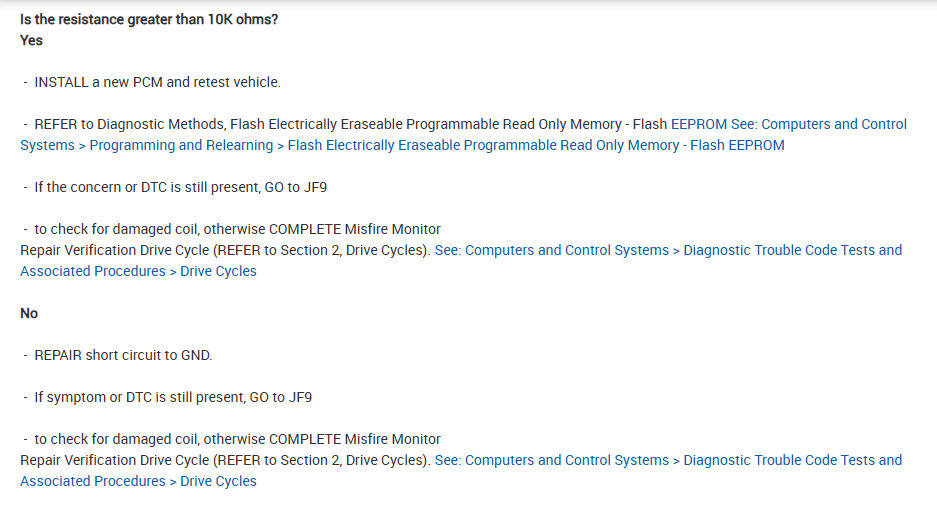

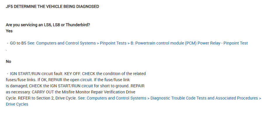

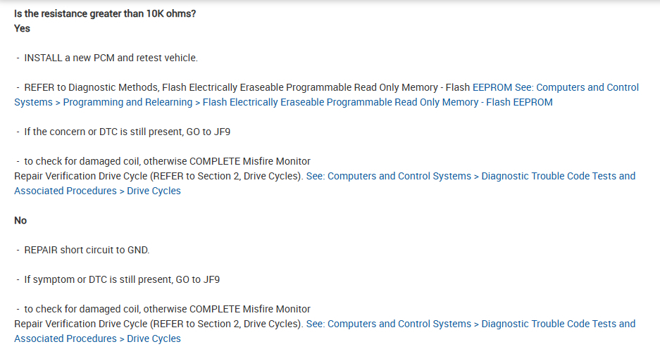

If all coils are replaced, I don't think that would be the issue. It could be related to the drivers in the PCM, but the only way to confirm is to perform diagnostics.

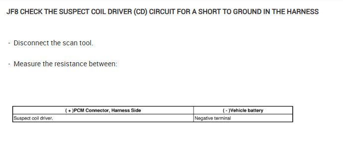

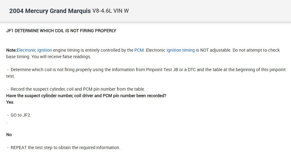

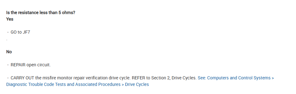

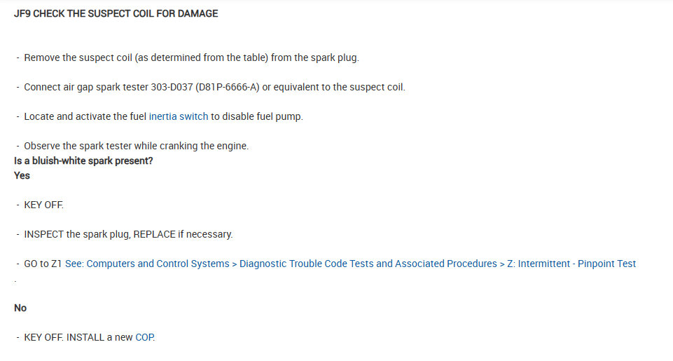

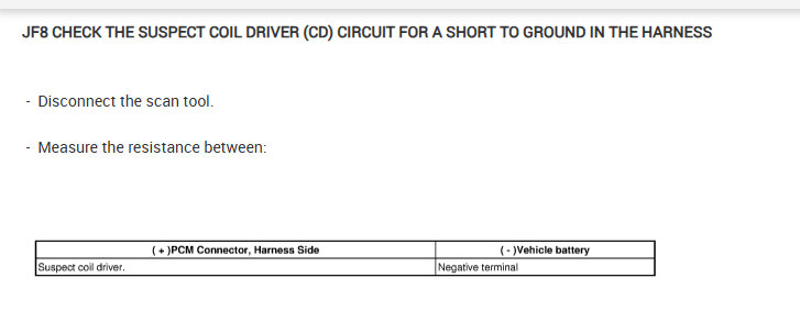

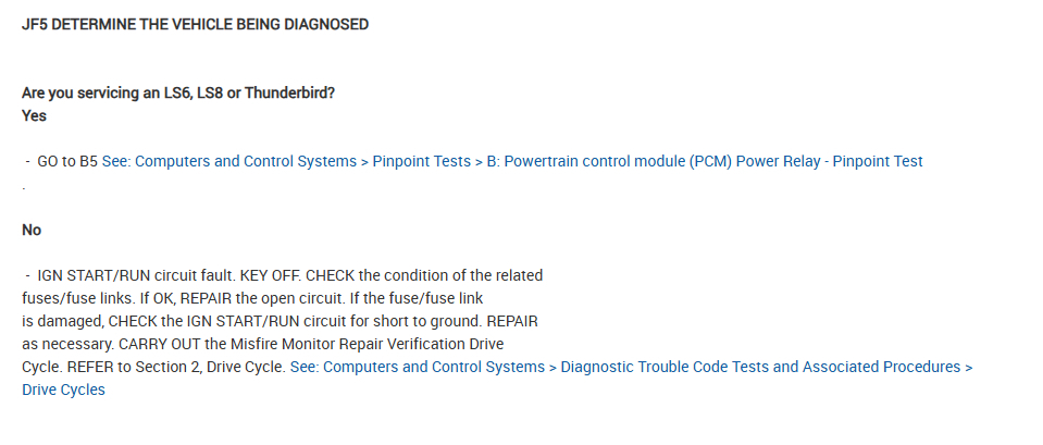

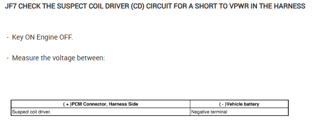

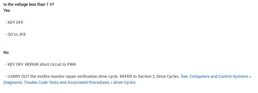

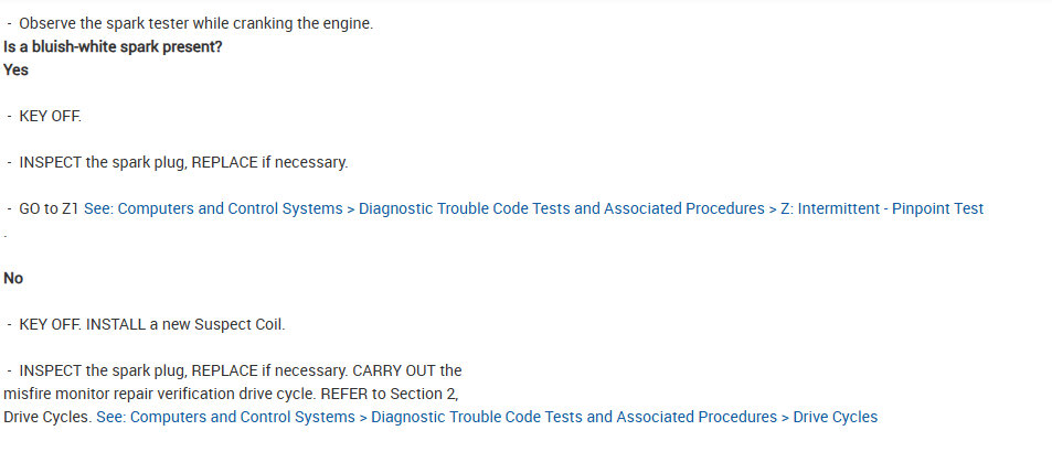

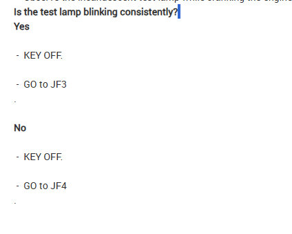

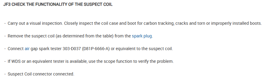

If you look below, I attached the diagnostics for P0354, 355, and 357. The codes all take me to diagnostics JF1 in the manual, which I attached below.
Take a look through them and let me know if you are comfortable performing them.
