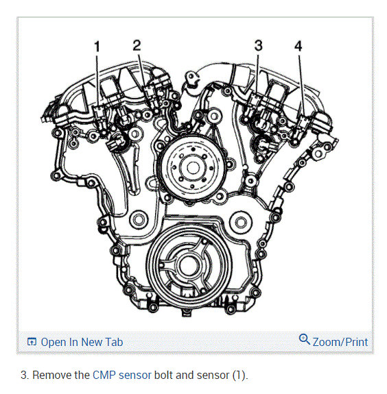

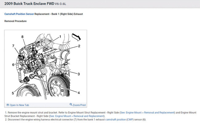

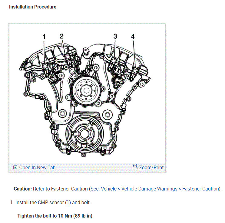

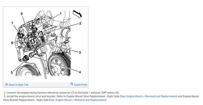

Okay, the cam sensor is bank one, exhaust. If you look at the attachments below, they include the directions and pictures specific to this vehicle for replacement.
Once that is replaced, let me know the results. If it still is lacking power, try removing the oxygen sensors before the catalytic converters to see if it makes a power difference. If it does, then we have a plugged converter.
Take a look at this link as well:
See pics below
