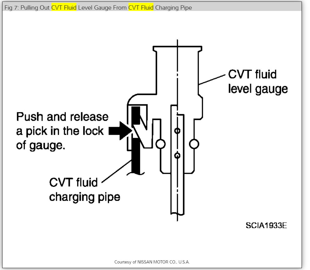

Car will rev up the rpm's in park and neutral but just will move in gears. Could it be in limp mode or safe mode or it something more serious? Need your help thanks!
Dec 7, 2017 at 8:38 PM
  • 55,748 POSTS

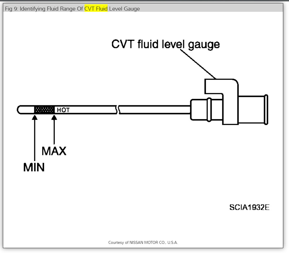

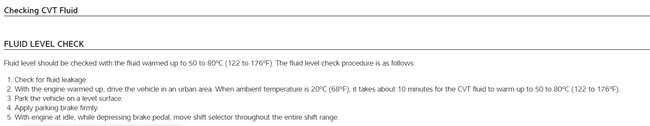

It sounds like the transmission is low on fluid which will make it slip.
Here is a guide that will help you see how what you are in for when checking it:
This car has a CVT transmission which have problems (FYI).
Below are diagrams on how to check it in your car.
