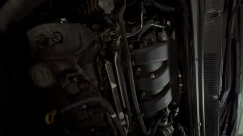

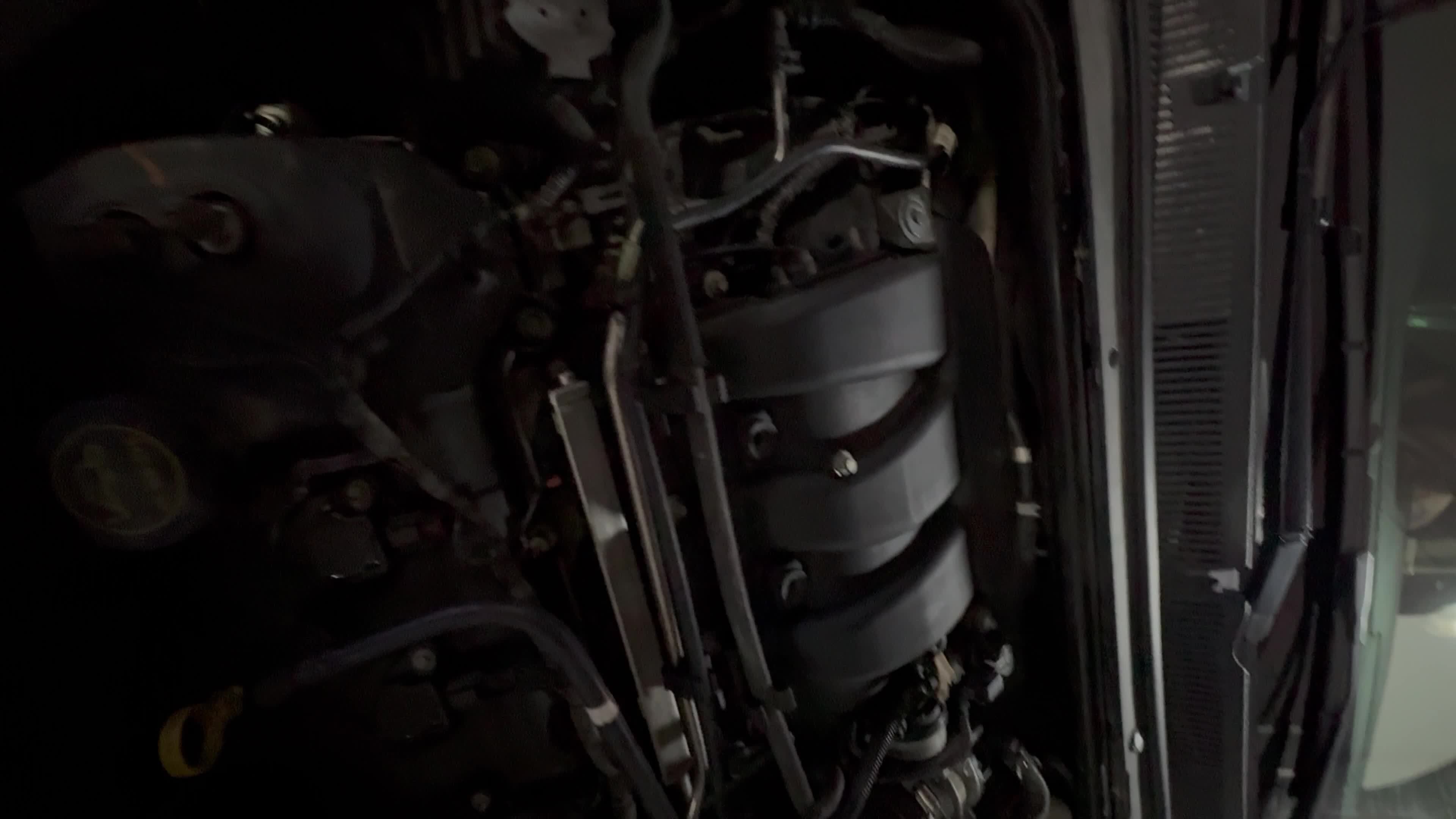

Here is another engine bay footage showing how vigorously the engine shakes on start up.

The trims look good. As far as the crankshaft position sensor is concerned, it is more likely to cause problems when the engine is at operating temperature.

It ended up being the flooding of one or two of the cylinders due to a leak in the injectors.
The hard start and potent vibration had accounted for the same and due to such the engine had trouble starting on that note, the effect was unnoticeable/ negligent whilst driving due to the existent process of burning the fuel in the engine.
