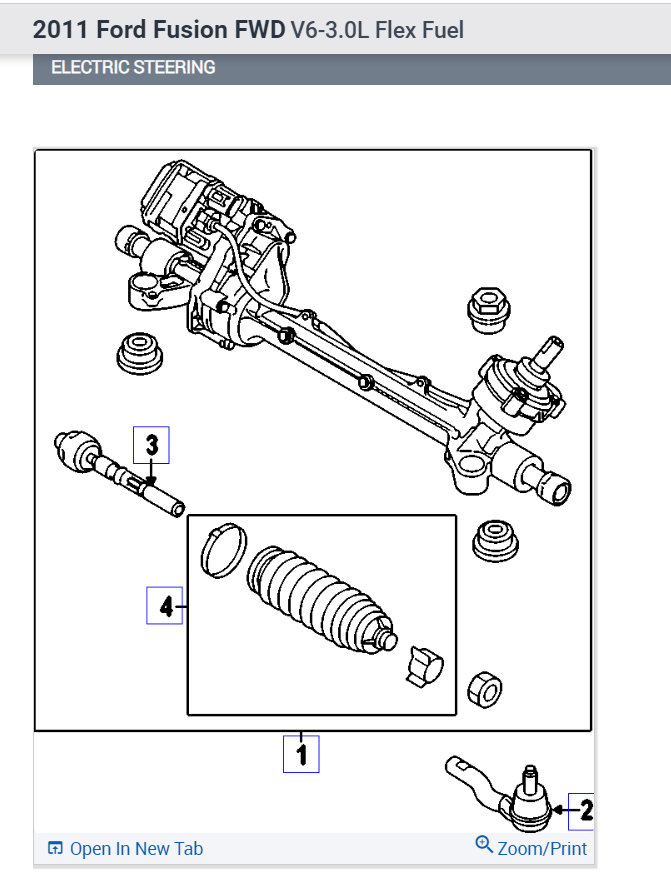

Very difficult to turn the steering wheel?
2011 FORD FUSION
60,000 MILES
ROZ NOVAK

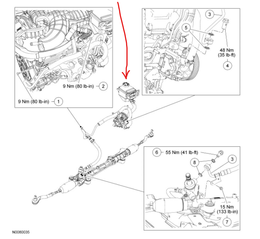

Car has not been driven very much in the last two years. I just put in a new battery. Car starts fine. Steering is very difficult.
Aug 25, 2022 at 1:26 AM
  • 55,399 POSTS

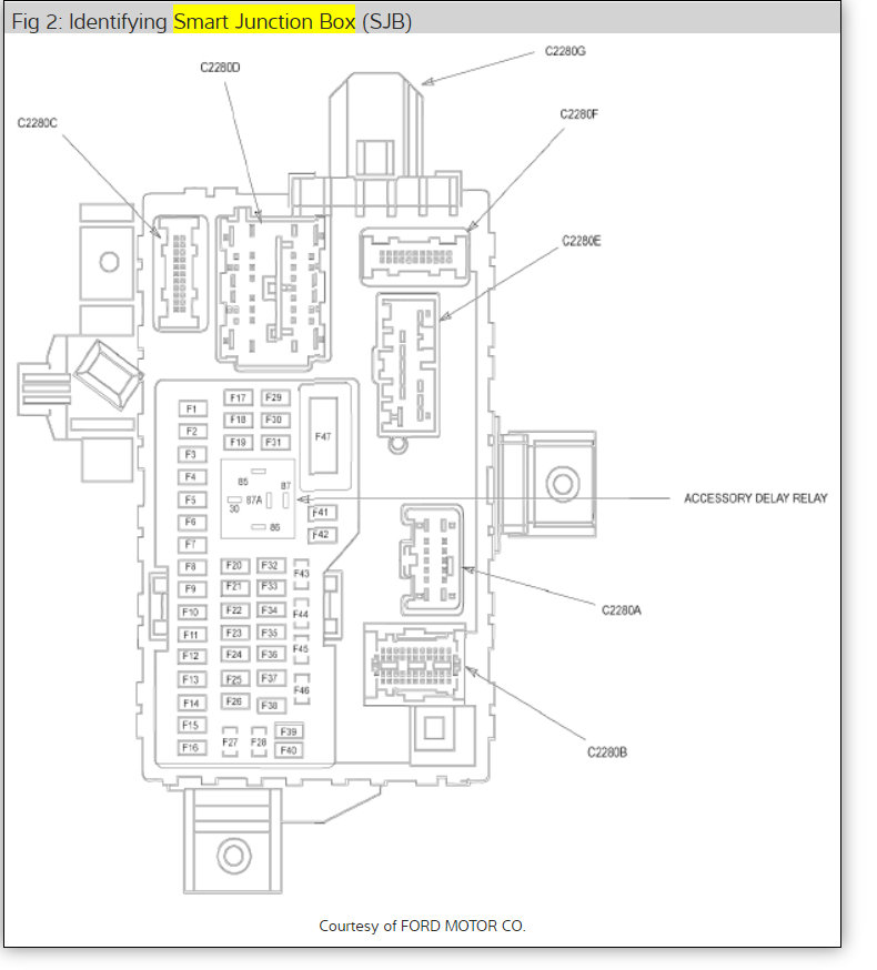

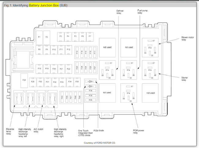

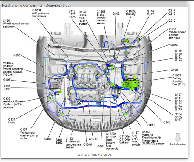

This car can have either hydraulic assisted steering or electric. If you have a power steering pump on the engine it is hydraulic, please remove the cap and check the fluid level. Here is how in the diagrams below. If no pump is seen, then the car has an electric system in which case the steering rack will probably need to be replaced but you should check the fuses first.
Here is a guide for that as well:

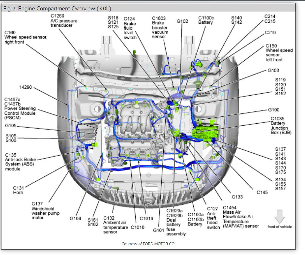

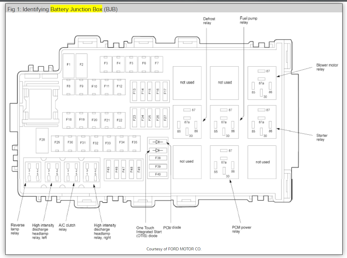

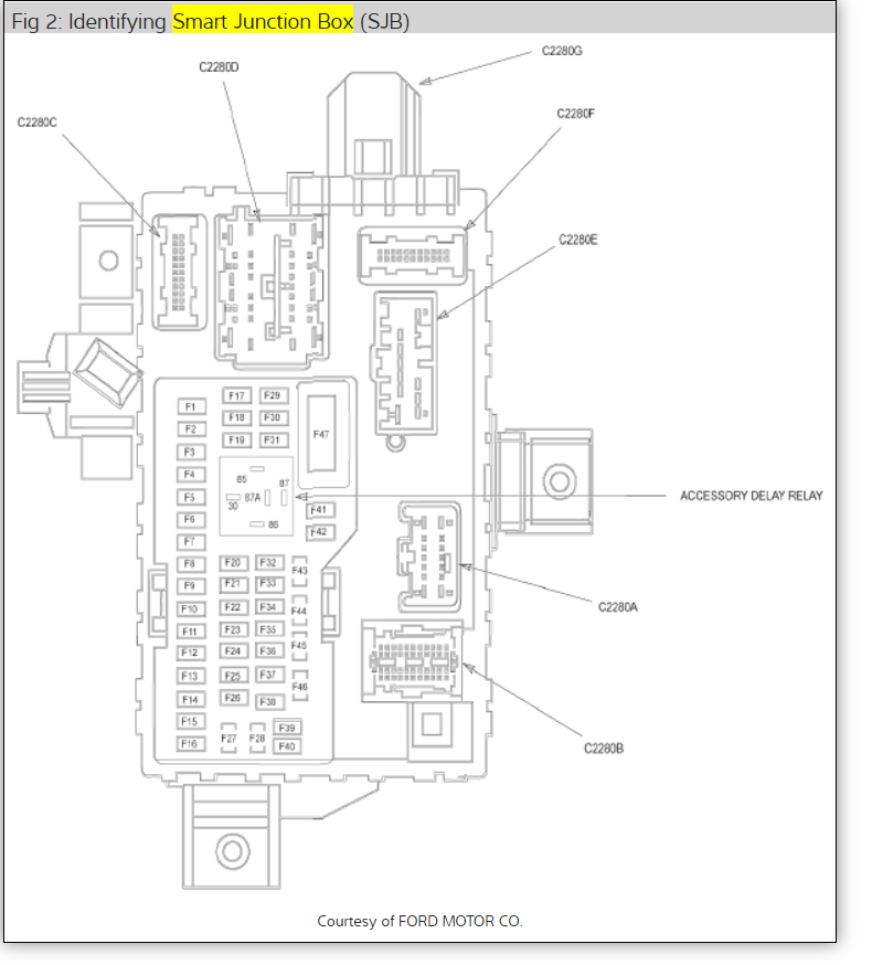

Here are the fuse locations in the images below with the additional images from above. Check the fuses with the key on engine off. Check out the diagrams (below). Please let us know what you find.
