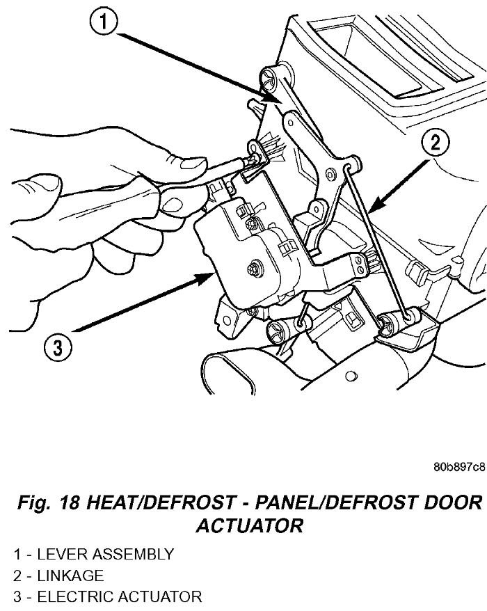

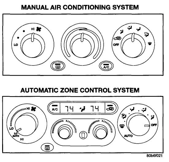

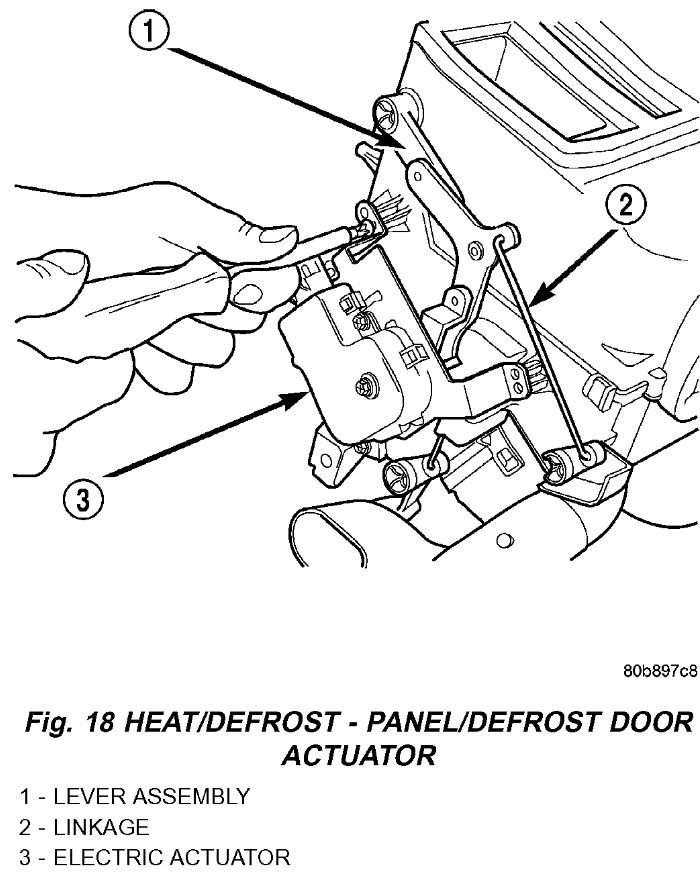

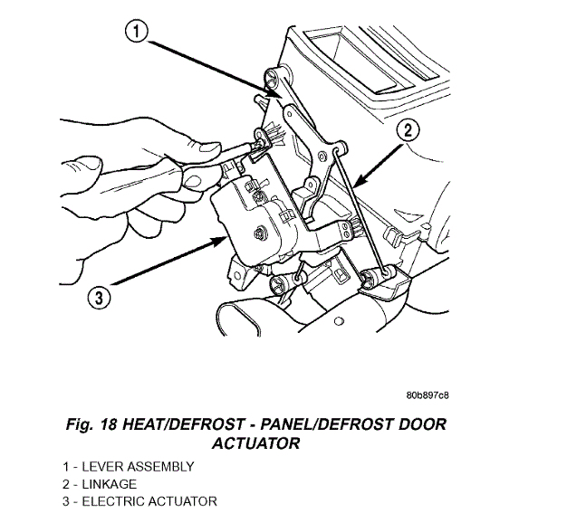

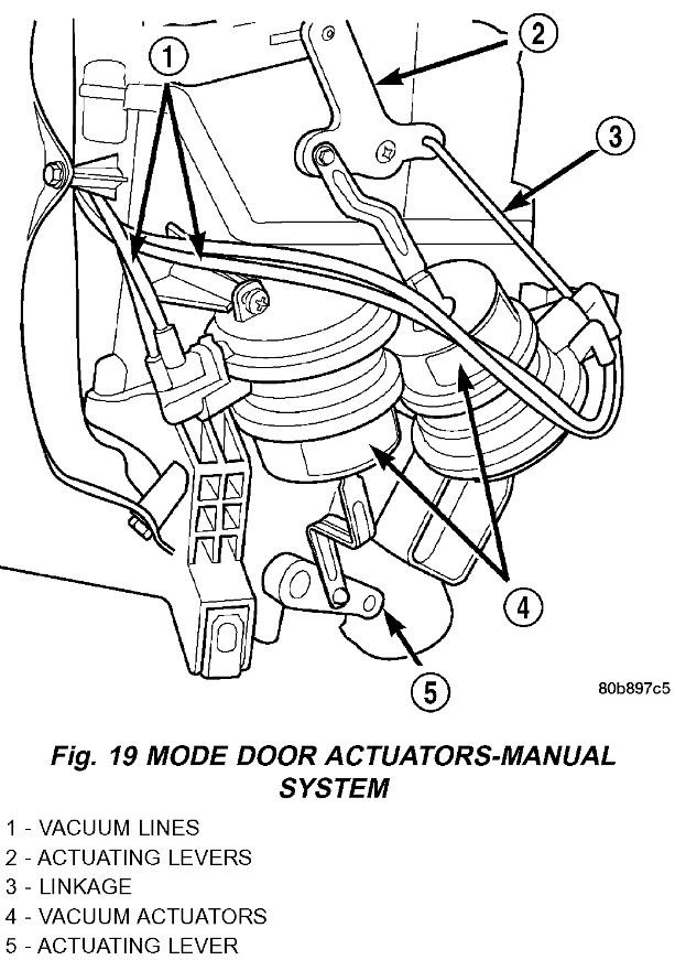

That sounds like either the mode control actuator failed or the linkage arm has broken, both are common failure modes. The location of the control(s) depends on which system you have. Either manual or the automatic controls as shown in the first image If you have the up-level option where you have a temperature selector for both sides, that version uses an electronic actuator that is mounted to the passenger side of the HVAC housing behind the central brace for the instrument panel as in the second image. You remove the brace under the dash to get to the actuator and the linkage.
If you have the 3 dial control with only one temperature control it becomes much more difficult as it uses two different actuators to control defrost. To access both you need to remove the HVAC case from the vehicle. Before doing that I would do some testing to be sure it isn't just a bad vacuum line or control. Do you hear any hissing while selecting the floor or other modes?

Good afternoon,
I attached the instructions below for you for the actuator.
What is the issue with the actuator?
REMOVAL
Heat/Defrost - Panel/defrost Door Electric Actuator
WARNING: on vehicles equipped with airbags, disable the airbag system before attempting any steering wheel, steering column, or instrument panel component diagnosis or service. Disconnect and isolate the battery negative (ground) cable, then wait two minutes for the airbag system capacitor to discharge before performing further diagnosis or service. This is the only sure way to disable the airbag system. Failure to take the proper precautions could result in an accidental airbag deployment and possible personal injury.
These actuators are used only on models equipped with the optional Automatic Zone Control (AZC) system.
1. Disconnect and isolate the battery negative cable.
2. Remove the two bolts that secure the center instrument panel support bracket to the left side of the floor panel transmission tunnel.
3. Remove the two bolts that secure the center instrument panel support bracket to the instrument panel.
4. Remove the center instrument panel support bracket from the vehicle.
Fig.18 Heat/Defrost - Panel/Defrost Door Actuator
5. Unplug the wire harness connector from the heat/defrost - panel/defrost door actuator.
6. Remove the three screws that secure the heat/ defrost-panel/defrost door motor to the HVAC housing.
7. Remove the heat/defrost-panel/defrost door motor from the HVAC housing

Which controls do you have the manual control or the automatic? Makes a big difference in the next steps.
Aug 4, 2020 at 6:14 AM
WRA357
  • 5 POSTS
manual.
Aug 4, 2020 at 11:49 PM
STEVE W.
  • 15,352 POSTS

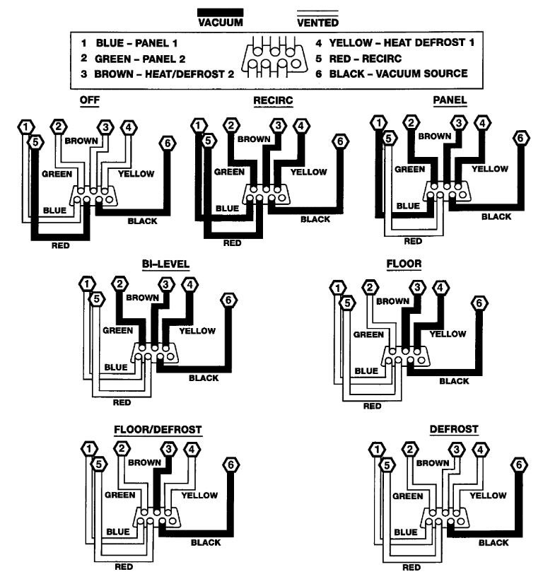

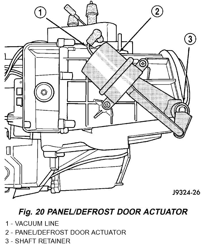

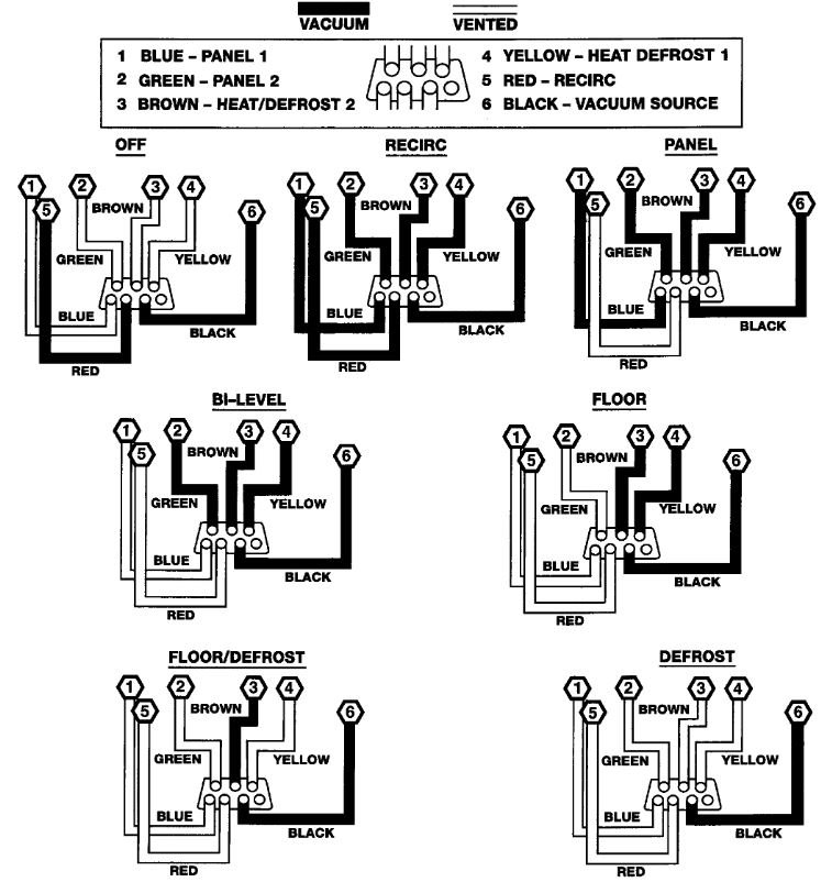

Manual controls means your vehicle uses vacuum actuators for the mode controls instead of the electronic ones. It uses an electronic one for the temperature only. You say you have hot and cold control but cannot switch the air from defrost to floor or dash correct? In that case I would first start by starting the engine then listening inside the car close to the dash for any hissing sound from a broken or loose vacuum line, it will be very faint but you may hear it. Next would be to look under the hood for a broken or loose vacuum line, normally if it was off you would have a slightly higher idle but not always.

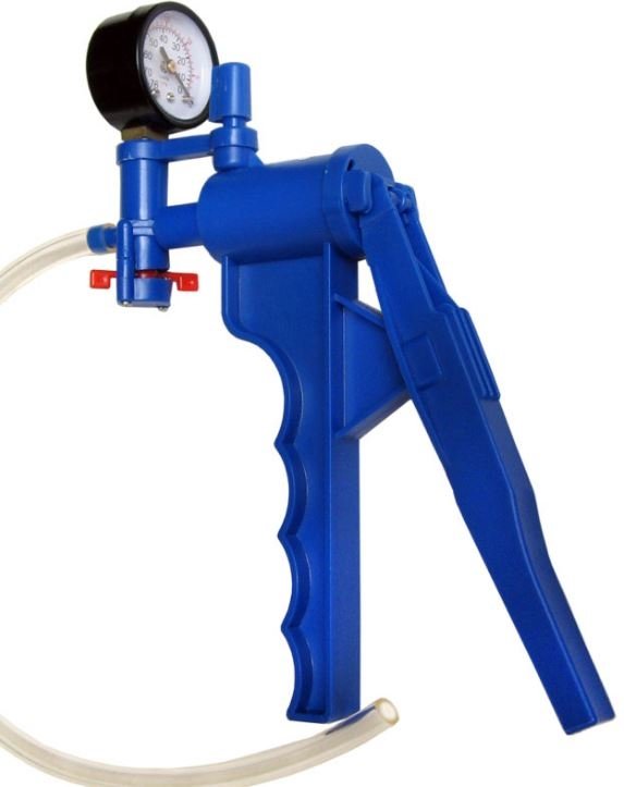

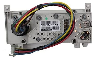

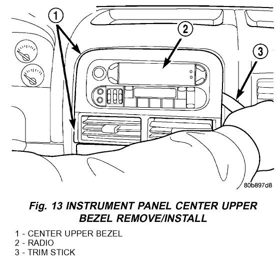

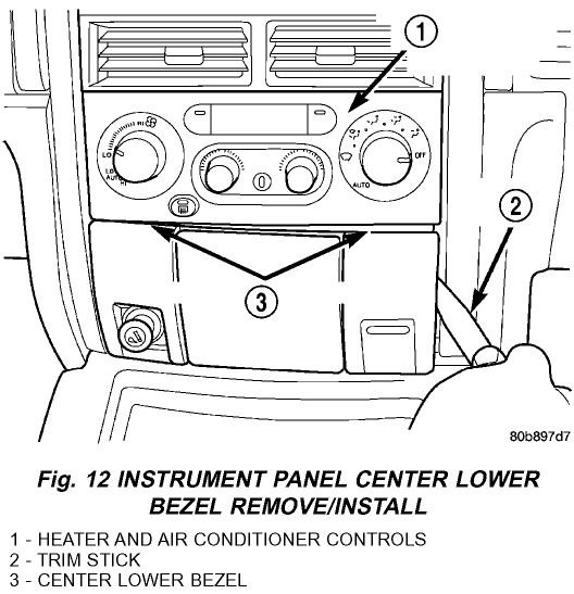

If you hear no leaks the next step starts by removing the trim pieces above and below the heater control panel so you can access the screws that hold the panel in. They are held in with trim clips and you remove them by prying the clips free with a trim stick. Once the trim is out there are 4 screws that hold the control head in place. Remove those and pull the control head out. With it out you will see the vacuum lines from it and the connection they make to the vehicle. Disconnect the vacuum line connection only, not the electrical connection. Now you will need a hand held vacuum pump with a gauge on it.
With it you can test the system to see if it is a bad actuator or the control head by using the gauge to check for vacuum at the black hose that you disconnected from the control head. If you have vacuum there then you can use the vacuum pump to apply vacuum to the Brown and yellow hose nipples. Those control the defrost actuators. With the key on and the blower on you should be able to change the airs movement if you apply vacuum to each fitting. Now you can also watch the gauge on the pump. If you apply vacuum to say the Yellow line and it shows a vacuum but the airflow doesn't change it is likely the linkage is the problem and not the actuator. If however you start pumping and nothing happens and the gauge doesn't move it is either a bad vacuum line or bad actuator. That will require further work. Unfortunately on this vehicle it means the dash assembly has to be removed to be able to access the HVAC case and remove it because the actuators are between it and the firewall.

Thank you for your advice. I forgot to mention this; for a while when it wouldn't let me switch the setting from defrost to anywhere else, (if I turned the control up for the airflow) you could hear something rattling really bad, like something was in there flipping around. It doesn't do that anymore.. it's like it landed somewhere and stayed there. I'm going to run into town and try to buy a hand held vacuum pump and try to get these steps done.
Aug 5, 2020 at 5:25 AM
