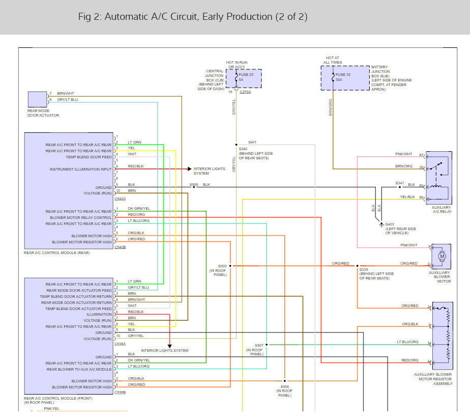

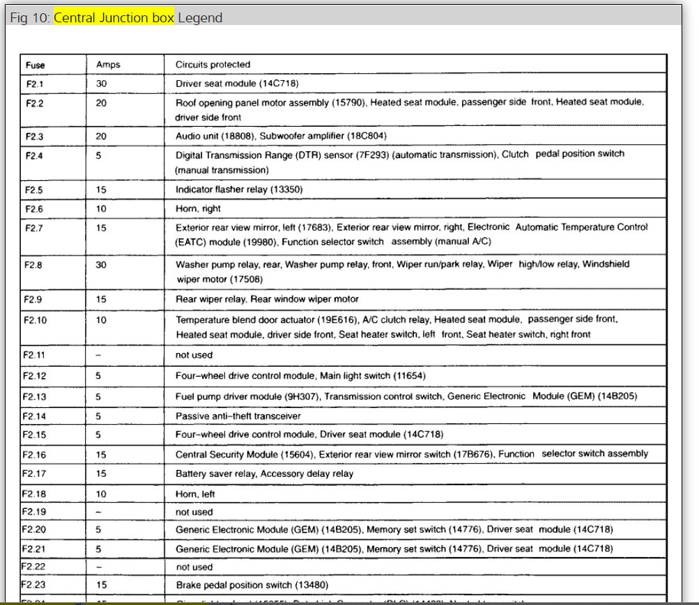

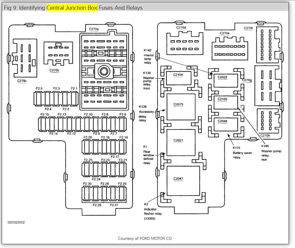

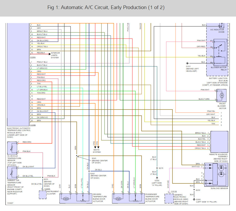

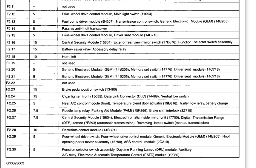

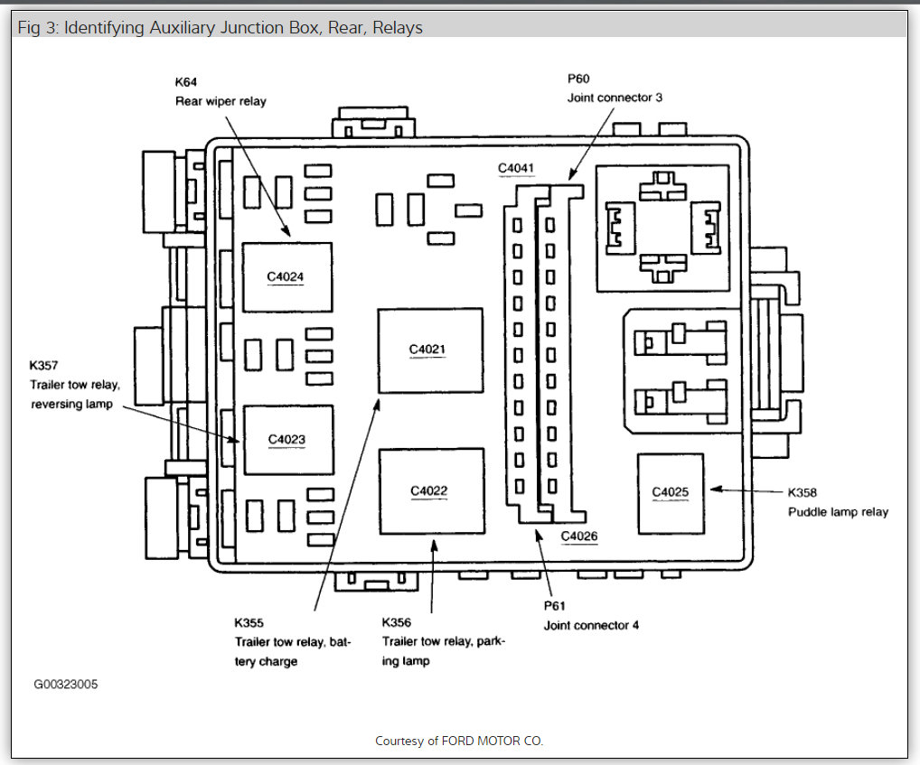

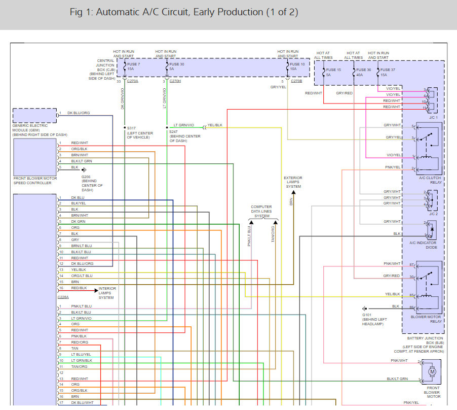

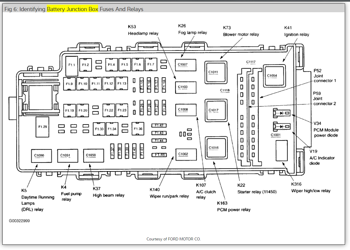

Was driving and the head unit to the ventilation system (AC and heater) lost power, including the rear AC. I have checked every fuse in the cabin and under the hood and they all seem fine. Am I missing a fuse or relay somewhere?
Jan 10, 2018 at 11:39 AM
  • 55,647 POSTS

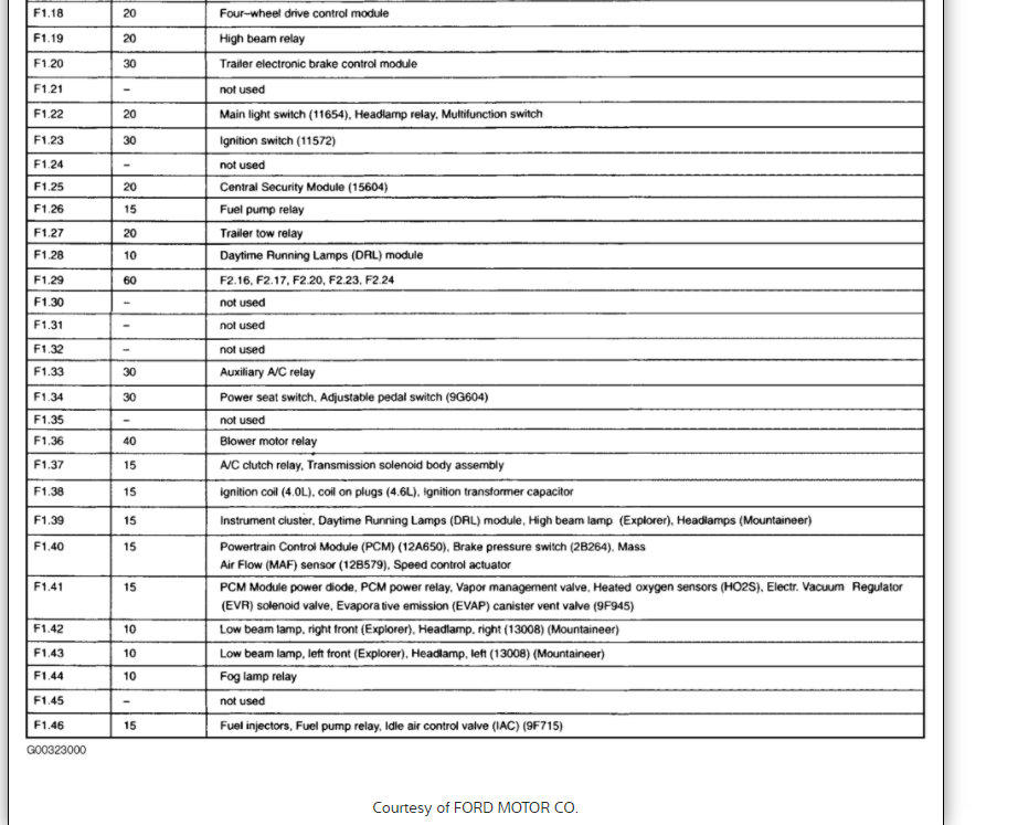

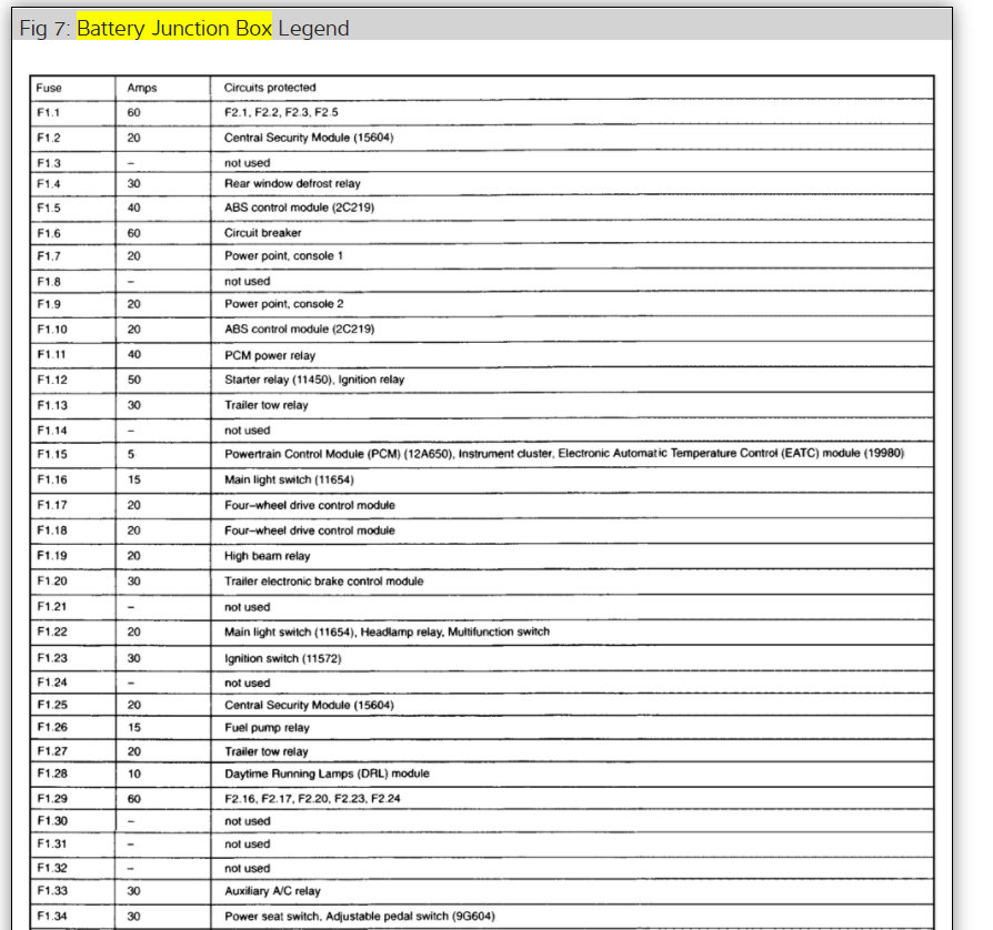

There are several fuses that run the system and a blower motor relay.
Here are guides to help us find the problem:
Check for power at the fuses as well.

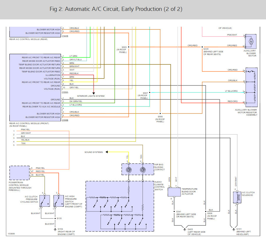

Below are the air conditioner wiring diagrams and the fuse panel location see where you are losing power.
Please run this test and get back to us.
