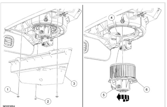

vent fans stopped working?
50,000 MILES • V6 • 2WD • AUTOMATIC
JIMMYJIMMY
There was a clicking sound at one point. Then there would be cycles of heavy to normal blowing. Now there's no blowing at all.
Oct 2, 2025 at 4:49 PM
  • 55,616 POSTS
Sorry for the repeat, the site had an issue but it is fixed now. Yep, this is typical when the blower motor and speed control module go out (these are made together), you will need to remove the under panel on the passengers side to replace the part. Check out the images (below). Let us know how it goes.
