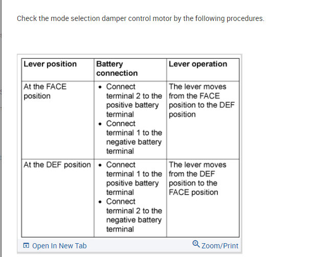

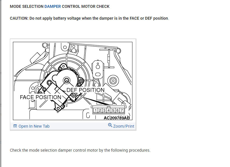

My compressor works fine I can hear it turning on when engaged. My vent doors are stuck on defrost and the vehicle doesn't have a blend door actuator. I do not know what to do, but it's hot.
Jun 16, 2021 at 1:50 AM
You are correct in the idea of a blend door but this is called a mode door actuator.
Here is a guide that will help with step by step instructions on this:
https://www.2carpros.com/articles/air-vents-stay-in-the-defrost-position
Below you will find the info from the manual on the mode door. Take a look at this and let us know if you have questions. Thanks
