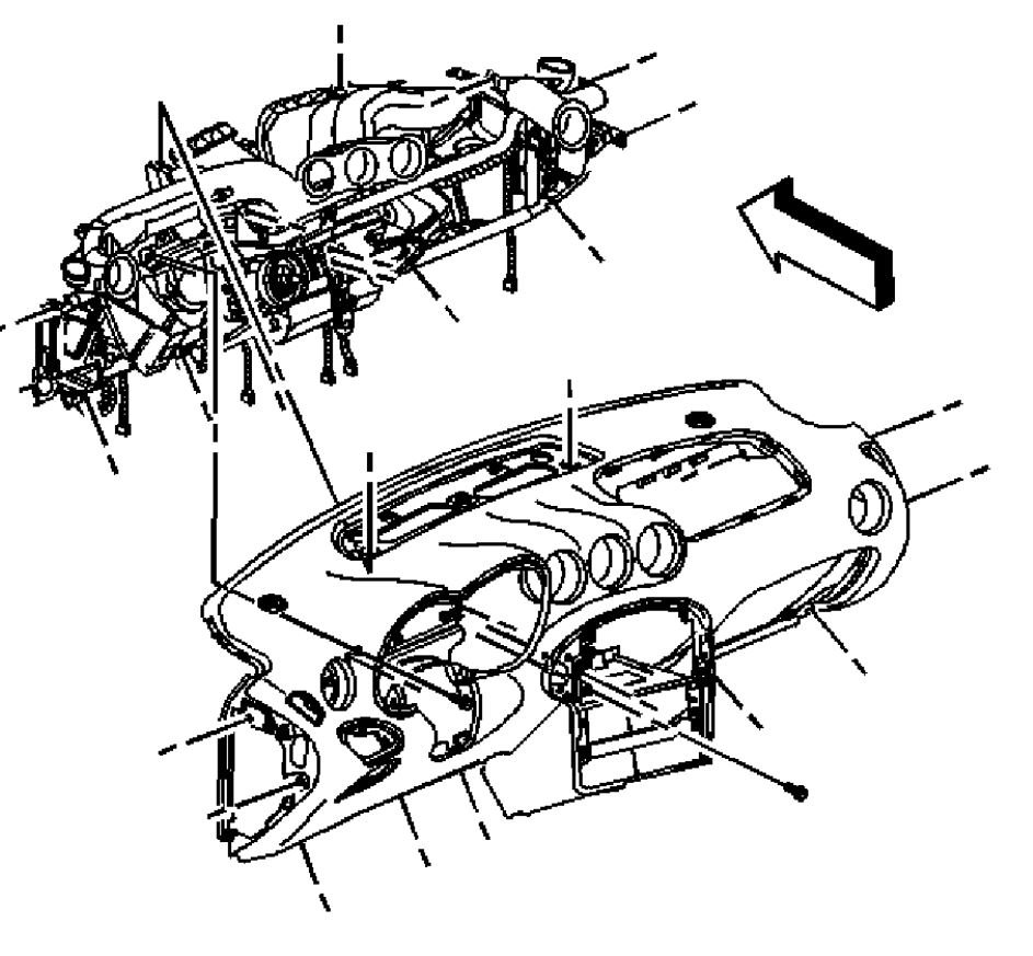

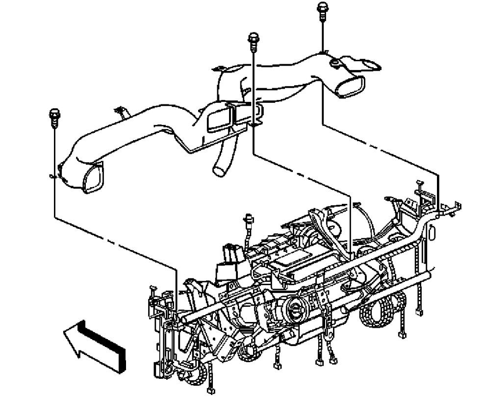

Lastly would be to go into the system manually by removing the dash trim panel and the ducting to get inside. That isn't a fun or easy job so I would probably try the other methods first. If you have no luck that way the first image it the duct you need to remove. The second is the dash pad. These are the steps for removal of the dash pad. The numbers missing apply to the other version of this car that were sold as an Oldsmobile.

7. Remove the IP insulators.
8. Remove the glove compartment.
9. Remove the passenger airbag inflator module.
10. Remove the accessory trim plate.
12. Remove the cluster trim plate.
13. Remove the gauge cluster.
14. Remove the radio.
15. Remove the HVAC control assembly.
16. Remove the steering wheel.
17. Remove the multifunction turn signal lever.
18. Remove the cup holder.
19. Remove the bracket fasteners to the floor console center support.
20. Remove the bolts from the ignition switch.
22. Remove the fog lamp switch.
23. Disconnect the outboard electrical connections from the electrical junction block.
24. Remove the screws connecting the instrument panel to the cross car beam.
25. Remove the instrument panel and pad.

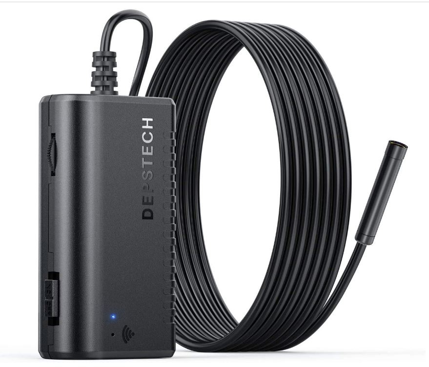

That is a good thing then, it might just be behind the vents. Those pop out and then you could get a camera in there and snag it before it gets in deeper. The camera I'm talking about looks like this. They run about $40.00 to $50.00 on eBay and Amazon. Some parts stores have them as well as loaner tools but those are usually not as flexible.

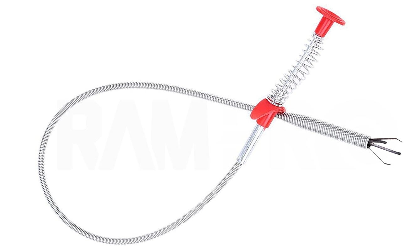

That should work to go hunting. I would pop out the airflow vanes from the dash, then use the camera to go looking. If you see it you should be able to get it out. They make claw grabbers that you can reach in with but most are somewhat like a spring, I've taken a coat hanger and attached it with tape to hold a shape with them if needed.
