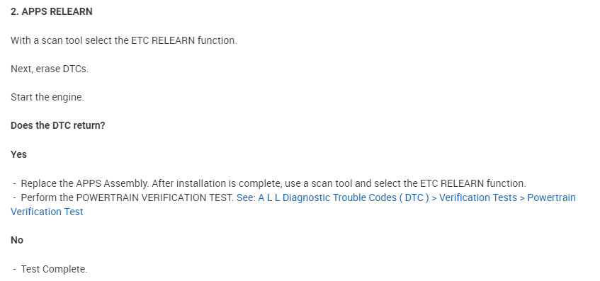

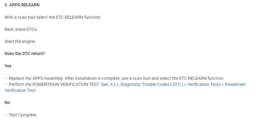

These codes are similar. I have to ask. You indicated the APP was replaced. Did they perform the relearn procedure after it was installed? That is the one thing that is indicated for each of the codes you provided. See pic below
Let me know if this was done. Also, let me know if this started as soon as the work was done or if it took a few days.
See pic below.

The relearn needs to be performed. Is this something you are comfortable performing? It will require a scan tool with the ability to communicate with the different modules and program components.
