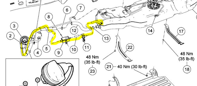

After replacing the fuel pump and filter I cannot put but about $8.00 in fuel in the tank before it auto shuts off and you have to lightly squeeze to get fuel in. Ran code reader after a check engine light and have code po443 evap emissions system purge control valve circuit.
Replace the evap pressure sensor above the tank.
Replaced the solenoid over the right rear axle.
Replaced the gas cap.
Replaced purge valve.
And the code still remains and cannot put fuel in the vehicle.

When you replaced the pump, was it only the pump or was the module replaced which contains the pump?

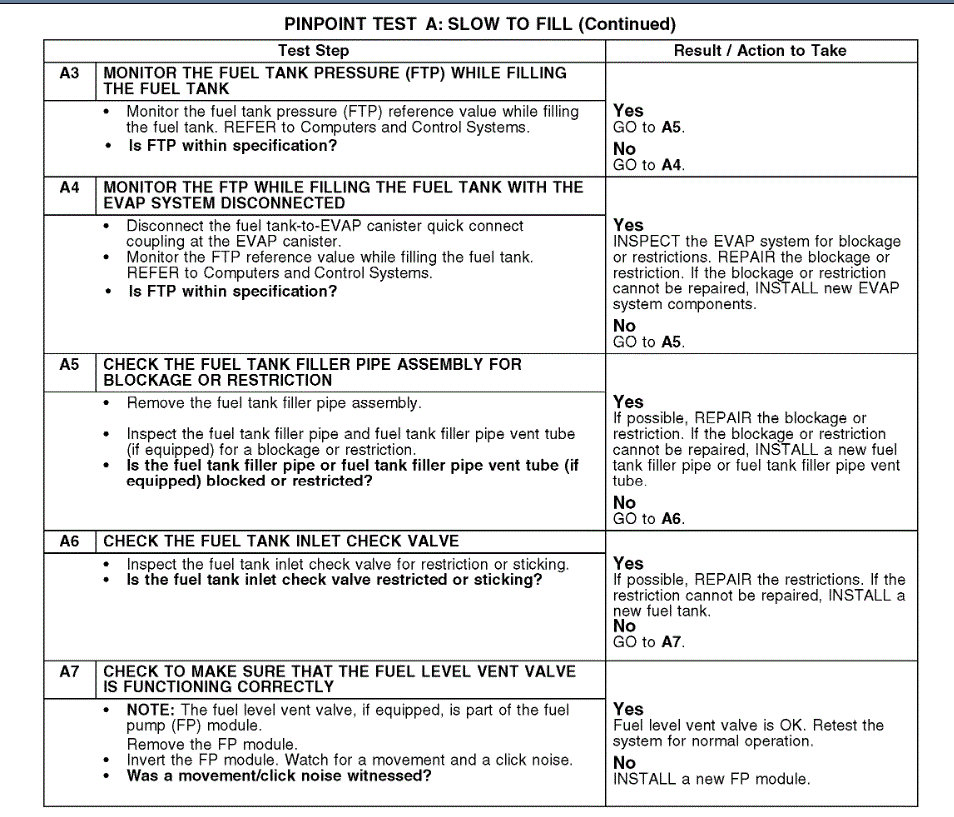

I ask because there is a vent valve before the charcoal canister which is part of the module. If the only the pump was replaced, there could be a blockage.

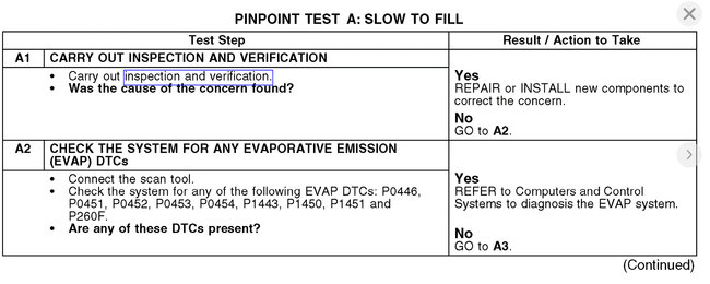

I attached the diagnostics below for the code you have. (Pics 1 and 2). Pic 3 is the one I feel is of most interest. Make sure the vent tube that is attached to the filler tube isn't damaged and where it connects isn't bent, preventing airflow.
Also, I highlighted from the fuel tank to that tube. Check for restrictions there.

Anything is possible. Disconnect the charcoal canister and see if it takes fuel. It will set a code, but it can be deleted.
If the canister does nothing, work back to the tank. Also, is there a rubber hose between the tank and the fresh air vent?

I disconnected it previously trying to find the issue if. I disconnected the line at the front of the fuel tank that leads to the cannister and it takes fuel no issue.
Jul 7, 2022 at 10:15 PM
  • 110,248 POSTS
That is where the issue is coming from. Go to the canister and see if it takes fuel. If it still doesn't, work your way back to the tank.
