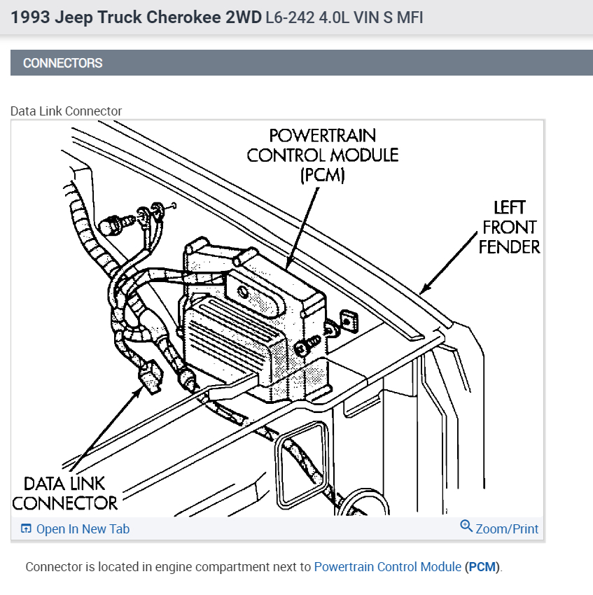

Ken L, no, the security light doesn't flash. It's lit continuously. I bought an obd1 reader but can't find the port. I've looked under the dash on the driver's side and under the hood by the ECM and all on the fire wall. Also, I know that it's "L" shaped.
May 28, 2022 at 8:39 AM
  • 55,732 POSTS
Yes, it is under the hood near the PCM here is an image of its location in the diagrams below, I have also included the code table identifications in the link below as well.
https://www.2carpros.com/articles/jeep-diagnostic-trouble-codes-for-car-built-on-or-before-1995-odb1
Check out the diagrams (below). Please let us know what you find.
