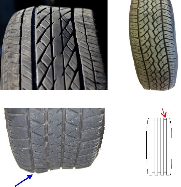

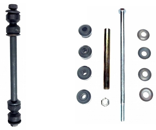

When I take off it starts to wobble or go up and down until about 25 30 mph, after that it still does it I just can't feel it as much. I did notice the inside part of the front driver side wheel was worn down to the thread/wire (only the inside part of the tire) I should mention last week I noticed the bushing that go to the front stableizer bars were either completely gone or just pieces left of them. So I went done to O'Riley auto parts and asked the gentleman there, gave him the info he needed and gave me the part. Would that have anything to do with it ??
Thank you very much, I'll be looking forward to your answer. Is it something I can fix myself or do I need to take it to a mechanic??

You're describing a number of issues that must be addressed. First of all, if the part you're describing is the anti-sway-bar link shown in the first photo, that is not involved with this problem. It is part of a system that simply reduces how much the body leans, or "rolls" during a high-speed turn. It doesn't affect tire wear.
The wobble sounds like it is due to a broken belt in the left front tire. Be careful when running your hands over that area. There will usually be the very sharp and painful ends of the wires of the steel belt poking out. Those really smart when they poke you.
Two of the three main alignment angles affect tire wear on the inside edge. "Toe" is the direction each wheel is steering. It affects both tires, even when just one of them is out of adjustment. "Camber" affects only that one tire, although camber can be out of specs on both wheels at the same time. That is the inward or outward tilt of the wheel as viewed from in front or in back of the vehicle. A wheel that's tipped in too much on top will wear that tire on the inside edge. Camber also affects a pull to one side. Besides being in specs for good tire wear, the two values must be nearly the same on both sides so their pulls offset each other.
When the tread is worn down to the cords, it is fairly common for that tire to develop a broken belt. In my experience, this has been especially common with Goodyear tires, even when the wear patterns are acceptable, but the tire is just worn out. The first step in identifying this is to observe the steering wheel oscillating back and forth as you drive very slowly through a parking lot. You may also see one front corner of the vehicle rise and fall once per tire revolution.
Next is to raise the front of the vehicle off the ground, support it with jack stands, then spin those wheels by hand while watching the tread. You'll see and / or feel the high spot in one area. When it's real bad, the tread will squirm left and right as it goes around.
There is a different type of broken belt that is much more elusive because at first glance, no hump or bulge is seen in the tread. It takes a trained eye to find those.

The second photo shows broken belts better than I can describe them. The blue arrow at the bottom is pointing a hump, or "tumor" that is the most common type of failure. That hump is in just one spot on the tire, not all the way around, and is almost always on the edge of thread. When the break in the belt is closer to the center of the tread, it tends to cause the squirming or snaking pattern shown in the upper right.
