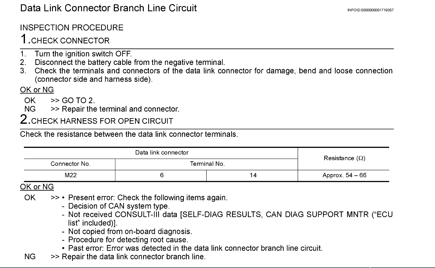

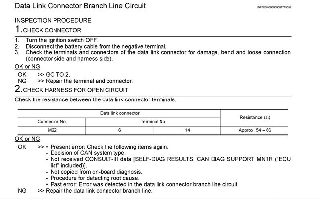

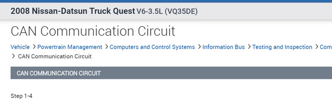

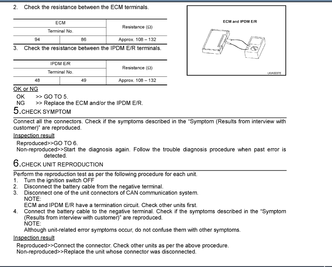

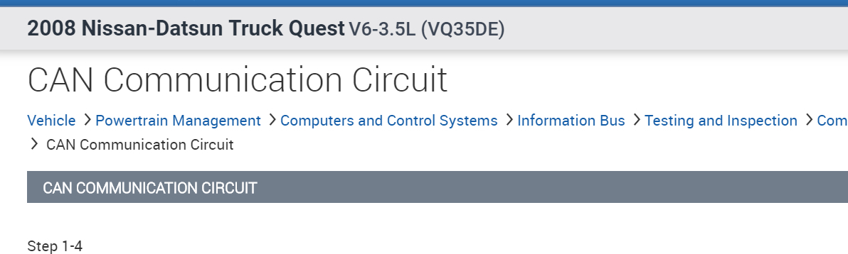

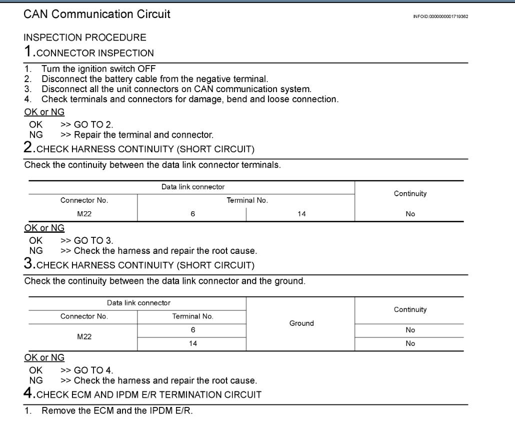

No communication between scan tool and computer.
Jul 4, 2019 at 6:12 AM
SCGRANTURISMO
  • 4,897 POSTS
This sounds like your vehicle could have a problem with it's Controller Area Network (CAN). In the diagrams down below I have included the factory diagnostic troubleshooting guide for your vehicle's CAN system. Please go through this guide and get back to us with what you are able to find out.
