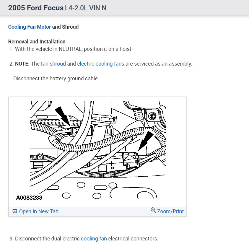

Whenever we turn on the A/C the vehicle starts vibrating in the front engine and makes a loud noise. The radiator fans would start to vibrate like crazy and then after a while they would calm down again. I took a look and noticed one of the fans was broken, but I was not sure if that would cause all the vibrations and noise. The engine mounts, transmission mounts, and serpentine belts were recently replaced.
May 24, 2023 at 10:28 AM
  • 55,456 POSTS

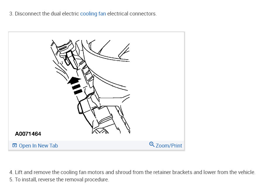

Yes, the fan blade being broken will make the noise and vibration, here is how you can change it out. This guide can help, and I have included the instructions for your car in the images below.
https://www.2carpros.com/articles/replace-electric-fan-motor
