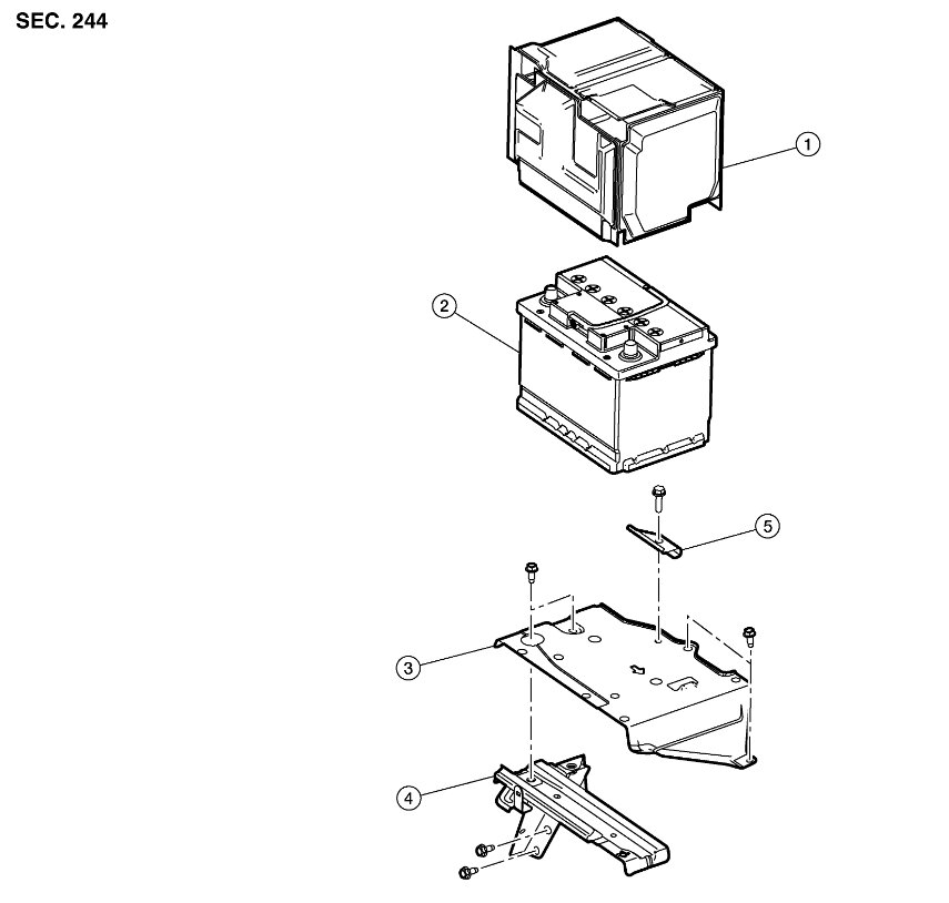

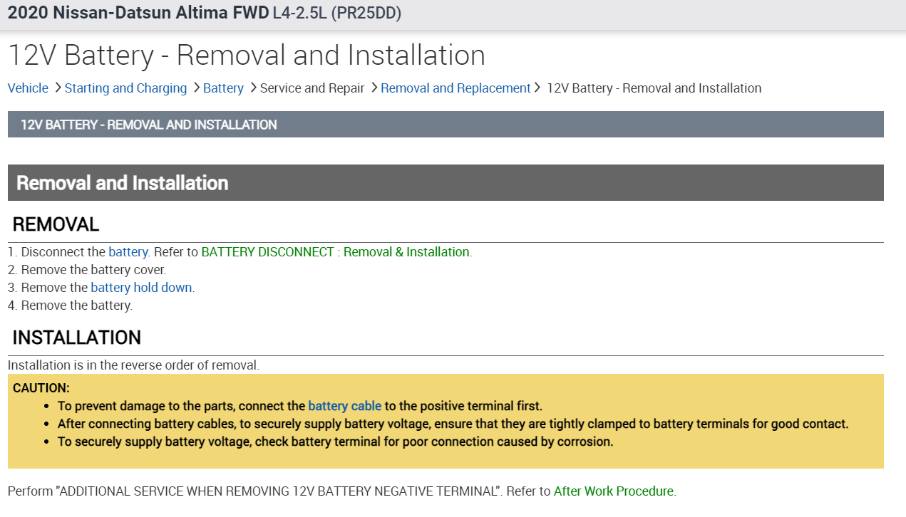

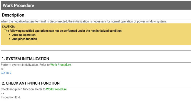

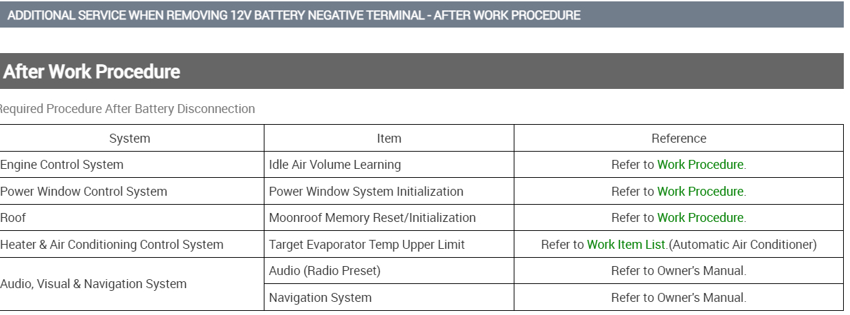

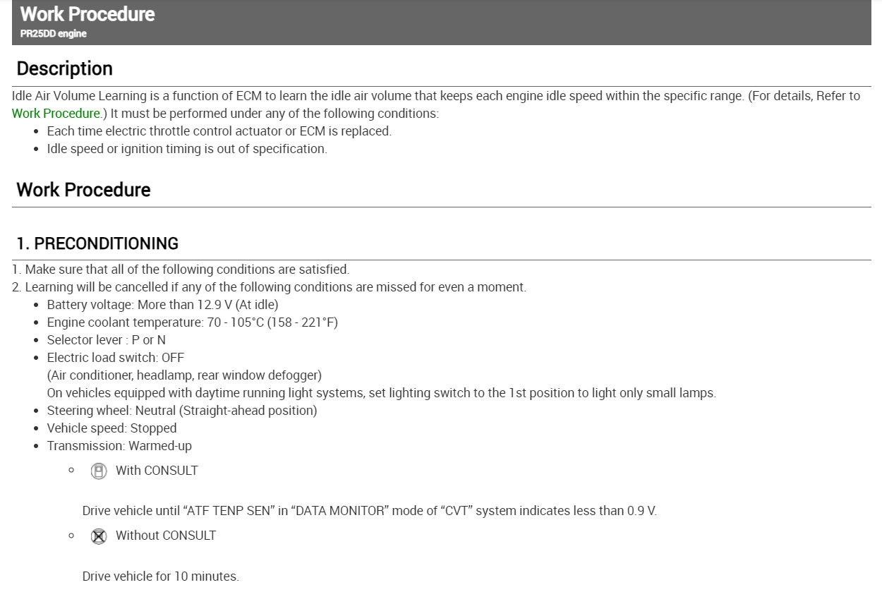

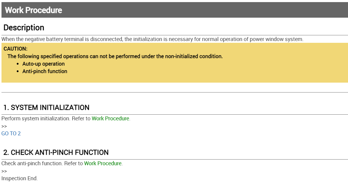

Yes, the battery sounds bad. To be sure this guide can help us:
If it fails, here is how to change the battery out. Here is a generic guide to help you step by step with instructions in the diagrams below to show you how on your car:
https://www.2carpros.com/articles/how-to-replace-a-car-battery
Check out the images (below). Please let us know how it goes.
