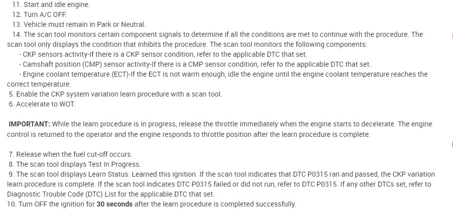

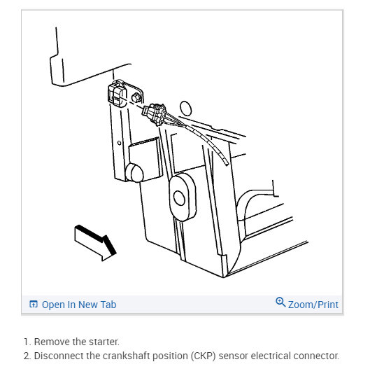

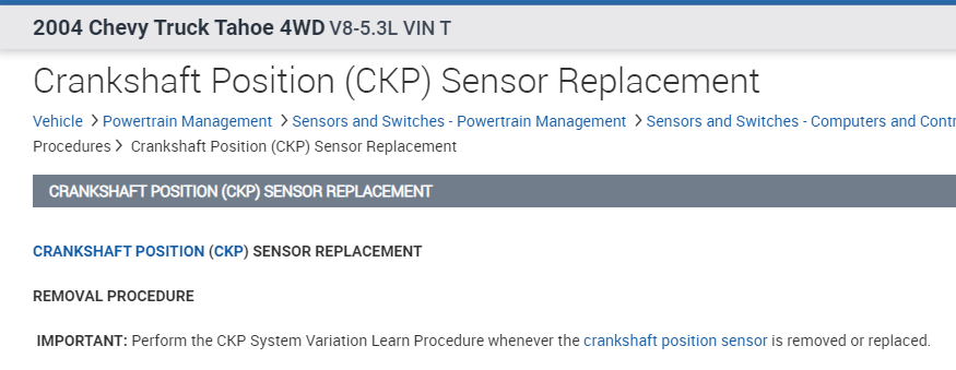

Oftentimes, it is related to a failed crankshaft position sensor (CKP) when spark is lost. If you have a live data scanner, see if there is an RPM signal when cranking it. If you don't have one, see if the tachometer moves a little when cranking.
Also, take a look through this link. See if anything mirrors what you are experiencing.

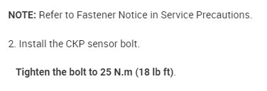

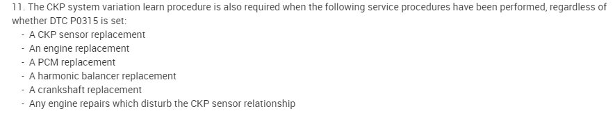

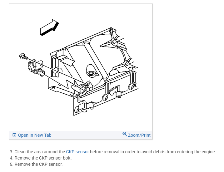

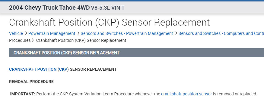

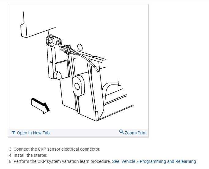

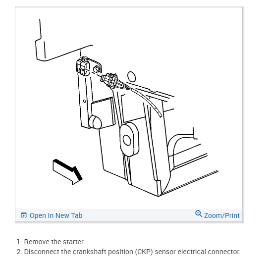

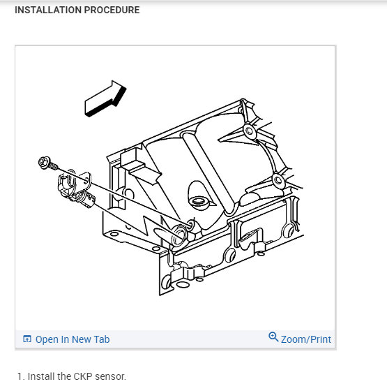

On this vehicle, the CKP is located behind the starter motor, so you will need to remove it if you replace it. If you look below, I attached the directions for replacing it.
Let me know what you find or if you have questions,

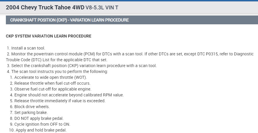

See pics below. Note: The last three pics are the variation relearn procedures.
