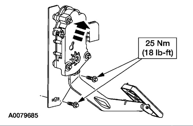

When at a stop, I push on the accelerator vehicle shuts off. Most of the time it is starts right up but as soon as I push on the accelerator it shuts off. It will do this several times then finally it will catch and I will be able to drive off, but as soon as I come to the next stop it will shut off as soon as I push the accelerator again and it continually does this. The p2106 code shows it is a throttle actuator control system failure. I replace the whole system throttle body and all still having the same problem. please any input or ideas. thank you

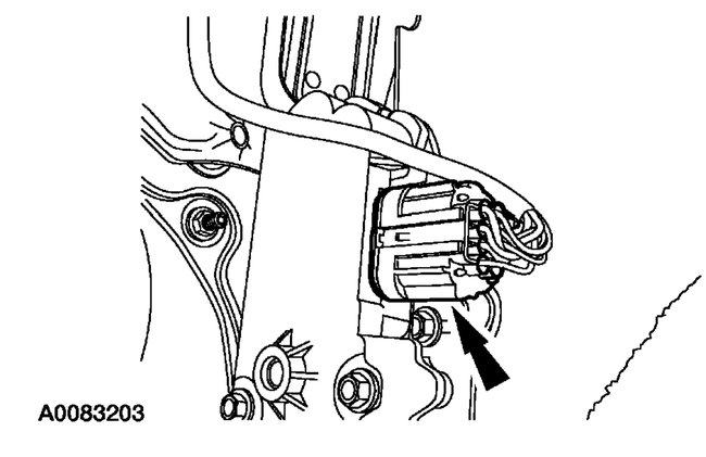

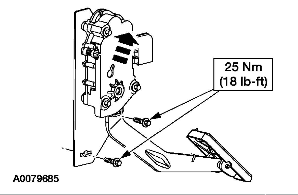

I attached the procedure for you of the replacement of the sensor.
It is a plug and play, no programming required.
ACCELERATOR PEDAL
Removal and Installation
CAUTION: The accelerator pedal and sensor assembly is a non-adjustable, calibrated unit and must be handled with care.
1. NOTE: The red clip must be pulled out before disconnecting the electrical connector.
Disconnect the accelerator pedal position sensor electrical connector.
2. Remove the two bolts and slide the accelerator pedal and sensor assembly up and off the anchor bolt.
3. To install, reverse the removal procedure.
