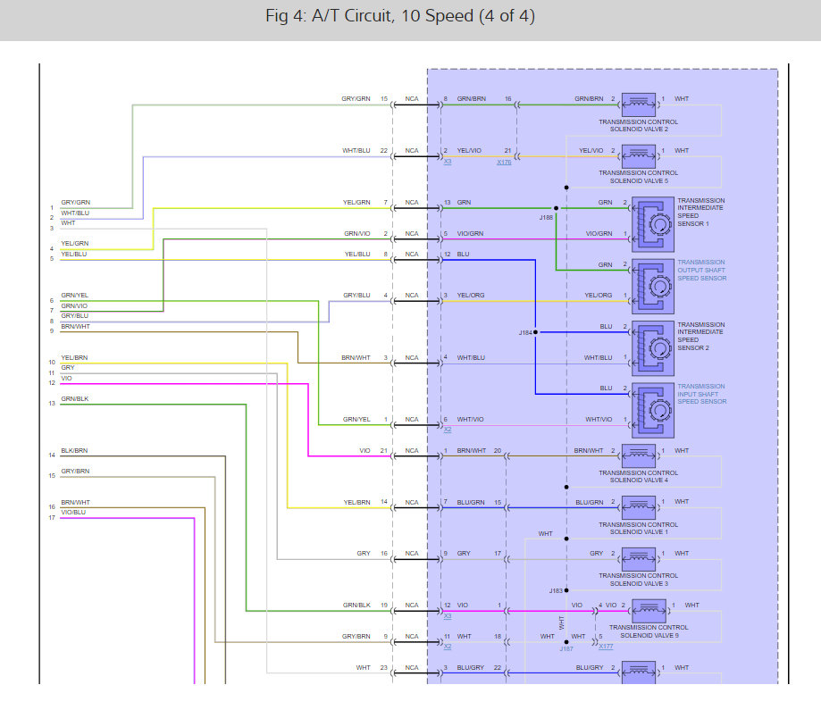

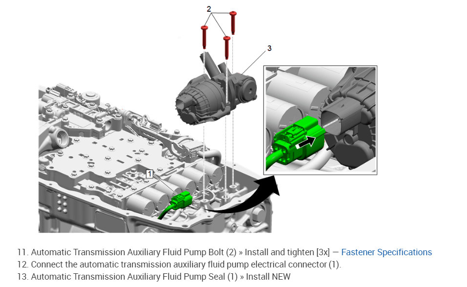

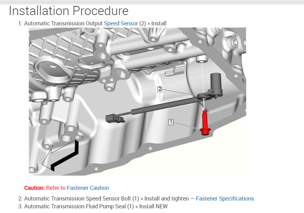

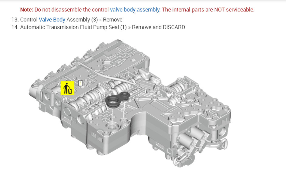

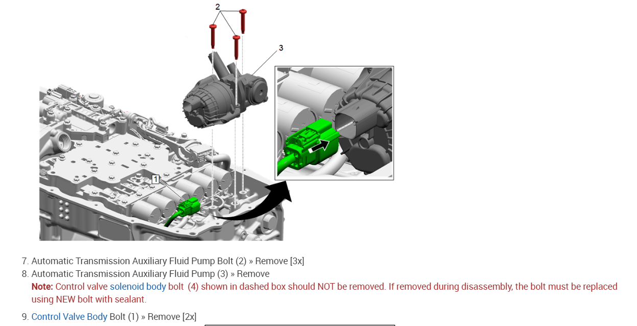

Trying to locate wire colors for VSS on the truck listed above with a 10-speed automatic transmission. Fleet truck. Need to install an electronic footage meter. Apparently on the 2022 there is no external VSS.
I have been installing this meter on Chevrolet trucks going back to 1999. The last truck was a 2017 Silverado K1500. VSS was on tail shaft of transmission output. If you could tell me the colors for the VSS wires at the transmission plug/loom, I would greatly appreciate it.
Aug 17, 2022 at 5:46 AM
  • 55,399 POSTS

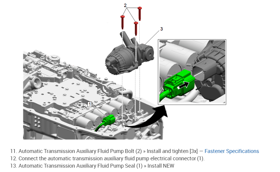

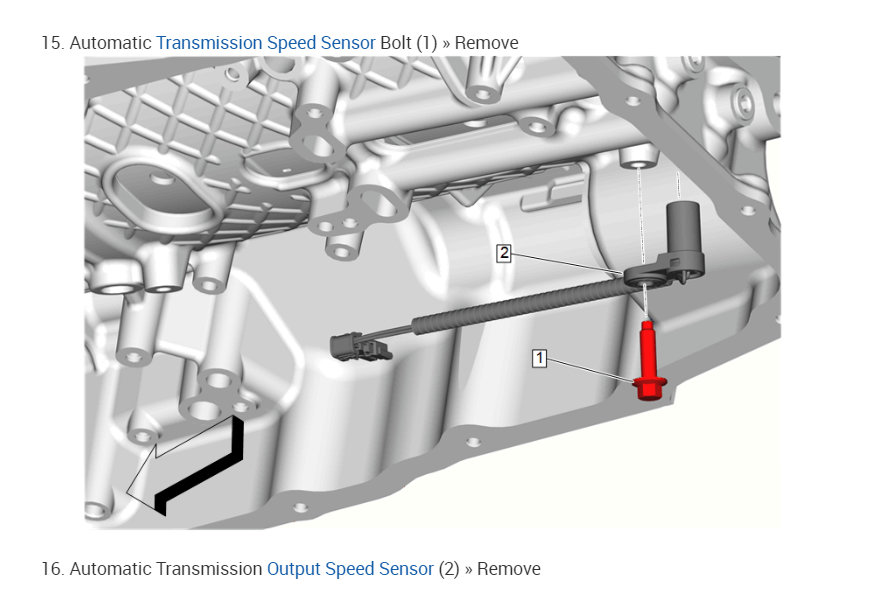

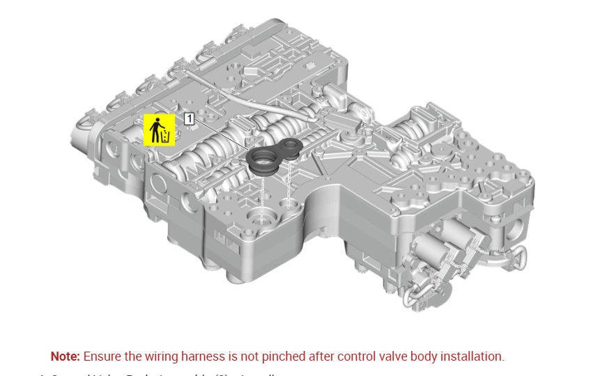

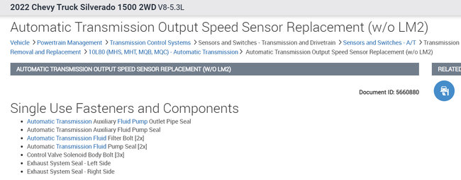

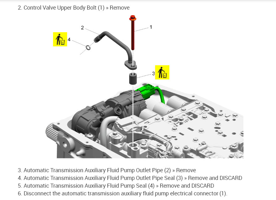

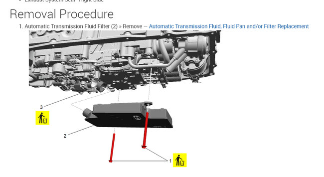

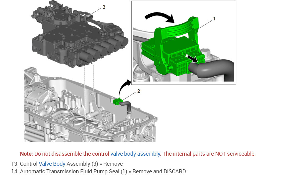

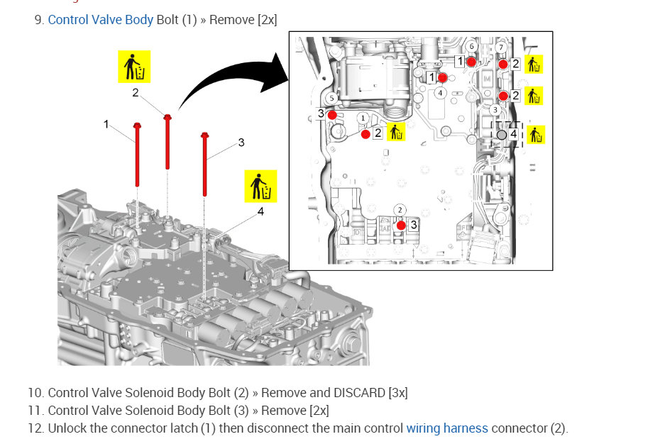

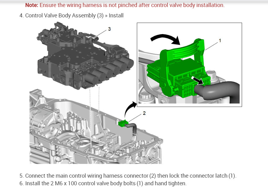

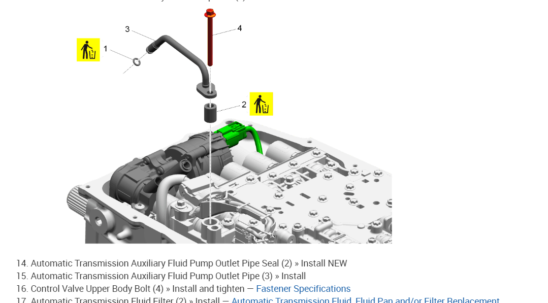

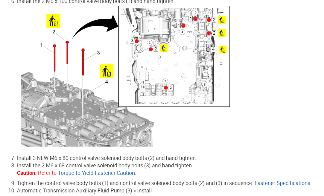

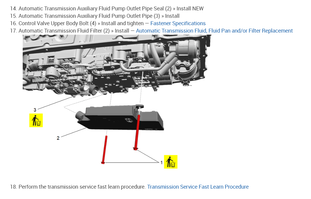

It looks like the VSS is internal and the color of the wires for the sensor are GRY/BLU and YEL/GRN here is the wiring for it in the images below, also I have found how to replace the VSS which shows the location as well. Check out the images below.
