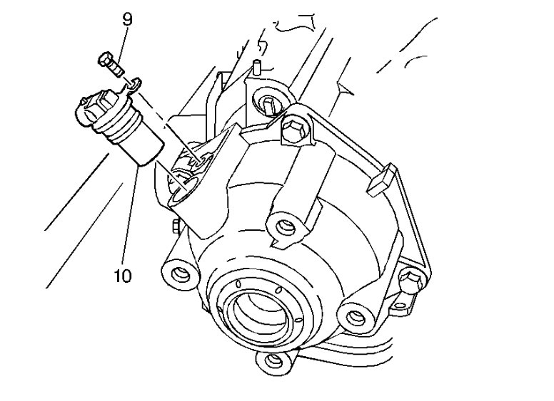

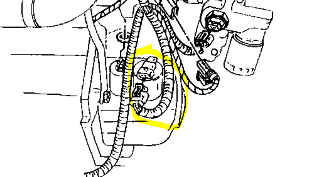

I was stuck in the snow and I turned off my traction to spin wheels and now my car doesn’t shift right, runs really rough. my check engine light came on for vehicle speed sensor. it was running fine before this. I can’t seem to find where the VSS is located on my car. Please help!

The code came up for vehicle speed sensor and I cant find it on the car.
Feb 17, 2019 at 6:53 PM
Again, what is the code number? I need the number as there are several codes for this sensor.
The sensor is under the car where the right front axle comes out of the transmission.
