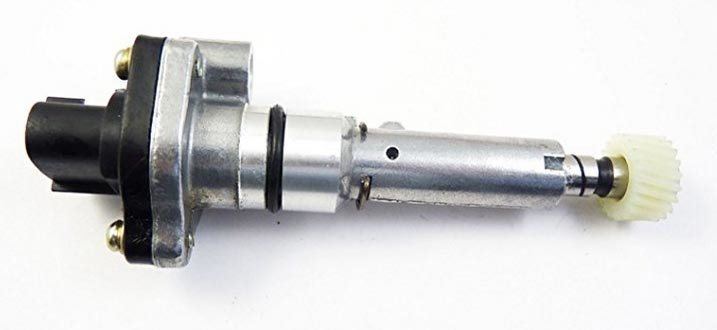

The uploaded image is just an example I found online of what my VSS looks like.

This component is known to fail regularly. Referring to the picture that you posted, at the right is the fiber gear. Different models might have different number of teeth and the diameter could be different so it could work on one vehicle but not the next. You need to confirm if both have the same number of driven tooth (with the one that you borrowed from your wife's vehicle). If both are the same, did you try using the unit from your vehicle on your wife's vehicle?
Did you check for abnormal wear of the fiber teeth? The fiber gears do get damaged at times.
This component can also be erratic in the sense that it can work well for a while and then fails intermittently.

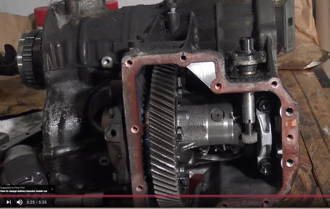

The attached image is from a video I found online that shows the same speed sensor and cover removed from the A140E transmission.
Thanks for any feedback,
DIY-GUY

Yes, the picture shows the correct thing and if you can get the cover removed, you might be able to see what is wrong. Too bad I don't think it can be done om vehicle meaning you need to remove the transmission from vehicle to work on. At the point where the fiber gear of the VSS is, the driving gear is located there.
