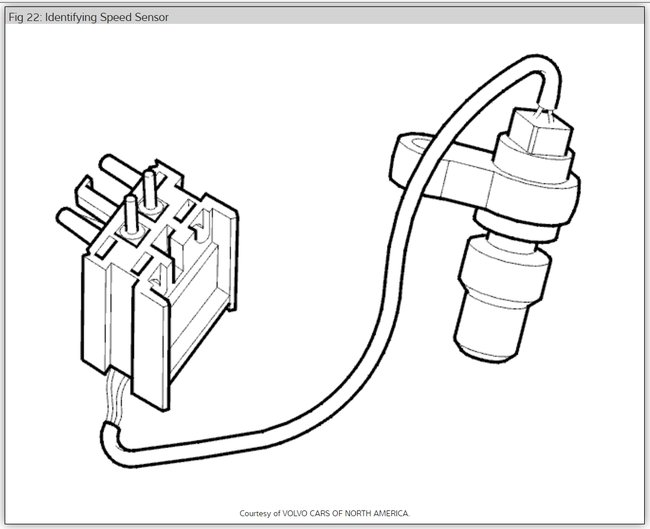

Hey Tabletalk,
The transmission speed signal is transmitted by a sensor on the transmission. The transmission control module (TCM) uses the signal to determine the input shaft speed after the torque converter. This signal is used to compare the transmission speed and vehicle speed. The transmission control module (TCM) uses this comparison to calculate gear-shift timing. Engine speed (RPM) and vehicle speed data affects the adjustment of system pressure, lock-up function control and engine torque reduction. The result is smooth gear-shifting. The control module calculates and compares the transmission speed, engine speed (RPM) and speed at the transmission. Diagnostic trouble code (DTC) TCM-0023 is stored if the control module registers that the speed (RPM) signal is missing.
Here is a picture of what it looks like.
Please let us know happens so it will help others.
Best, Ken

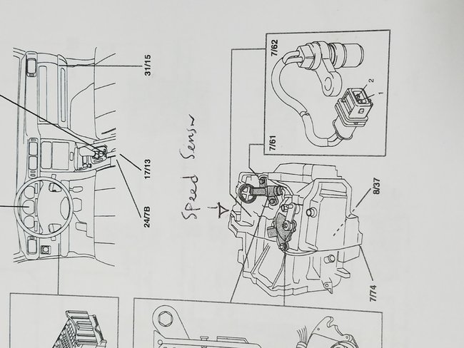

Sorry responding so late. The speed sensor is on top of the transmission. Remove the plastic hose at the air cleaner. The plastic is going to be hard so warm it up using a heat gun just to soften it. To install you will need to do the same.
Once the hose is off the sensor will be on top of transmission. There are 2. Attached image location. Verify it is the correct one by wire color. Wire colors will be green with brown stripe and the other green with ahite stripe. That will be the sensor to replace.
Let us know how it goes and good luck.
