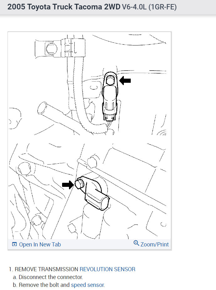

I need to know where my vehicle speed sensor is located on my 2005 Toyota Tacoma Prerunner?

It looks like the VSS or vehicle speed sensor is near the revolution sensor. Here is the location in the images below.

I don't know where that is on the truck itself?

on the transmission either on left side, use a flashlight and look under it and you should see an electrical connector there on the sensor

Thank you I found it.
