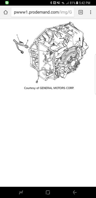

How to repair it and how easy or hard it is to be installed?

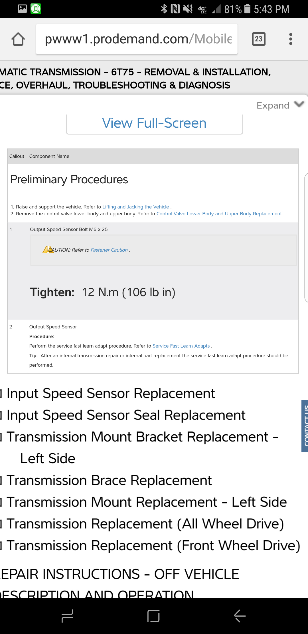

Looks like you have to remove the valve body so I would say it is a more difficult job. Plus you have to use a scan tool after replacing it and perform and fast adaptive relearn.

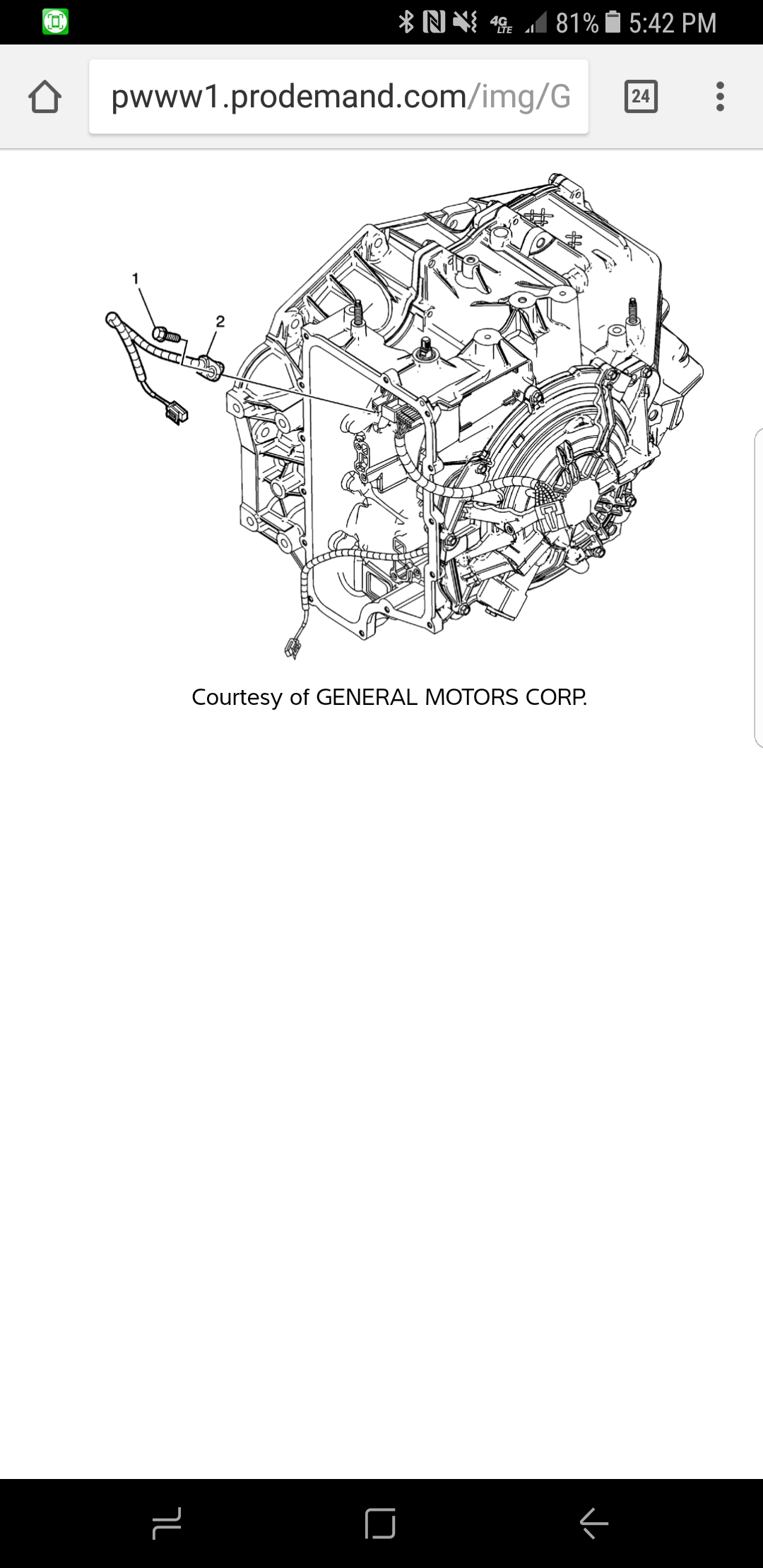

Here is some information on it.
