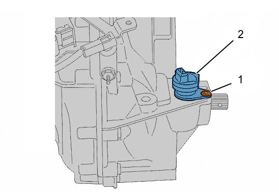

Can you help me locate the vehicle speed sensor?

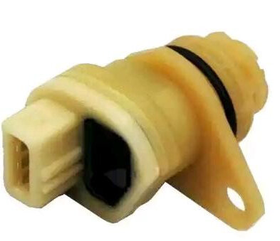

The vehicle speed sensor is located on the transmission housing, see item 2 on image.
I suggest checking the 3-pin connector, ensuring it is fitted correctly and that there are no broken wires or corrosion.
Cheers, Boris
Jun 4, 2024 at 3:13 AM
PRINZKENNY
I just checked, I can't locate the VSS on the 307 gearbox. Its rather the 206 the has the VSS fitted on the gearbox.
