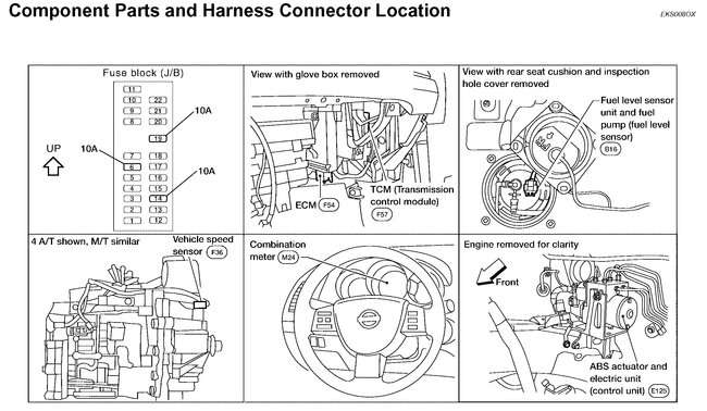

I need to know where the vehicle speed sensor is located
2005 NISSAN ALTIMA
2,176 MILES • 3.5L • V6 • 2WD • AUTOMATIC
STEFF1984
I need to know where the vehicle speed sensor is located. I am trying to change it and cannot locate it.
Sep 13, 2018 at 6:28 PM
  • 110,194 POSTS
I have attached a picture of its location. The image on the bottom left of the picture indicates its location.
Let me know if this helps.
