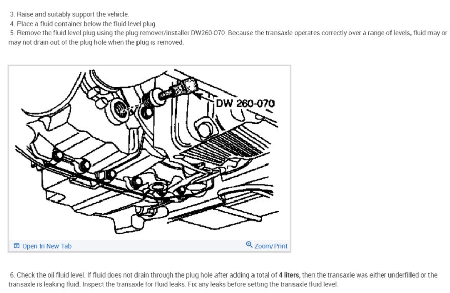

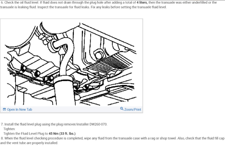

This CVT does not have a traditional 'dipstick' to check the transmission fluid.
There is a check and fill plug on the side of the transmission. To access that plug you will have to lift the car on a jack/lift then use a special tool to undo the plug and check the level. Usually the fluid should be just below the level of the plug. You should be able to put you finger inside and be able to tell the level.
I have attached diagrams to give you a little better idea.
Let me know if you have any questions.

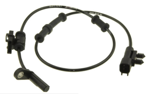

Do you know what the C112 FR RH In ABS SOL error code is? And how to fix it?

That C112 code typically points to wheel speed/abs sensor. If you had issue with the CV shaft it can happen or it could be simply for a faulty sensor. Check the sensor on the front right side wheel. Make sure it is connected properly and does not have any damage or loose wires.

Also, did check the right side speed sensor and did not see any issues. Just removed the sensor which appeared to be okay with some metal flakes on the front of the magnet that I wiped away but could not visually see any damage to the wiring. Would be good if I had a multimeter to check it as well.

The wheel speed sensor picks up the rotation of the CV axle, which is driven by the transmission. Good chances that the code got triggered when the sensor read different than the output sensor on the transmission.
