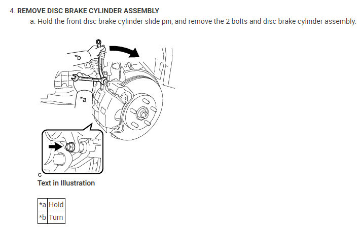

REMOVE DISC BRAKE CYLINDER ASSEMBLY
Hold the front disc brake cylinder slide pin, and remove the 2 bolts and disc brake cylinder assembly.
Pic 2

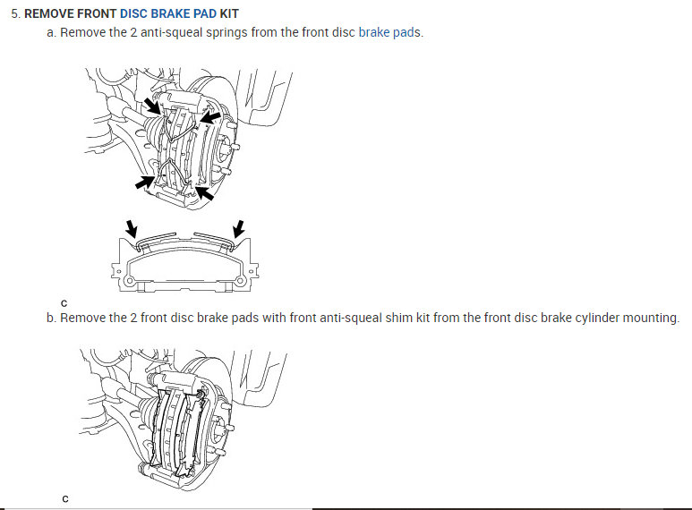

REMOVE FRONT DISC BRAKE PAD KIT
Remove the 2 anti-squeal springs from the front disc brake pads.
Pic 3
Remove the 2 front disc brake pads with front anti-squeal shim kit from the front disc brake cylinder mounting.
Pic 4

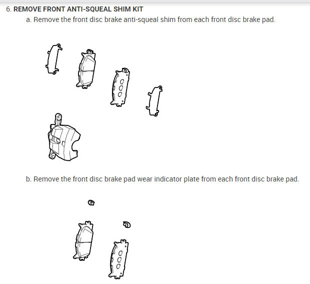

REMOVE FRONT ANTI-SQUEAL SHIM KIT
Remove the front disc brake anti-squeal shim from each front disc brake pad.
Pic 5
Remove the front disc brake pad wear indicator plate from each front disc brake pad.
Pic 6

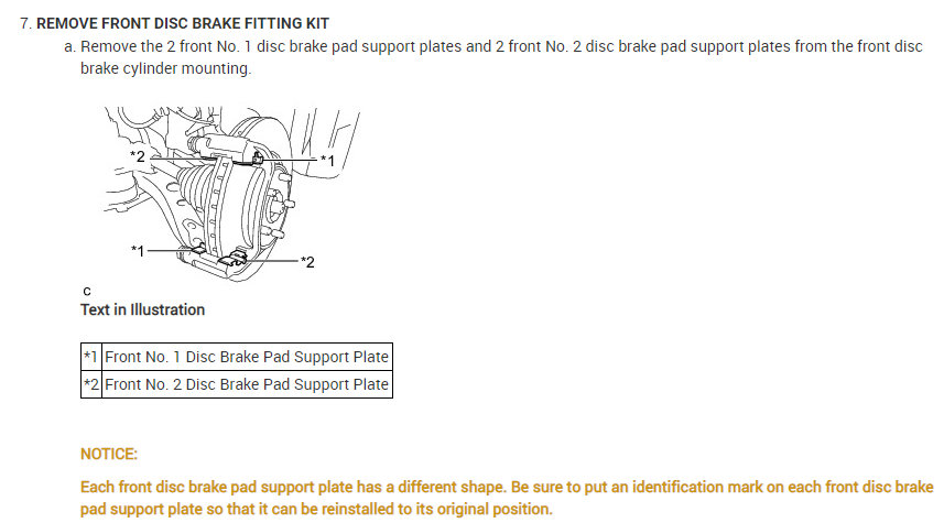

REMOVE FRONT DISC BRAKE FITTING KIT
Remove the 2 front No. 1 disc brake pad support plates and 2 front No. 2 disc brake pad support plates from the front disc brake cylinder mounting.
Pic 7
Text in Illustration
*1 Front No. 1 Disc Brake Pad Support Plate
*2 Front No. 2 Disc Brake Pad Support Plate
NOTICE:
Each front disc brake pad support plate has a different shape. Be sure to put an identification mark on each front disc brake pad support plate so that it can be reinstalled to its original position.

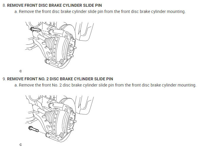

REMOVE FRONT DISC BRAKE CYLINDER SLIDE PIN
Remove the front disc brake cylinder slide pin from the front disc brake cylinder mounting.
Pic 8
REMOVE FRONT NO. 2 DISC BRAKE CYLINDER SLIDE PIN
Remove the front No. 2 disc brake cylinder slide pin from the front disc brake cylinder mounting.
Pic 9

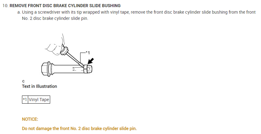

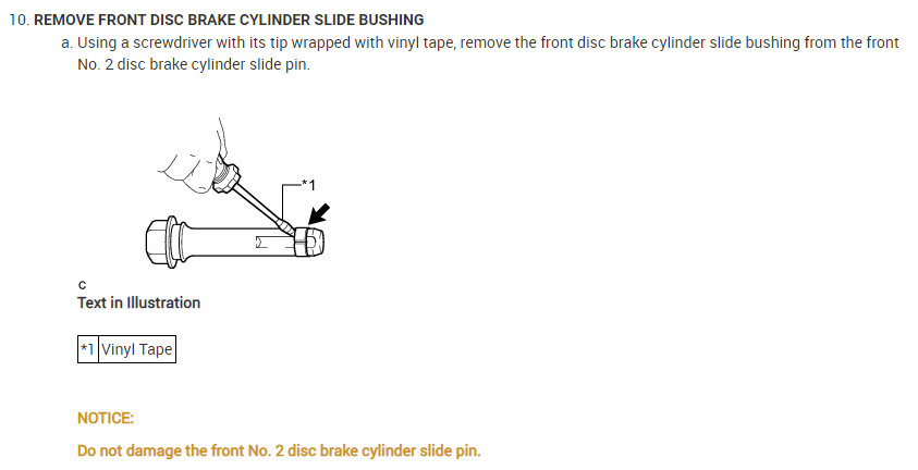

REMOVE FRONT DISC BRAKE CYLINDER SLIDE BUSHING
Using a screwdriver with its tip wrapped with vinyl tape, remove the front disc brake cylinder slide bushing from the front No. 2 disc brake cylinder slide pin.
Pic 10
NOTICE:
Do not damage the front No. 2 disc brake cylinder slide pin.

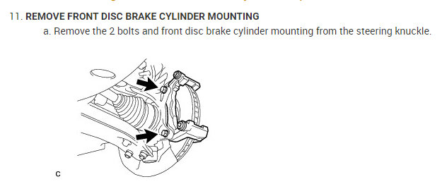

REMOVE FRONT DISC BRAKE CYLINDER MOUNTING
Remove the 2 bolts and front disc brake cylinder mounting from the steering knuckle.
Pic 11

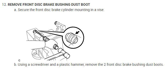

REMOVE FRONT DISC BRAKE BUSHING DUST BOOT
Secure the front disc brake cylinder mounting in a vise.
Pic 12
Using a screwdriver and a plastic hammer, remove the 2 front disc brake bushing dust boots.

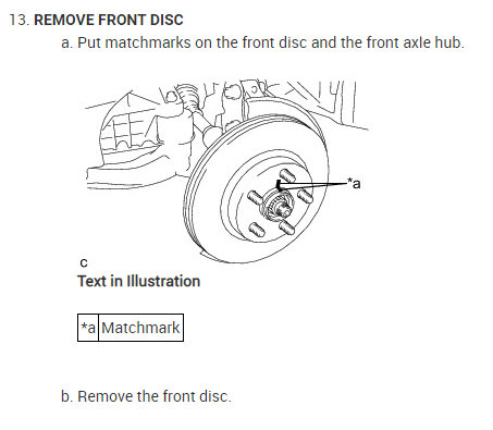

REMOVE FRONT DISC
Put matchmarks on the front disc and the front axle hub.
Pic 13
Remove the front disc.

INSTALL FRONT DISC
Align the matchmarks of the front disc and front axle hub, and install the front disc.
pic 14
NOTICE:
When replacing the front disc with a new one, select the installation position where the front disc has minimal runout.
INSTALL FRONT DISC BRAKE BUSHING DUST BOOT
Apply a light layer of lithium soap base glycol grease to the entire circumference of 2 new front disc brake bushing dust boots.
Pic 15
Pic 16
Lithium Soap Base Glycol Grease
HINT:
Apply at least 0.3 g (0.01 oz.) of lithium soap base glycol grease to each front disc brake bushing dust boot.
Using a socket wrench (19 mm) and a hammer, install the 2 front disc brake bushing dust boots to the front disc brake cylinder mounting.

INSTALL FRONT DISC BRAKE CYLINDER SLIDE BUSHING
Apply a light layer of lithium soap base glycol grease to the contact surface of the No. 2 front disc brake cylinder slide pin.
pic 19
pic 20
Install a new front disc brake cylinder slide bushing to the front No. 2 disc brake cylinder slide pin.
INSTALL FRONT NO. 2 DISC BRAKE CYLINDER SLIDE PIN
Apply a light layer of lithium soap base glycol grease to the sliding part and the sealing surfaces of the front No. 2 disc brake cylinder slide pin.
Pic 21
pic 22
Install the front No. 2 disc brake cylinder slide pin to the front disc brake cylinder mounting.
Pic 23
Push the front No. 2 disc brake cylinder slide pin into the front disc brake bushing dust boot to engage the pin to the boot.
INSTALL FRONT DISC BRAKE CYLINDER SLIDE PIN
Apply a light layer of lithium soap base glycol grease to the sliding part and the sealing surfaces of the front disc brake cylinder slide pin.
pic 24
Pic 25
Install the front disc brake cylinder slide pin to the front disc brake cylinder mounting.
pic 26
Push the front disc brake cylinder slide pin into the front disc brake bushing dust boot to engage the pin to the boot.

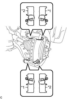

INSTALL FRONT DISC BRAKE FITTING KIT
Install the 2 front No. 1 disc brake pad support plates and 2 front No. 2 disc brake pad support plates to the front disc brake cylinder mounting.
pic 27
NOTICE:
Be sure to install each front disc brake pad support plate in the correct position and direction.
