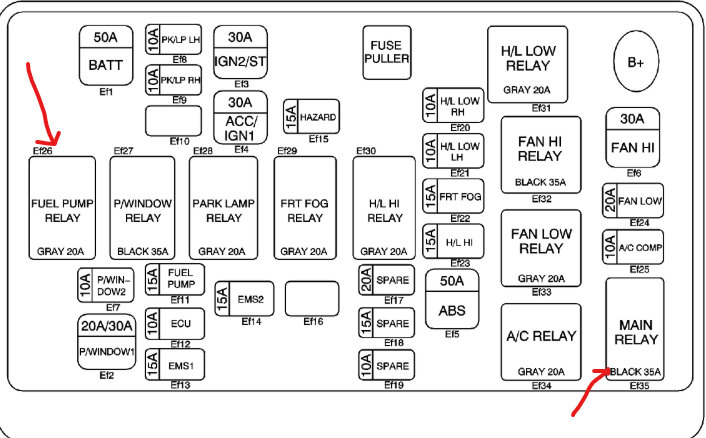

Thank you, it sounds like the battery might be okay but you should have it load tested incase it is bad. the P2A01 - O2 Sensor Circuit Range/Performance Bank 1 Sensor 2 will no make the engine stall. So we are the base steps, when it does idle is the engine running smooth? if not you can have a vacuum leak, if not the problem can be the MAP or crankshaft position sensor, I have seen the ignition switch cause this as well along with the main and fuel pump relay. Lets start with the easy stuff, when you have driven the car for a while check the fuel pump and main relays to see if there are warm or hot. Here are the locations. Check out the images (below). Please let us know what happens.

The main relays are warm, not hot, same as the others in the compartment.

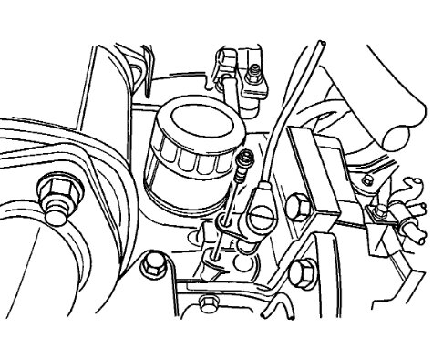

Yep, these is the toughest problem in car repair, with no codes we can go over the most popular items that will cause this, we will start with the easier stuff first, let stat with the crankshaft angle sensor which is by the oil filter and will no leave a code when it fails. Check out the images (below). Please let us know what happens.

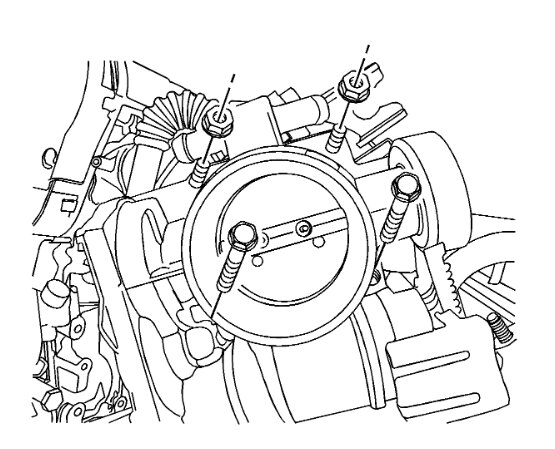

I would try servicing the throttle body first, please go over this guide which will show you how and I have included the location for you car in the images below.

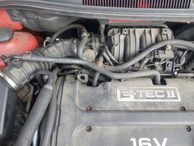

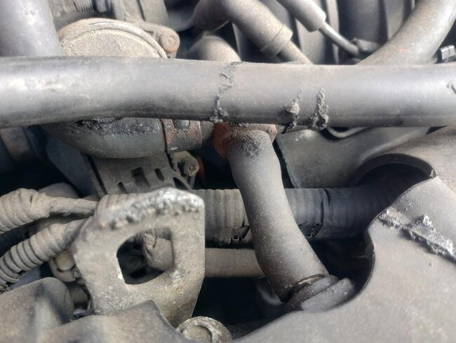

It's been a while since I've contacted you about the issue with my car, life gets busy!
My car went into what is called "limp mode." The check engine light came on, I had it checked and the codes were P161B, P2106, and P2110. I looked up the codes on the internet and the problem looks quite serious. After shutting off the vehicle for a while, it reset and runs normally for now.
Is there anything I can do to fix this or have a professional shop look at it?
I've also added some pictures to this email.
Thanks, Roosevelt
May 24, 2026 at 3:14 PM
  • 55,770 POSTS
No worries, thanks for the images, I would go back and replace the relays and crankshaft sensor, like I say this kind of problem is tough to fix. Codes P2106 and P2110 are “reduced power/limited RPM” codes. In plain English, the computer saw something it didn’t like in the throttle control system, so it intentionally limited engine power to protect the vehicle. P161B can set when the ECM sees engine output/airflow not matching the expected throttle command. So the throttle body might be bad which can happen after a service. Lets inspect the MAP sensor as well, they can get clogged and cause this problem.

These relays, check out the images (below). Please let me know what happens.
